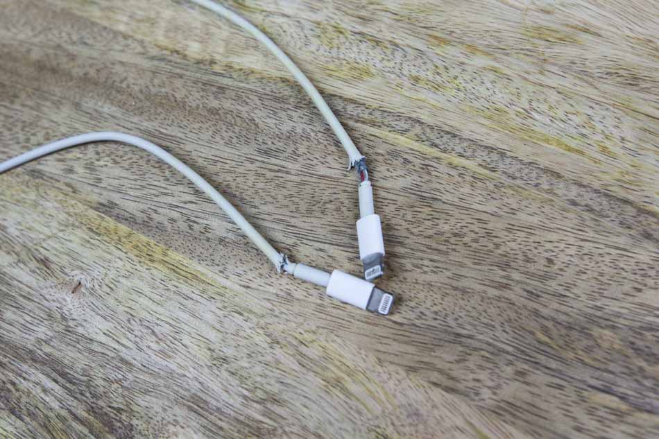

You reach over to plug in your phone, and you feel that spark — and not in a metaphorical “I love this product!” kind of way. The wire’s insulation is cracked, and yet another charging cable is about to make its way to a landfill. And you have to make a midnight run to the store to be ready for your 6 a.m. conference call with Japan. So, what’s the cause of your consternation? Repeated use has strained the cord.
Strain is defined as the change in length, divided by the original length of a specimen under stress. Going back to our charging cord example, let’s say that the cord was originally 10 inches, and it stretched a total of 0.025 inches. That means our strain was 0.0025 in/in.

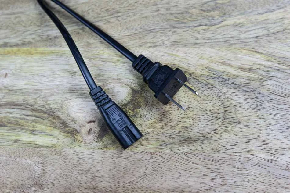

For any electrical cable, multiply the overall diameter of the cable by eight, and use that as your minimum bend radius. Of course, there are exceptions for shielded cables and multi-core shields, but this basic rule is accepted by the National Electric Code and gets you the relief you need without adding the cable’s stress to your own.

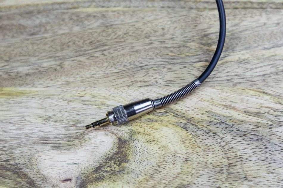

Older designs use a metal spring surrounding the cable at the cable-connector junction. It’s a simple and effective method, but you need to make certain that the bend radius will be large enough when the cable is subjected to common pulling forces. One of the great things about this design is its classic look, which makes it a great option for cables in high-end consumer designs.

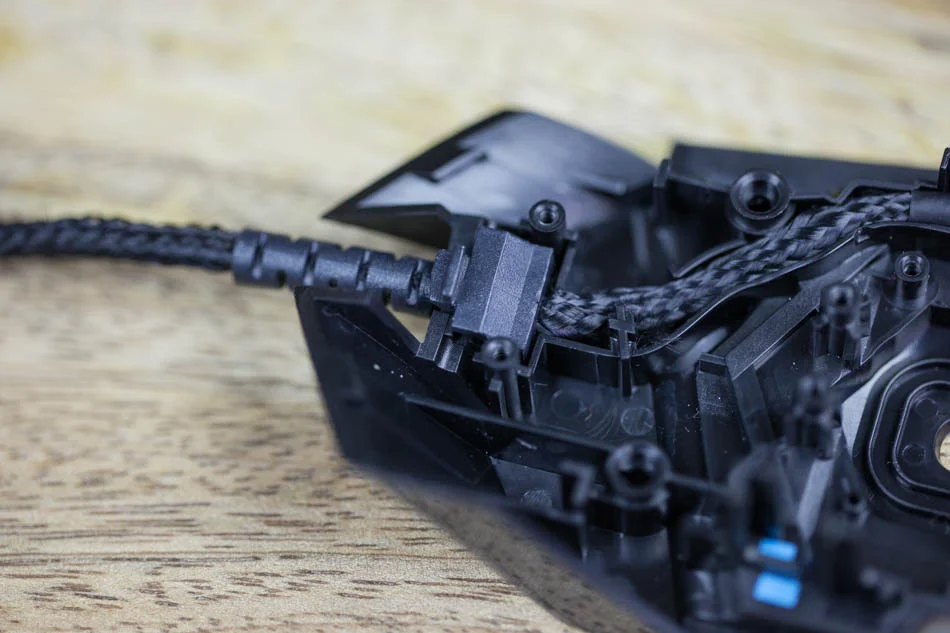

Uni-directional designs give bend relief in one direction while remaining stiff in the other. They work using series of plastic segments that come in contact with one another to create a minimum bend radius, and are effective in that direction. Because this design allows for strain reduction in only one axis, the applications are specific. This design is beneficial in applications like mechatronics or robotics where the cable repeatedly bends in the same direction.

As with uni-directional designs, multi-direction strain relief relies on plastic segments to limit the bend radius and protect the vulnerable connection. This design allows for movement in two or more directions by alternating the connection points between segments. Because of the flexibility of the design, this is the best option for most consumer products and is widely available. You’ll commonly find this design on the electronics around your home.

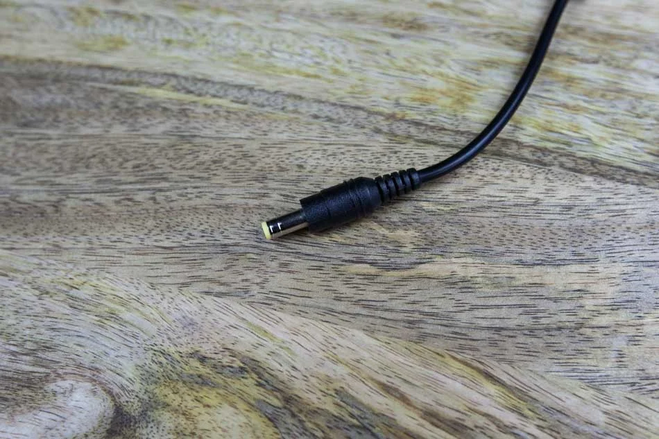

Increasingly popular for mostly aesthetic reasons, solid strain relief can be seen on everything from lightning cables to vacuum cleaner cords. This is, in simple terms, a thickening of the coating around the wire at the point of connection. Solid strain relief is often a custom strain relief design. While these designs look great, they require extra caution because the strain relief area is often too stiff, so the strain concentrates at the junction between the strain relief and the cable. The key here is to make sure that the strain relief is flexible enough for the cable to bend inside the strain relief area instead of at the junction — but even great designers get this wrong (I’m looking at you, Mr. Ive).
As an additional consideration, solid designs are the easiest to clean — so they’re the only option for food, beverage, and medical industries. Just remember to approach the design carefully.
