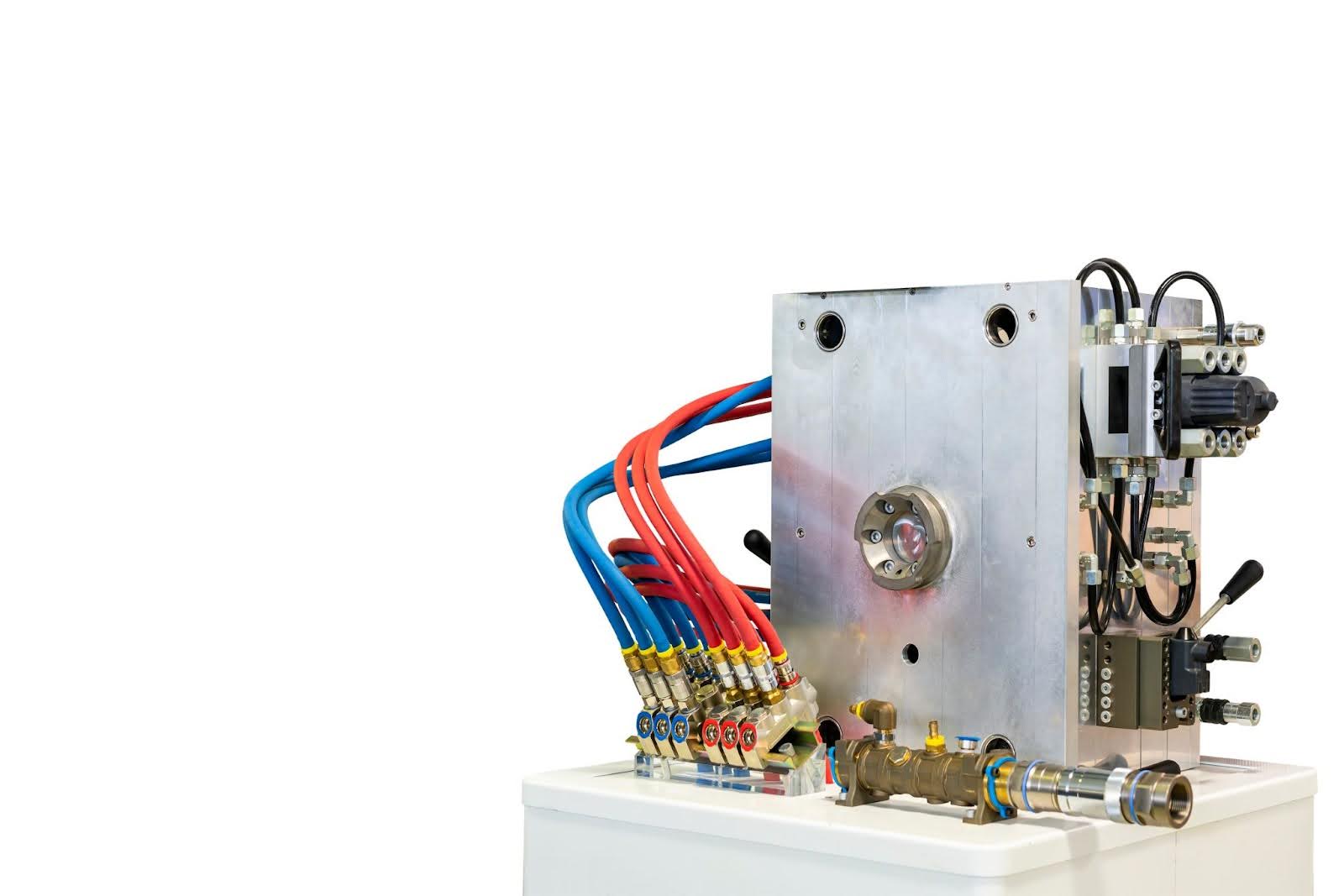

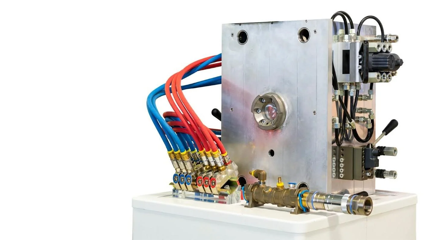

Quick-connect hose coupling system for an injection mold
