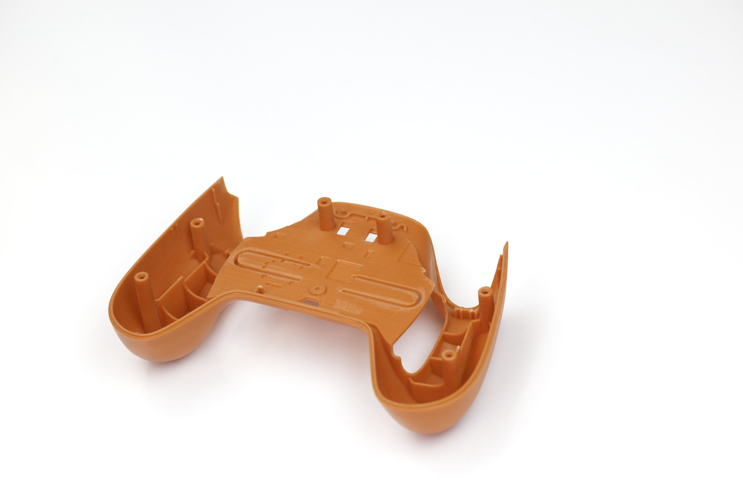

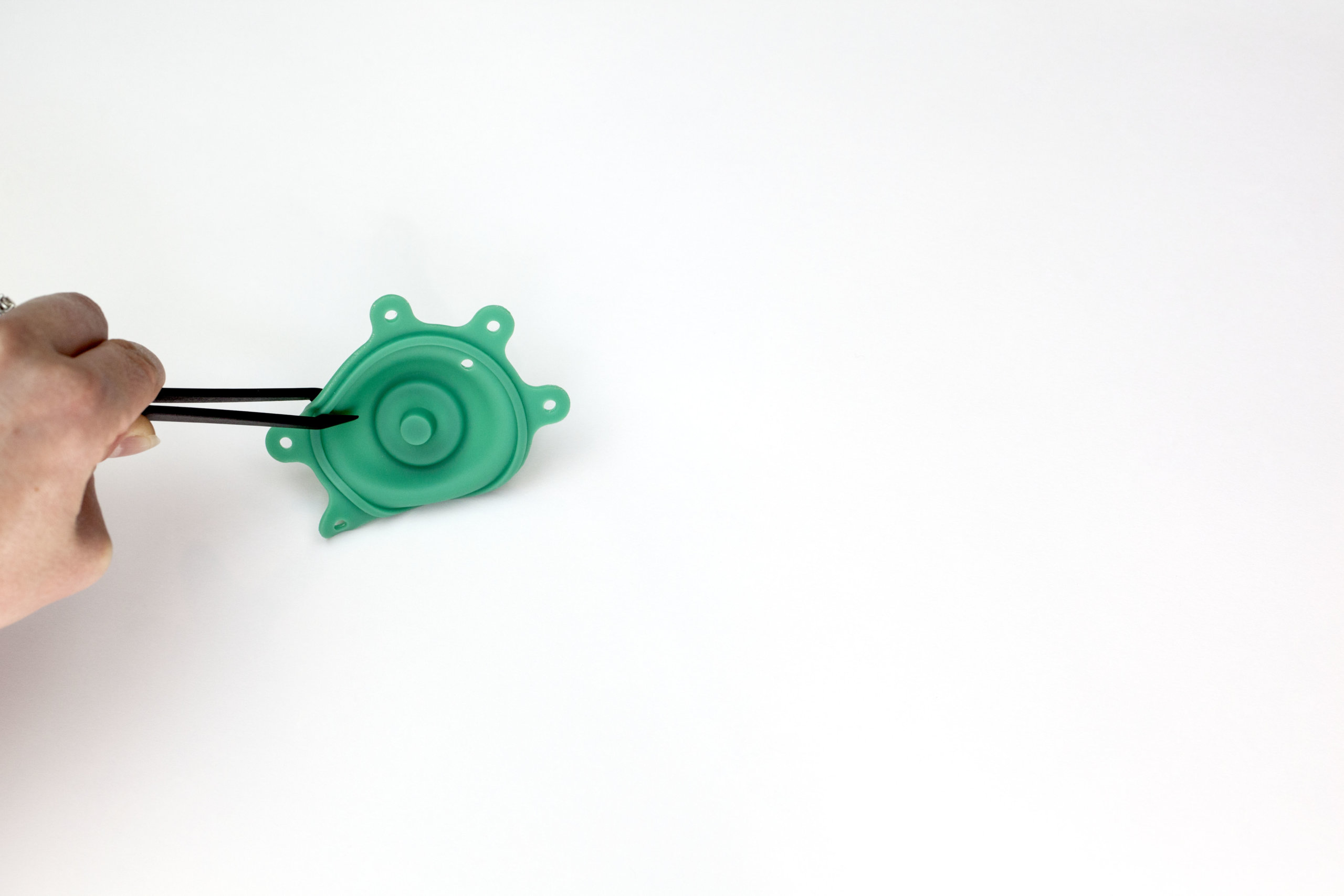

Urethane casting is useful for creating looks-like models for marketing images, pitches, and internal proof of concepts. It allows for complex geometries like small undercuts and complex elastomeric parts like gaskets. There are a wide range of materials available and the tooling is low cost with a quick lead time. This low cost, rapid turnaround time allows you to easily and quickly make molds while the design evolves.
Late prototyping and low volume production
Due to the aforementioned advantages of urethane casting, it can also be used for later stage prototypes and low volume production. You can test the production process before actually investing in hard tooling. Each mold can be used multiple times, which lets you  produce parts faster than 3D printing or CNC machining.

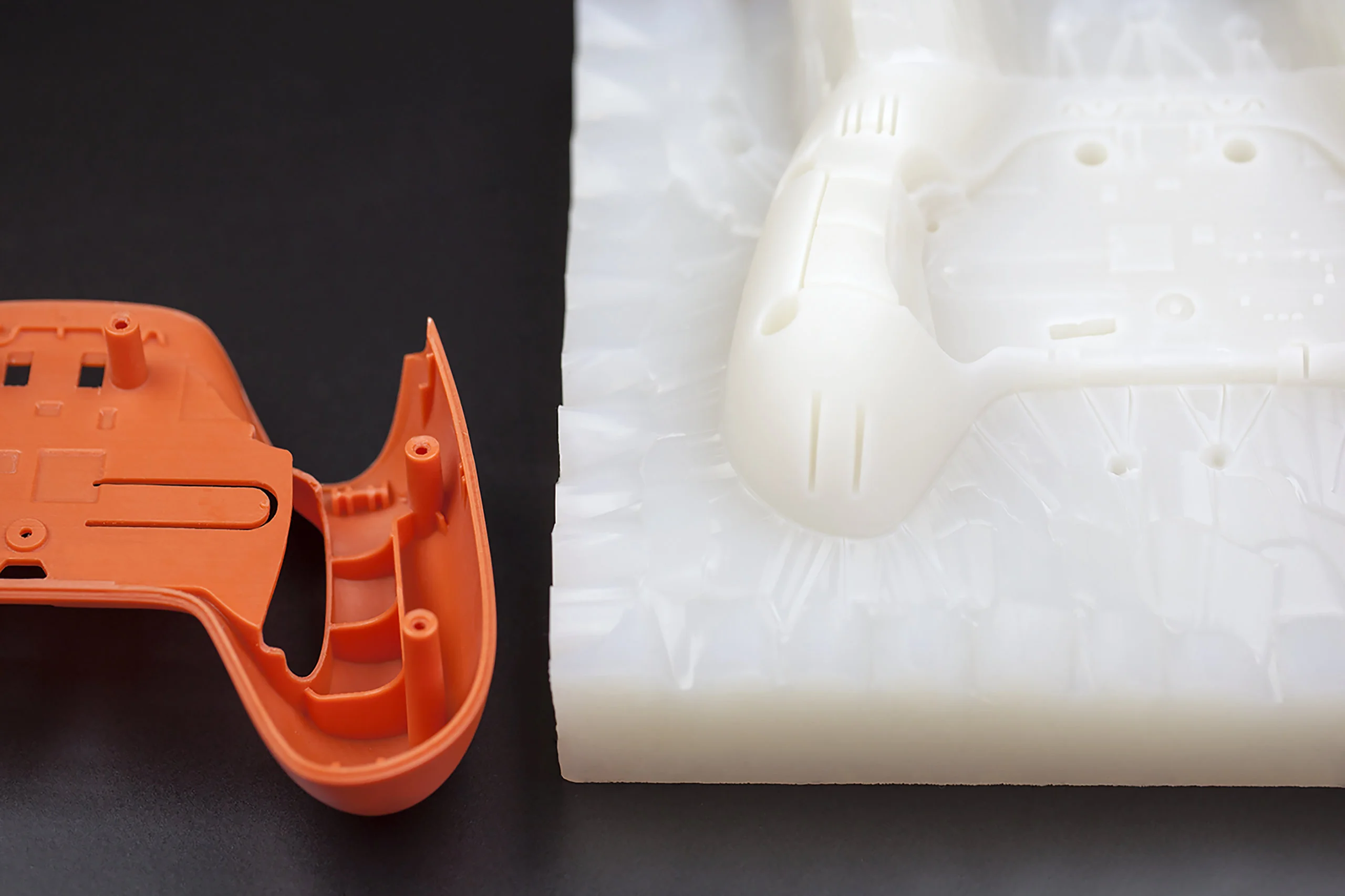

In order to create urethane cast parts, you’ll need to start with a master, which is just the design of the final part. This master part can be made using 3D printing or CNC machining. 3D printing has the benefits of being faster and less expensive, and can create complex geometries that are more difficult with CNC machining. However, 3D printed parts often have lower durability, and may wear after a few uses.
CNC machining creates a more rigid master that can be used indefinitely. Machining can also produce a finer surface finish, which is important because the silicone that is used for the mold will pick up tiny details, including the ridges on the surface of a 3D printed part. A CNC machined part can also have different surface finishes or textures applied to it, which will then change the surface finish of the mold and therefore the finished product.
Once you have the master, you cover it with silicone and let it cure. This process is called RTV (room temperature vulcanization) molding and is how you create the mold for urethane casting. The silicone starts out as a liquid and cures to the solid but flexible mold, which you then cut open to remove the master.
Next, you’ll need to add an inlet for pouring in the liquid resin, and an outlet for allowing air to escape. The inlet and outlet can also be added earlier in the process, when you first pour the silicone. After pouring in the resin, it cures to the same shape as the master part, only it’s made of a different material and in a quicker and more repeatable way. Once you have the mold, the casting process takes just a couple hours, which is faster than a 3D printing job. And with multiple molds, multiple parts can be made at once. The molds will also ensure the repeatability, versus variation in the 3D printing process.

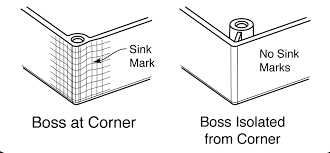

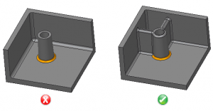

Wall thickness
When designing your part, make sure you have a uniform wall thickness throughout. Avoid thick bosses, as these thick areas will be prone to sink. Instead, you can have a smaller boss that is attached to the walls of the part using ribs.

Heeding these design considerations will help you avoid issues that you’d otherwise encounter with urethane casting. For example, if you have parts thicker than 4 mm or walls that aren’t a uniform thickness throughout, you’re likely to end up with sink marks and damage the part’s appearance.
