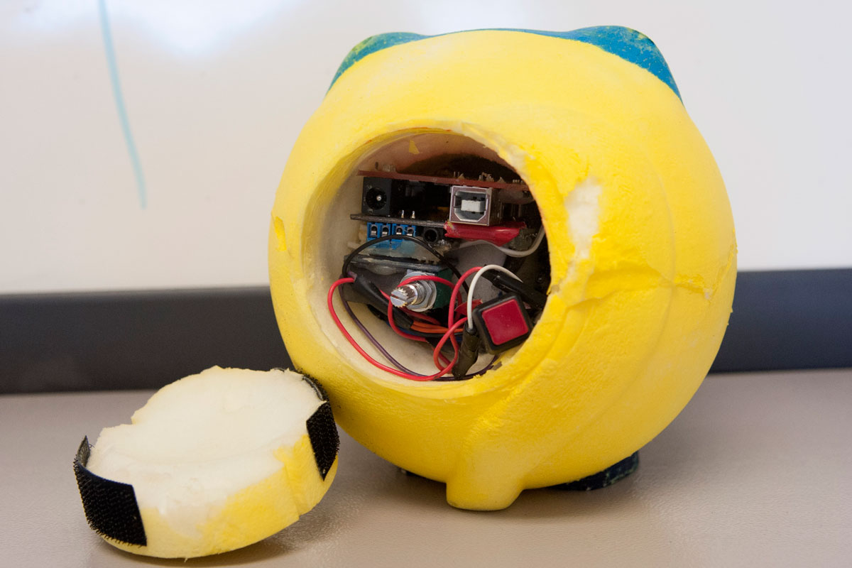

“The prototyping process took us a pretty long time to figure out,” Jack says. “We started by hollowing out Nerf balls and putting in the electronics. Then we needed to find a way to shape the face on the ball. We talked to some local model making shops—one option was to model the face in acrylic and inject the foam into the acrylic block, but that would have cost $6,000, and we didn’t have the budget for that.”

Brenden completes Jack’s thought: “So we talked to Fictiv and they told us we could do the mold with 3D-printed parts. The face would be modeled in a quarter-inch-thick shell, and we’d inject the foam into that. Best part, it would be only a couple hundred dollars.”

Some of the physical tolerances Jack and Brenden had originally specified during the CAD stage didn’t quite match the real world. Some parts needed to be reprinted larger to fit all the electronics. “When you use CAD,” says Brenden, “you need to account for the wiring, so that’s something you need 3D printing for.”

“Foam,” explains Jack, “is really sticky and expands into the cracks of a 3D-printed mold. We tried urethane, but that stuck just like the foam. So we looked for materials that are smoother and don’t stick, like silicon. We 3D-printed a plastic replica of the ball, then submerged that model in a bucket of silicon. When it dried, we cut out the plastic model, and now we had a hollow silicon chamber that we could inject the foam into. It took a good few weeks to do all this.”

“It was our first day testing with the first fully functioning prototype. We were really excited. I was explaining the first game and how it’s going to work. A sentence in, a kid took off with the ball, and all the other kids ran after him. He smashed it, stomped on it, and of course it broke, wires went flying.” Why? Well, “because it only had the board and the batteries, no protective structure. So we made an inner housing for the electronics from polycarbonate plastic that can withstand a lot of impact.”
