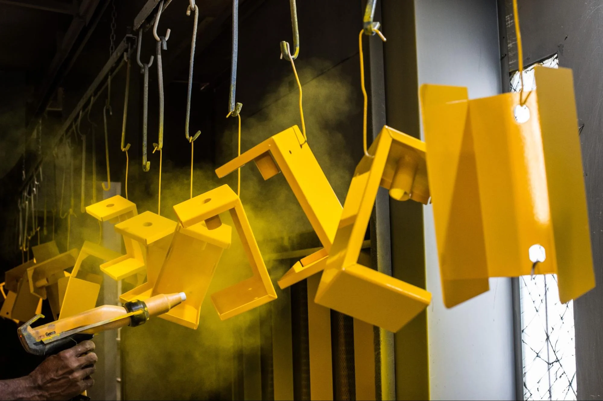

The two primary methods for applying a powder coat are Electrostatic Spray Deposition (ESD) and Fluidized Bed Coating.
In ESD, the most common method, electrically charged powder particles are sprayed onto grounded metal surfaces. This process ensures even coverage and strong adhesion. However, certain factors must be carefully controlled, including voltage settings, film thickness, and the shape of the part being coated. Automated voltage adjustments help maintain a consistent surface finish, while spray techniques may need to be modified for complex geometries to ensure proper coverage.

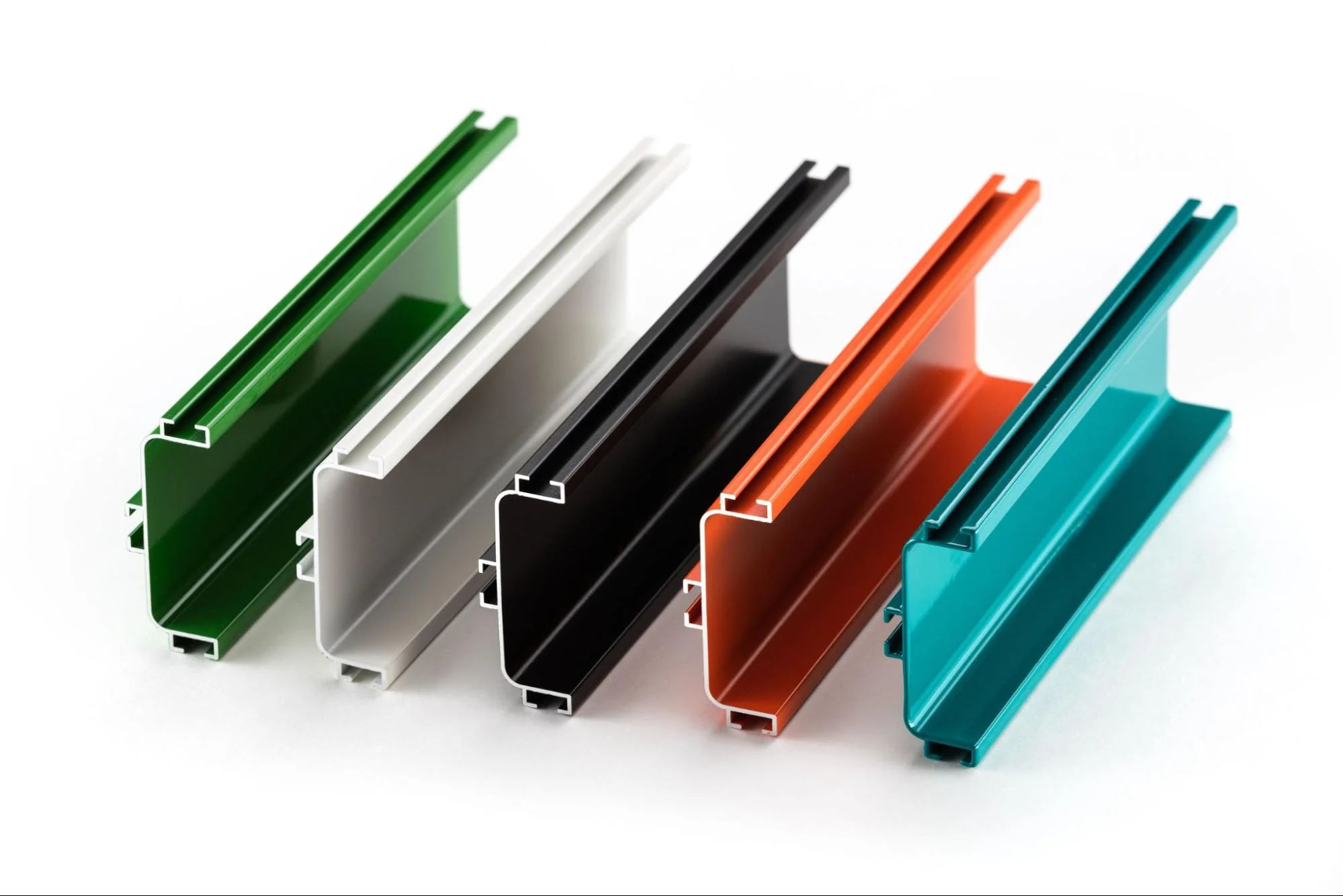

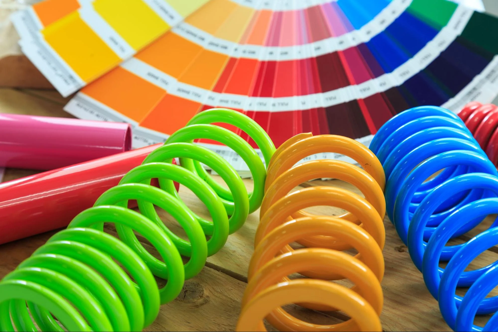

Powder coating is not just for aesthetic purposes; it is widely used in industrial applications as well. It can be customized to match Pantone and Reichs-Ausschuss für Lieferbedingungen (RAL) color standards, including metallic, textured, and transparent finishes.
Metal springs powder coated to match specific Pantone colors

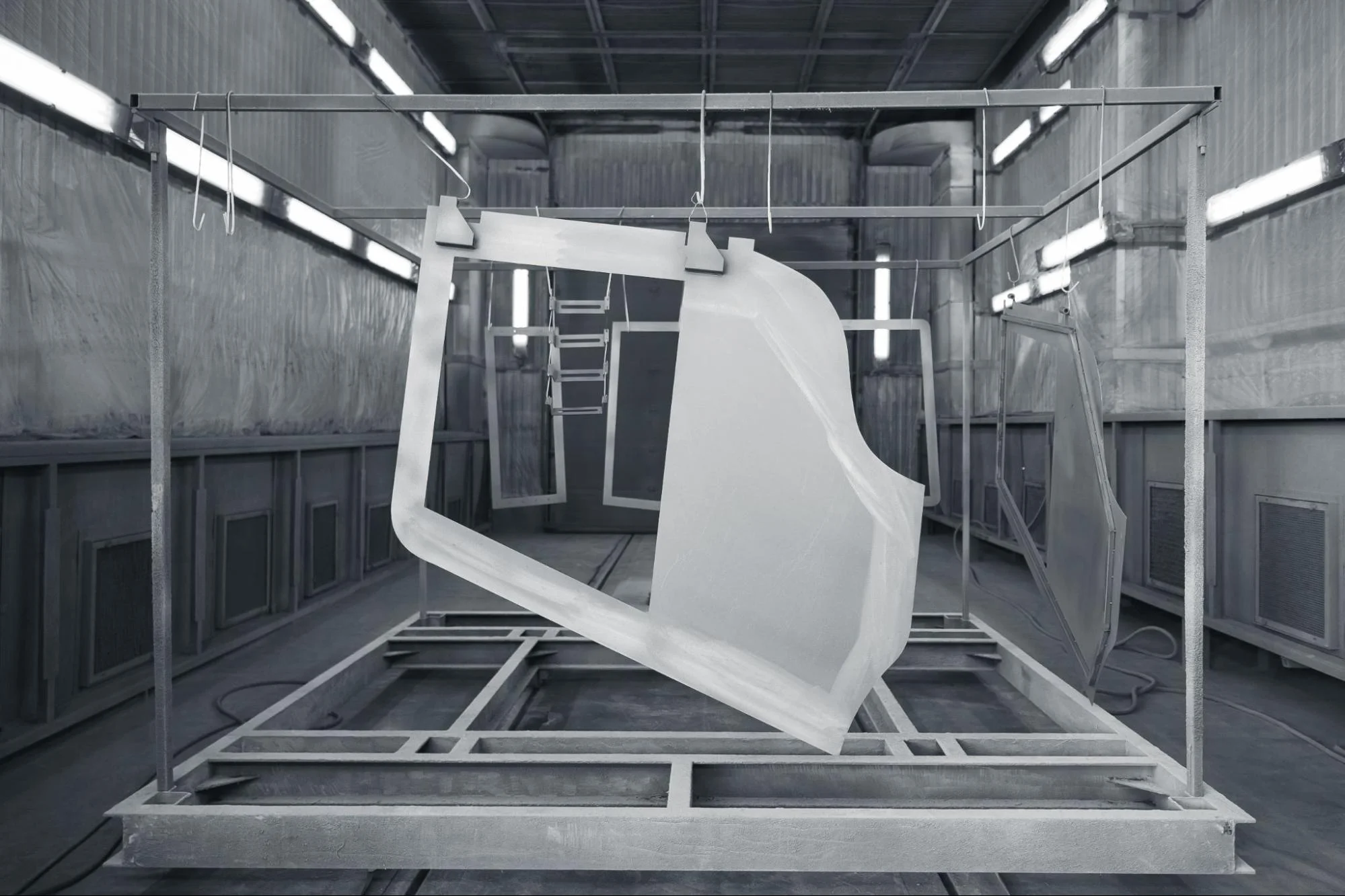

Powder coating has many industrial applications

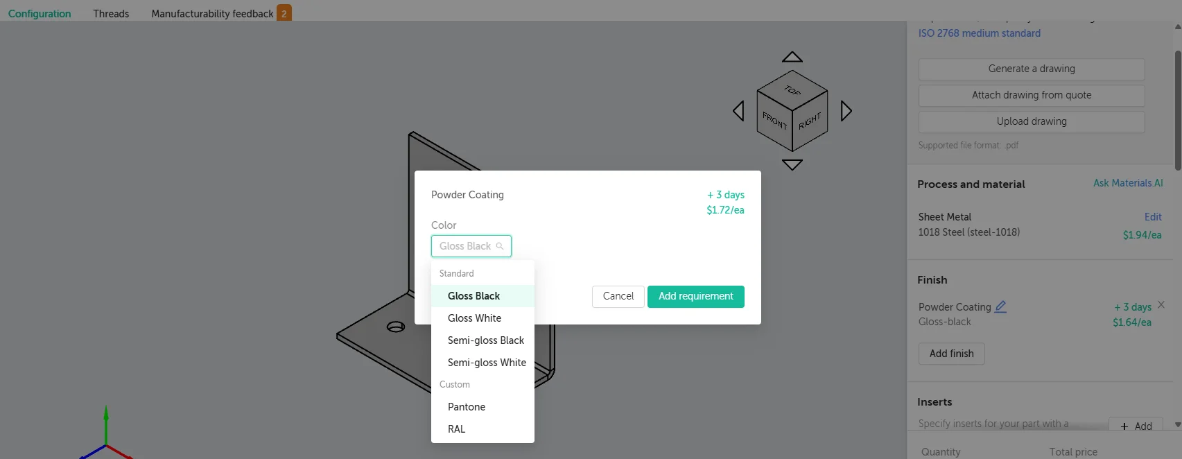

Get in touch with us today for a quote and see how we can help you with powder coating for your prototype or production parts. You can also use Fictiv’s online quote tool for quick estimates—simply add a finish while quoting and select a color option from the dropdown list.
Screenshot of a quote for a powder-coated part.
