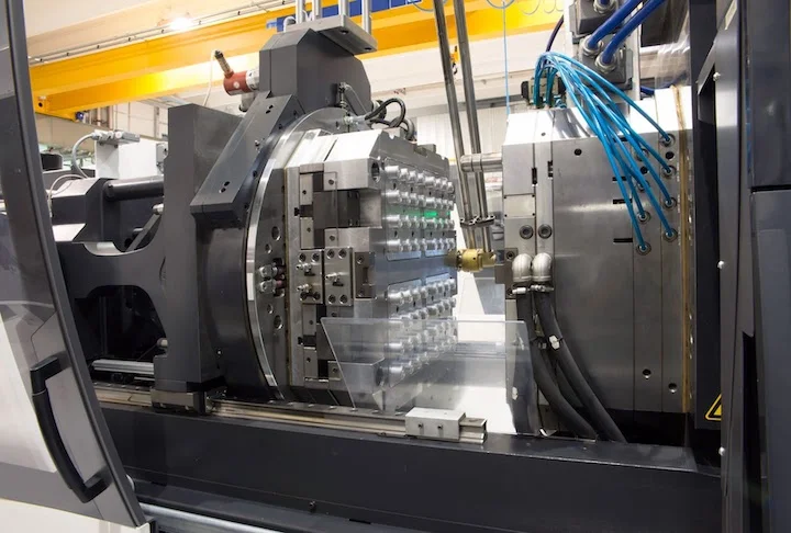

Figure 2: Injection Molding Machine

Plastic injection molding with nylon involves choosing the right processing parameters — below are some of the most important to consider:
- Viscosity
- Moisture
- Temperature control
- Injection pressure
- Injection speed
- Gassing
- Shrinkage
Viscosity
Nylon has a low melt viscosity and can flow quickly through tight channels before setting. This supports its use with injection molded parts that have thin walls and long injection paths. Nylon’s low melt viscosity also helps to minmize cycle times since nylon will fill a mold cavity more quickly than other plastics.
Moisture
Nylon absorbs moisture over time if it isn’t stored correctly. In injection molded parts, excessive moisture can cause voids and surface defects. The rate of water absorption depends on factors such as the specific nylon grade and the relative humidity. A moisture content of between 0.15 and 0.20% is optimal, and higher humidity results in faster water absorption.
Temperature Control
Nylon injection molding requires proper temperature control of both the mold and the material. Higher mold temperatures result in less shrinkage and enable the production of thin-walled parts due to the decrease in viscosity. Increased temperatures also improve the material’s crystallinity, which increases strength and hardness. Note, however, that temperatures above 330°C can result in thermal degradation.
Injection Pressure
To account for variations in viscosity, nylon injection molding machines need to maintain an appropriate injection pressure. Inadequate injection pressure can result in knit lines and a surface that appears corrugated. Excessive injection pressure can result in part defects such as overflow or flash.
Injection Speed
Nylon supports faster injection speeds because of its low viscosity, which results in shorter cycle times for reduced per-part costs.
Gassing
Gassing refers to the generation of excess gasses during injection molding. If these gasses are not venting properly, underfilling and surface defects can result. The causes of gassing include poor mold venting, and improper barrel temperature and throughput.
Shrinkage
Nylon is prone to shrinkage, so it’s important for injection molders to limit and control shrinkage rates — otherwise, shrinkage can cause dimensional inconsistencies and warping. To reduce shrinkage, increase the mold and barrel temperature.
