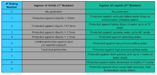

The International Protection (IP) Marking System
The International Protection (IP) marking system is the generally accepted method for evaluating electronics housings that’s also called the Ingress Protection marking system. It gives concrete meaning to the term waterproof by using standardized tests that must be passed to achieve different levels of waterproofness. The system has two unrelated numbers following the IP: The first number indicates the level of dustproofness, while the second indicates waterproofness.
If you want to only indicate the level of waterproofness, an “x” can be used in place of the first number. For example, IPx7 means we know how waterproof the enclosure is, but we neither know nor care about its dustproofness.
The higher the IP rating, the better the sealing design of the part/product. For instance, a product with an IP67 rating has much higher protection against the elements than a product with an IP14 rating. You can see the full spectrum of rating numbers below:
For most applications, the lowest rating considered “water resistant” is IPx4. This describes many older watches and means that the interior parts will keep working after a splash of water, but any more water will be an issue.
IPx5 is decent step up — if you spray your housing with water from any angle, the interior parts keep working. However, this level only stays waterproof if the spray is light, or just over 4 psi and relatively low flow. IPx5 is a good level for a “rain-proof” housing, which is why a lot of phone housings come from the factory with this level of waterproofing.
At IPx6, the testing is more intense. A housing must remain waterproof for several minutes with a 100-liter-per-minute jet at 15 psi. Most consumer electronics can’t survive this test, and if they can, their designers are bragging about their “IP Rated” product.
At IPx7, the test requires immersion in a meter of water for 30 minutes. If this test goes wrong, it goes really wrong, and you end up with scrap electrical parts.
Pro-tip: Just because your housing can withstand the static pressure of water at a one meter depth doesn’t mean that it can withstand the water jet test from IPx6, so test both if the design will need to resist forceful spray.
With IPx8 we reach the level of a GoPro’s housing. An IPx8 rating means that your housing can withstand long-term immersion in water of some specified depth — for GoPro, that depth is 60 meters. At that depth, the housings are guaranteed to stay sealed at a pressure of 87 psi — incredible!
At IPx9, the tests focus on close-range, high pressure and high temperature spray downs. At this level, the enclosures start having esoteric specialty designs, and it’s not difficult to imagine standard sealing mechanisms failing.

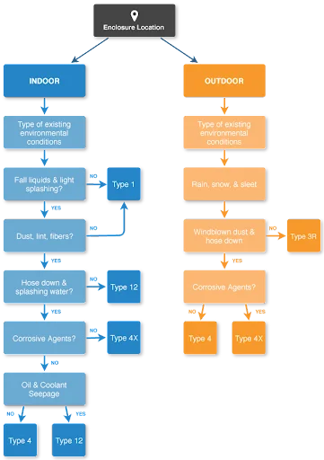

The NEMA Rating System
The National Electrical Manufacturer Association (NEMA) created a rating system that determines how protected a product is by determining the product’s ability to withstand exposure to oil, corrosives, snow, and other elements. Unlike the IP rating system, NEMA is mostly used in industrial applications and deals with more than just protection from water and dust.
To use the NEMA rating system, you must first determine if the product is to be used indoors or outdoors. Next, you determine which elements the product may encounter, whether the product will be hosed down, and finally, if the product will be exposed to corrosive agents, oil, or coolant.
According to the system, for indoor use you can have a rating between 1 and 13, which correlates to an increase in protection against elements found indoors. Like the IP system, the higher the rating, the better the protection. For outdoor use, there are ratings of NEMA 3, 3R, and 3S. NEMA 4 correlates to products used in conditions containing high-pressure water, such as washdowns.
