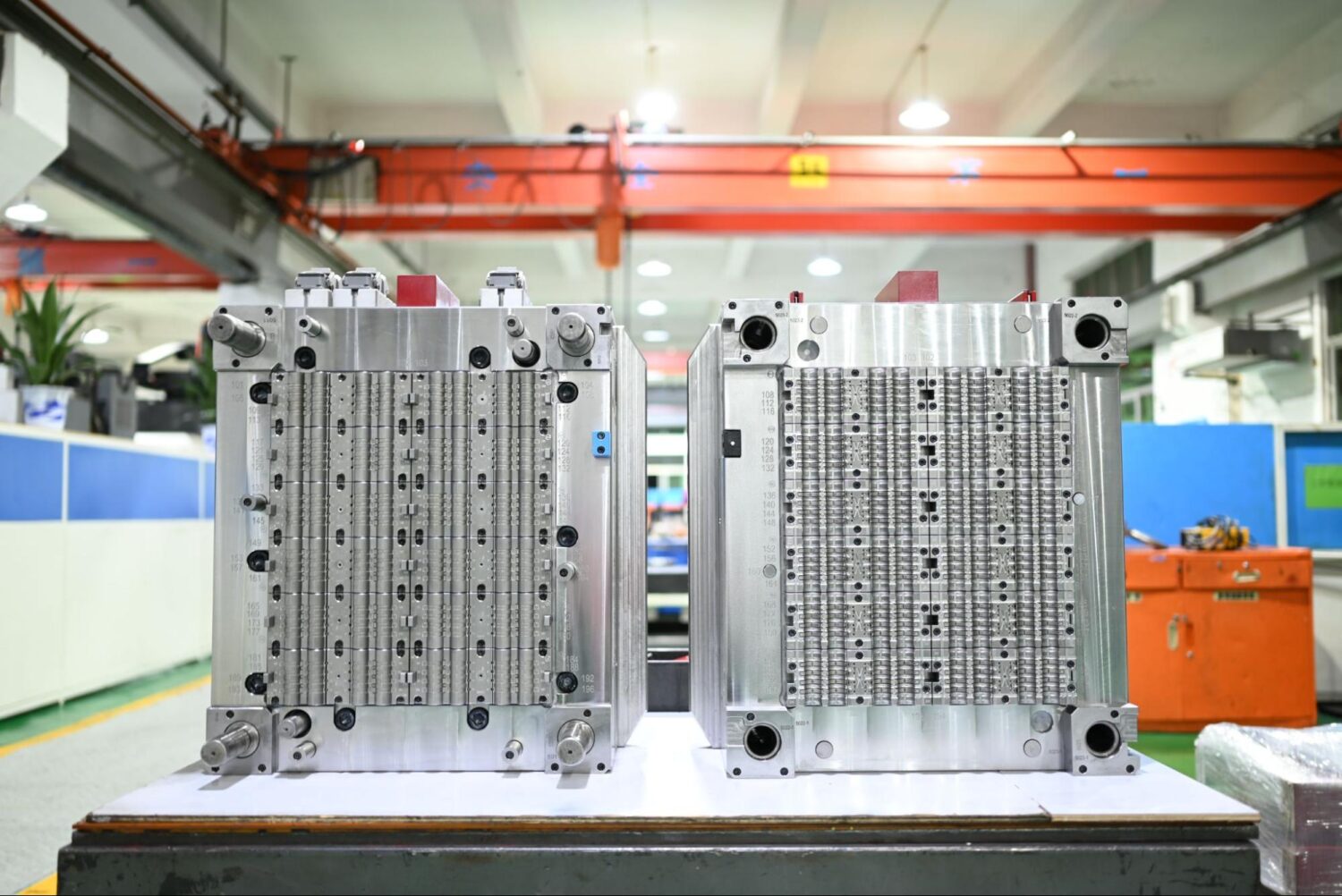

An impressive multi-cavity injection mold for high-volume production.

Designing a multi-cavity injection mold is more complex than a single-cavity mold.
