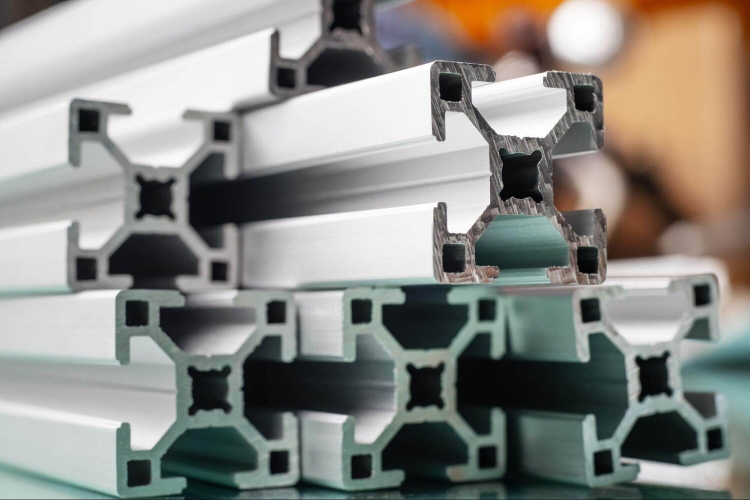

Metal Extrusion
Metal extrusion is a manufacturing process where heated metal is forced through a die to create parts with a uniform cross-section. This method is particularly effective for producing long, continuous shapes such as rods, bars, and tubes. Common metals used in extrusion include aluminum, copper, and magnesium, chosen for their lightweight properties, strength, and conductivity.
The process is widely used in industries such as electronics (heat sinks, connectors), construction (structural frames, window profiles), and automotive (tubing, chassis components). Extruded parts are valued for their consistency, precision, and ability to meet complex design requirements.
Metal extrusion is ideal for creating lightweight, high-strength parts, making it a preferred choice for applications where weight reduction is critical. The process also offers excellent material utilization, as it minimizes waste and allows for the recycling of scrap material. Additionally, extrusion supports the production of complex cross-sections with tight tolerances, ensuring high-quality results.
