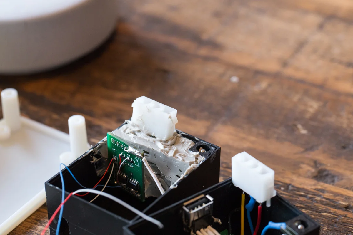

“The biggest dilemma was trying to figure out how the fabrics vendor, the soft goods vendor, and the electronics vendor could all work together,” Massimo recalls. “The electronics manufacturer has a very dirty process to seal enclosures and make them water resistant, so there’s no way you can bring the pristinely white soft goods in there. So the electronics have to be shipped to the soft goods company. However, the soft goods company doesn’t know how to work with electronics! They do however know how to crimp connectors. So what they have to do is crimp the connectors, slide the electronics inside the fabrics and then stitch it in.”
