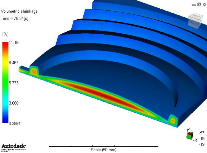

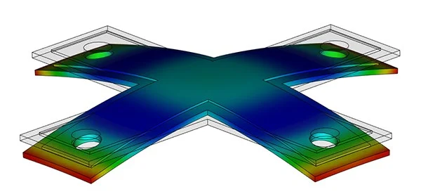

Mold Flow Analysis
For complex parts, one of the best ways to determine shrinkage is with a mold flow analysis. This software simulation shows how a plastic resin will fill an injection mold. A mold flow analysis can also help designers identify hard-to-fill mold locations.
The image below shows the shrinkage variation of an injection molded part. It’s from a simulation within Autodesk Moldflow, a commonly used software application for computer-aided engineering (CAE).
Image Credit: Plastics Technology

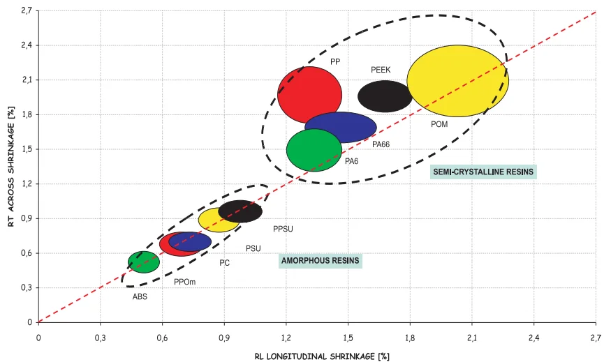

Designers also need to consider that semi-crystalline resins have higher injection molding shrinkage rates than amorphous resins. The mold shrinkage chart in Figure 1 below illustrates this.
Figure 1: Semi-Crystalline vs. Amorphous ShrinkageImage Credit: The Tool Hub
