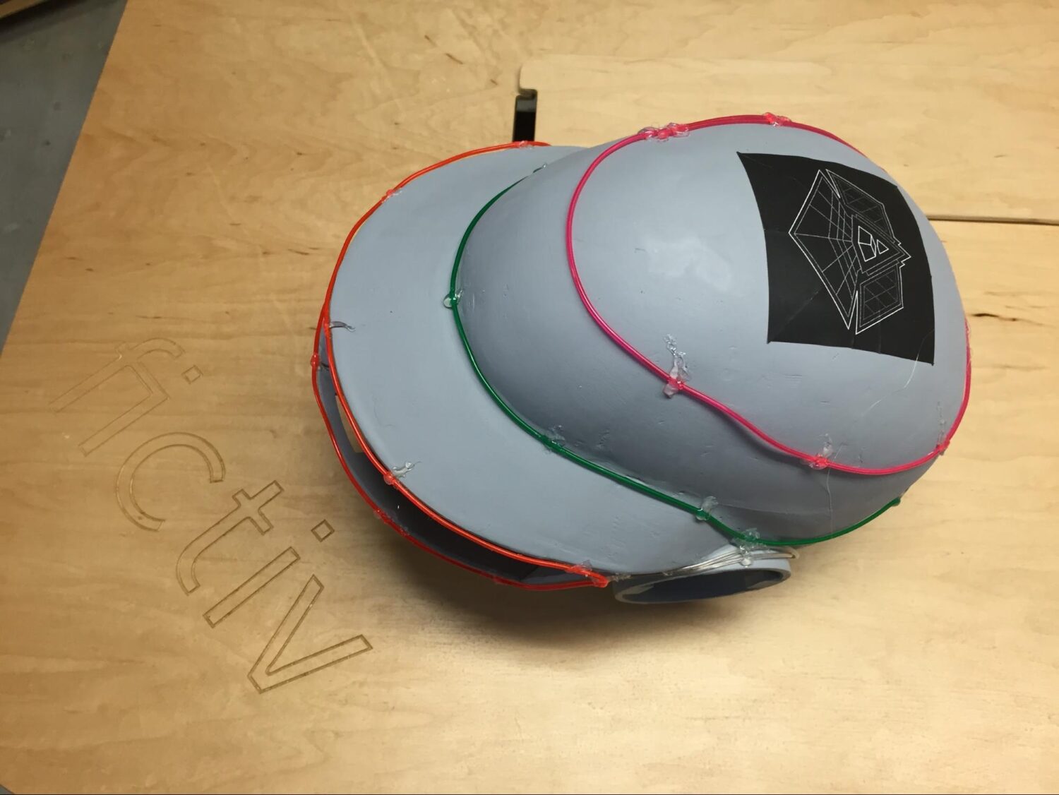

Now for the fun part! After some experimentation, we’ve found the best results come from the Montana Gold Acrylic Professional Spray Paint.
Before starting to paint, however, make sure your primer is fully dry. One quick and easy way to speed this part of the process up is by using an everyday fan (be sure to use cool air vs heated since heat can easily warp your print).
With both the primer and spray paint, you’ll want to work in even and horizontal movements. Try not to linger over any areas as this will build up uneven layers over your 3D print.
The number of spray paint layers is up to you; a lot of this will come down to your own judgment. If you nailed it in one layer, that may be all you need. If it looks too thin in some areas, an additional coat may be required.
Just be careful to not add too many layers as this would result in you losing all your carefully sculpted detail. The last thing you would want is to waste the 3D print so trust your instincts!
The Final Product
Even with all the layers of paint, the details are still preserved. Applying thin layers produced great results with very little effort involved. This process is very time effective too and perfect for a model you want to have all in one solid color. This is also great if you’re planning to make more than one model. Hope this helps you create better looking spray painted models! For more info on 3D printing materials and finishes, check out the Fictiv Capabilities Guide.
