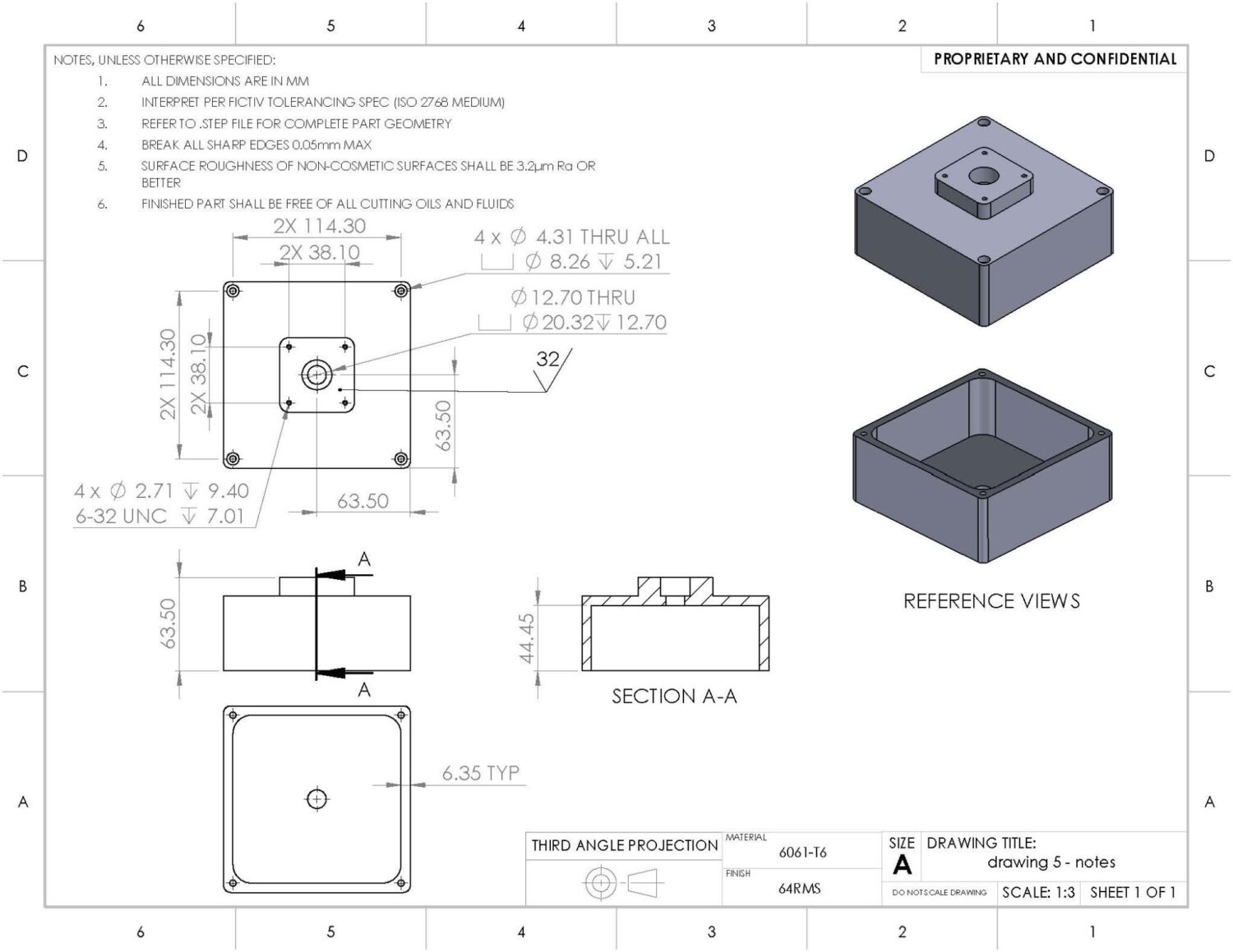

Next, we need to lay out the drawing views, which are commonly referred to as orthographic projections, or 2D view/drawings to represent a 3D object. The number of drawing views required for a given component depends upon the part geometry. Simple parts can be fully represented with two or three views, while more complex parts tend to need more. We have provided an example solid model of a demo housing part for the purposes of this tutorial.
Our engineering drawing requires three views and a section view, which shows the part as if it were cut in half to view its internal features. You can add drawing views to the base drawing template by clicking ‘Model View’ in the ‘View Layout’ tab and selecting your model (see detailed instructions from the SOLIDWORKS website here).
Pro-tip: For most CNC machining drawings, two or three orthographic views are sufficient to describe the geometry, dimensioning, and tolerancing of the component to be machined.

The first step of the GD&T process is dimensioning the orthographic views you added to the drawing. This process is significantly simpler now that most of the geometric information is contained in your solid model. Start with the overall dimensions, the ones which determine how much raw material will be needed to machine your component.
Next, define the critical part dimensions. Critical dimensions are those that must be accurate, usually because they’re where the part interfaces with another part. Hole patterns are a good example of critical dimensions — for instance, on the outer four corners of the demo housing part. This hole pattern represents how the part will be mounted to a base and must match the holes in the interfacing part.
Tolerancing
Prior to tolerancing an engineering drawing, consider two things: the tolerance you want and the tolerance you’re calling out — and bear in mind that generally, tighter tolerances increase the cost of a CNC machined part. Next, refer to the general tolerance instructions in the title block of the Fictiv drawing template.
The tolerance is determined by significant digits of the basic dimension, as shown in the table below.
Now, let’s say the desired distance between the outer holes is designed to be 114.3 mm. If you call out the dimension as “114”, general tolerance per the above table would define the tolerance to be (X) at a value of ± 2.5 mm. Calculating the range for the “114” dimension, based off the X tolerance, the acceptable distance between the holes is anywhere from 116.5 to 111.5 mm. This wide of a range probably won’t work if we are interfacing with another part.
Instead we want a tight tolerance on this dimension, so we’ll use the one-decimal place dimension (.X), which is ± 0.25 mm. Similarly, we’ll use the one decimal place dimension for the inner hole pattern. Also, notice how identical dimensions don’t need to be called out, but simply need a “2X” placed in front of the called-out dimension.
Pro-tip: Geometric relationships and datum lines should also be defined on the drawing, and while we don’t discuss them here, you can read about datums in this article.
For this particular part, there’s a looser tolerance for the height because there are no requirements for how large it can be. So, we can add the dimension to center view with no decimal places, giving us a tolerance of ± 2.5mm.
On the bottom view, I’ve called out wall thickness to be 6.35 followed by “TYP”, which means typical. Essentially, this means that all similar wall thicknesses can be called out with just one dimension to make the drawing cleaner.

Special Dimensioning and Tolerancing for Holes
After dimensioning the hole positions and other critical dimensions, we need to dimension the hole diameters, depths, and associated tolerances along with any thread tapping required — the top of our demo housing needs four countersunk outer holes and four inner #6-32 threaded holes.
Pro-tip: If you only have threaded holes to call out, you can skip the drawing and simply use Fictiv’s Auto Thread Detection tool.
Identical holes can be called out collectively by placing a “4X” in front of the called-out dimension. In our example, we’re using UNC threads because the taps and hardware are generally more available in the U.S. Also, there are two types of holes: thru holes that go entirely through the part and blind holes that have a specified depth called out with a ↧ engineering drawing symbol. The depth of countersunk holes is similarly called out using a ⌴ symbol.

Drawings are also useful to notify your manufacturer about specific surface instructions. Surface finish corresponds to the type of endmill and the speed that the CNC operator uses to cut the particular surface. In general, 64RMS is a smooth finish, but you may be able to slightly feel the toolpaths. I recommend 32RMS or lower for O-ring interface surfaces and any surface that you want to be really smooth.
Surface finish comparator showing the difference in a few surface finishes.
As with other tolerancing, the tighter the tolerance (and the smoother the surface finish), the more expensive the machining. I’ve added a 64RMS finish to our example title block, but I’ll add a note because we want a smoother finish on the top surface of the demo housing.

The upper left corner of a drawing is used for additional notes for the manufacturer, which may include finishing instructions or part marking. This is the final element to create a clear engineering drawing. In our drawing, we’ll add a note for breaking all edges, as well as a few other useful basic notes:
- Defining units
- Providing tolerance information
- Cross-referencing to solid model
- Brak sharp edges
- Surface finish requirements
- Cleanliness requirements
While not all of the listed notes must be included in every drawing, they provide a good starting framework.
