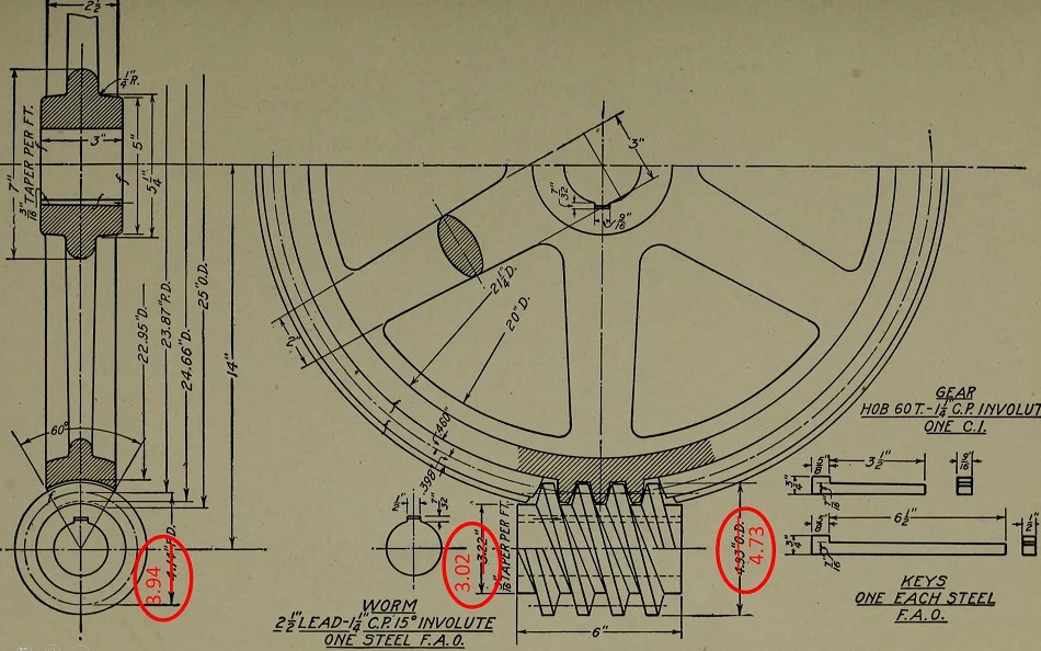

The first step in this communication usually involves the ECR and a “redline”—a drawing or document that clearly shows the change to be made, by marking up the current revision with literal redlines and red text on the PDF. The old design should still be visible, along with the change to be made, and in the revision block, it should note that this is “rev X – redline 01”. For every redline adaptation, the last number should be incremented, and only one department at a time should have change rights—avoid parallel changes.
