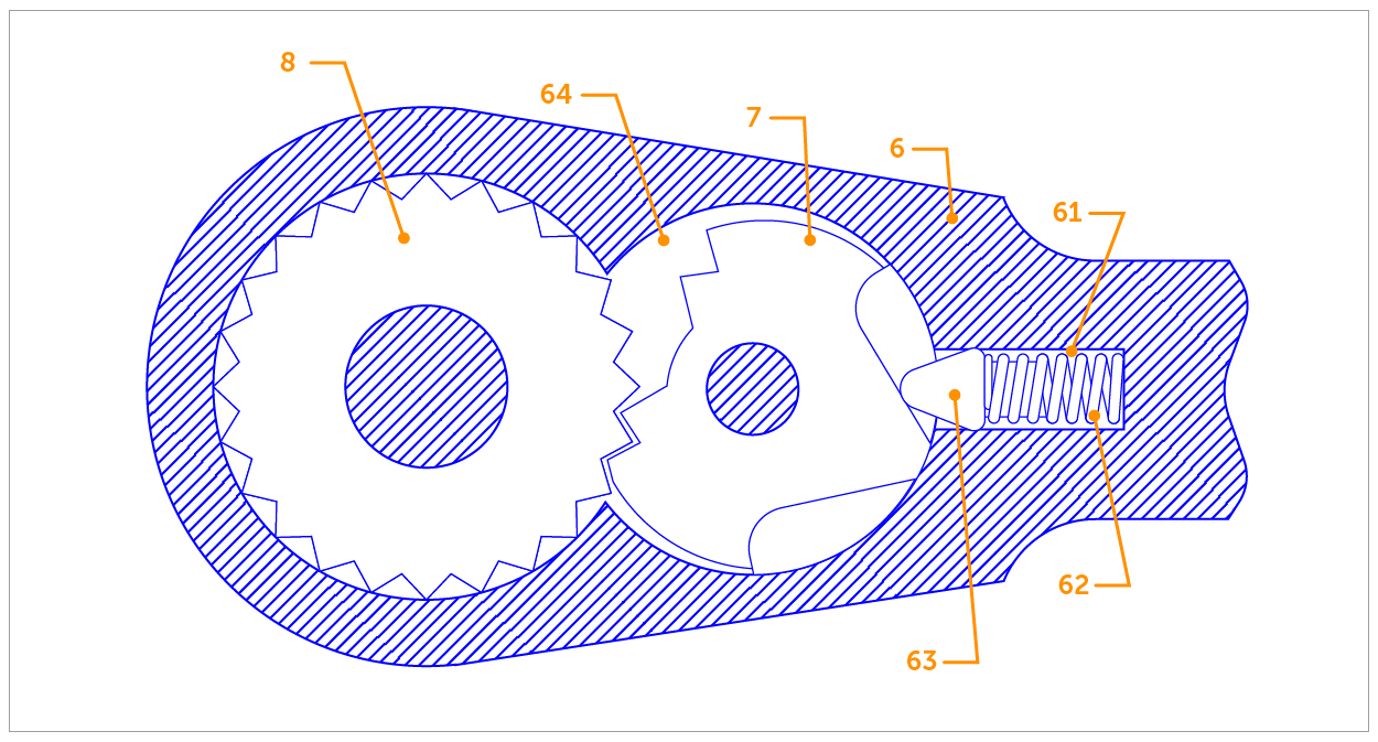

Now that we have the D-FMEA set up, we are ready to begin completing the document. In this section, we’re going to work through an example using a ratchet drive. The image below is the patent artwork for a common ratchet that has item callouts for the Pawl (7), Ratchet Wheel (8), Detent (62, 63 and 64), and the Ratchet Main Body (6).
These are the items that we will define in our FMEA under the “Item” column as shown below (normally, we’ll list them one at a time because it prevents us from having to move cells around too much):
The detent could have been broken into more components, but for this example, there was little value in doing so. The next step is to begin identifying the failure modes that we believe may occur.
My preference is to complete the FMEA from left to right for each item, and then move down to the next item and repeat. That means we will finish the Ratchet wheel first, as indicated below.
We can see that in some cases, it’s possible to have multiple effects for each mode, such as the Ratchet Wheel and Pawl. We also see that the severity of these effects is closely related to the cause. As an example, losing the ability to transfer torque is a lot worse when it is sudden, as a result of teeth shearing, than it is when the teeth never mate well enough to transfer torque in the first place.
It’s also important to note that the two causes will have different occurrences because it is more likely that a part will be manufactured out of tolerance than from non-compliant material (this can be swapped, based on the history of your manufacturer).
Lastly, we have identified the controls in place that are intended to prevent the cause from happening in the first place. For the teeth shearing, we can see that material inspections and structural analysis are the current controls to prevent the use of bad material, as well as structural analysis to ensure that there is sufficient design margin.
In this instance, we are now saying that we believe we are more likely to detect a dimensional issue than we are a material issue. This is because functional gauges and dimensional inspections are very effective, while it’s possible for material and process variations to go undetected and pass on incorrect material data.
We can see that the RPN value is simply the product of the ratings (5*1*2), and that we are more concerned with the teeth shearing than with them slipping straight away. This is clearly because of the possible safety issue and will certainly need to be addressed. It is common for an organization to say that any RPN above a certain value, or with a severity of 5 or greater, must be addressed and reduced.
In the image below, we can see the completed FMEA, and we start to get a feel for what items we need to target first.
