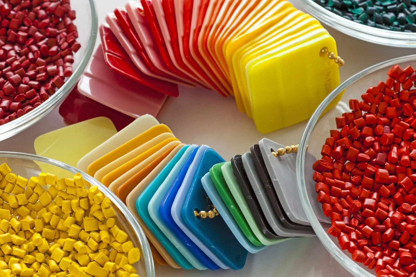

Pantone also sells a book of opaque and transparent plastics. A complete set costs several thousand dollars, but because the small injection molding factories won’t have these, it may not be as useful as the ink-on-paper formula guide. If you want a factory to refer to plastic chips, you may have to provide them. For 3D printing, plastic products, and hard goods needs, Pantone offers individual plastic color chips for use in a variety of applications such as food/beverage, consumer electronics, fashion, home goods, toys, and medical devices.
Now, I’m the first to admit that matching a printed swatch to plastic has limitations. If you want to get plastic chips for reference, I recommend using the formula guide as a starting point, then finding the corresponding plastic number here. Then you can buy single chips here to double-check that the color is what you’re looking for. Here’s a online store from Japan where you can glance at all the plastic colors.

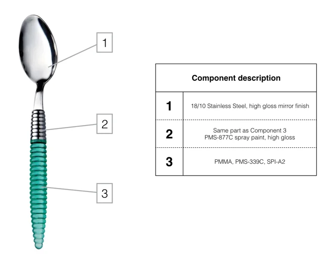

CMF Document Example
Some companies choose to convey CMF requirements in a CMF document or CMF specification. Now that you’re equipped with industry terms, you can make a CMF document that precisely captures the decorative qualities you want in your product. Best practice is to use a combination of text and CAD or rendered images to call out different CMF components on a single product.
Here’s a simple CMF example:
These techniques for communicating CMF work for both production parts and one-off appearance models, and will help you achieve high aesthetic standards painlessly!
