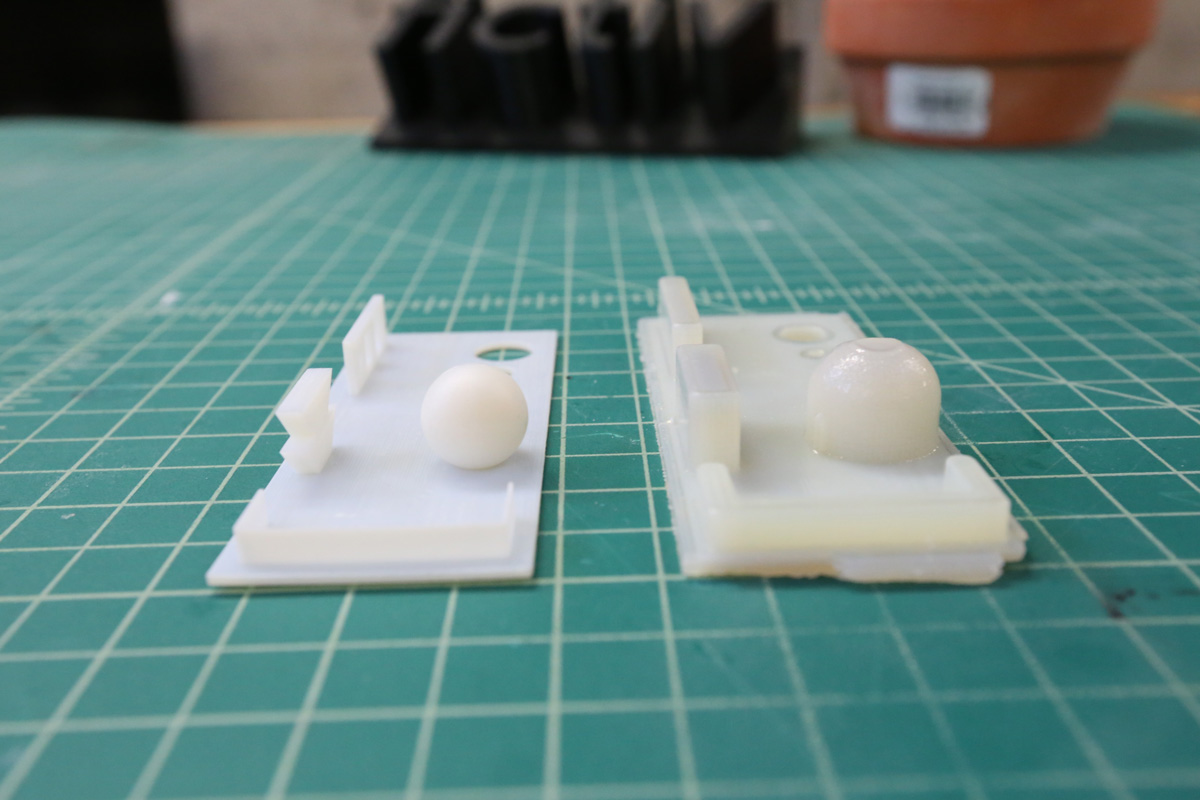

Check out the difference before and after cleaning:
