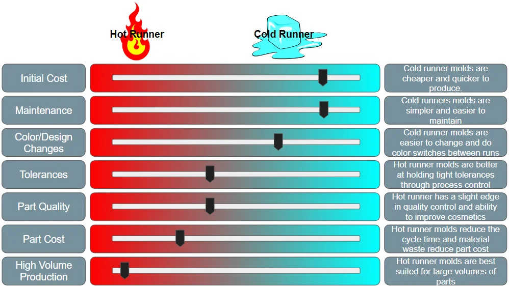

Initial Cost
In terms of their initial cost, cold runner molds are usually less expensive because they’re simpler in design and don’t require secondary equipment from a speciality supplier. Also, cold runner molds are generally faster and easier to produce since all of the pieces of the mold can be made and assembled in one facility.
Mold Maintenance
The simplicity of cold runner molds makes them easier to clean and maintain between molding cycles. Because these molds are less complex, an injection molder with an in-house mold shop can usually maintain them without sending anything out for repair. Hot runner molds, on the other hand, have many pieces and parts that can wear and break. New pieces may need to be ordered, and it may be necessary to send out the entire manifold for cleaning.
Color and Design Changes
When it comes to changing colors during a molding cycle, cold runner molds have an advantage. Because of their simplicity, there are fewer places to clean. This makes it easier to switch over to a new color without any bleeding from the previous pigment. Plus, changes to the tool are easier to make. Mold makers don’t have to account for the manifold, and they don’t have to consider where hot drops can and cannot be updated.
Tight Part Tolerances
With hot runner molds, the ability to control the pressure and temperature of the plastic material provides better control over injection molding tolerances. Cold runners can also support tight tolerances, but the advantage still goes to hot runner molds — for difficult and intricate difficult parts, it helps to have greater control over more parameters during molding.
Hot runner molds provide greater control over more parameters.
Part Quality and Aesthetic Concerns
Hot runner molds preserve aesthetic intent by controlling injection molding defects such as sink marks and weld lines. When injection molded parts have thin walls or many different small features, the hot drops in hot runner molds can make it easier to fill and mold better parts.
Part Cost
Hot runner systems also have the advantage in terms of part cost because they produce less scrap and have faster cycle times. For parts that are very small or very large, the amount of scrap can be significantly higher than if a cold runner mold was used. Because a hot runner mold has higher initial costs, however, part volumes are a key consideration before investing in one.
High Volume Production
When you want to make tens of thousands of parts, the initial cost of a hot drop in a hot runner system can be offset by the savings on individual part pricing, as noted above. Also, hot runner molds typically don’t require someone to clean the gate and remove scrap. This makes for a much easier-running tool with high volume production.
