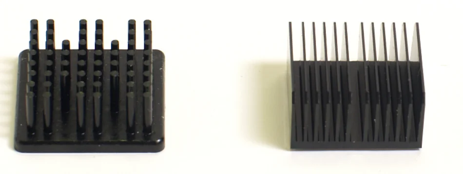

A passive heat sink is a mechanical component that is attached to an electrical component for the sake of transferring heat from the electrical component into the surrounding environment. This environment is most commonly air, but it can also be other fluids, such as water or coolant. The thermal conductivity of air is low, so electrical components need this extra cooling assistance, through these mechanical heat sink designs. Heat sinks are typically made of CNC machined aluminum or copper and have heat sink fins or pins that work to increase the surface area of the component, to facilitate the heat transfer to the surrounding fluid. The image below demonstrates two mechanical heat sink types: a pin (left) and a fin (right) type of heat sink.
As we can see, these two heat sink types have a much greater surface area than the flat heat sink with the same width and length. The metals of which heat sinks are made also have a much higher coefficient of thermal conductivity than the plastic packaging of typical electrical components. Most mechanical heat sinks are made of aluminum alloys, due to these alloys being cheaper than copper, which has a higher thermal conductivity. For this reason, copper heat sinks, the best metal heat sink material for thermal conductivity, are only selected when the unit must operate at much higher environmental temperatures, making the material worth the cost.

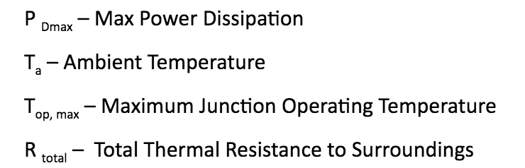

The formula below defines the maximum amount of power (or energy via heat transfer) that can be dissipated, given a few known variables:
Where:
The ambient temperature is room temperature for open electronics that are indoors but may be higher for projects that are enclosed with other heat-generating devices. It will be even higher than that if a heat-generating device is located outside, in the hot summer sun.
The thermal resistance is a value that defines the amount of temperature rise per watt of power dissipation within the component. If we look in the datasheet for the L298, we can see that the thermal resistance from the junction to ambient is 35 ˚C/W. That means that for each watt of energy dissipated, the chip will raise in temperature by 35 degrees.
Plugging these values into the formula above gives:

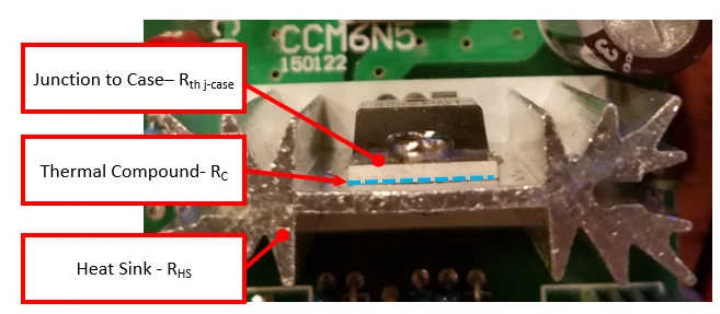

The image below (not an L298) illustrates the different sources of thermal resistance with a heat sink assembly.
The heat transfer process is through a few different materials; the heat will have to transfer through the case, the thermal heat sink compound, or adhesive (indicated by the blue dashed line) and then through the mechanical heat sink to the air. It is important to note that for the purposes of this article, the term “thermal compound” is utilized to represent any thermal interface heat sink compound material, such as paste, grease adhesive, or pad. Since there are multiple resistances, the total thermal resistance of the system will be the sum of all three sources. The equation below is utilized to determine our new thermal resistance:

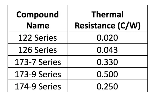

The next step is to review options for both thermal heat sink compounds and heat sinks. The table below details a few thermal heat sink compounds and their respective resistance, based on information from Wakefield Thermal Solutions.
While the lower thermal resistance is given by the 122 Series compound, but they are all at or below 0.5 C/W, so the 173-9 Series will be chosen as a worst-case scenario. Next, this thermal resistance value can be subtracted from the combined thermal resistances above to determine the proper thermal resistance for a heat sink. This is shown numerically below:
