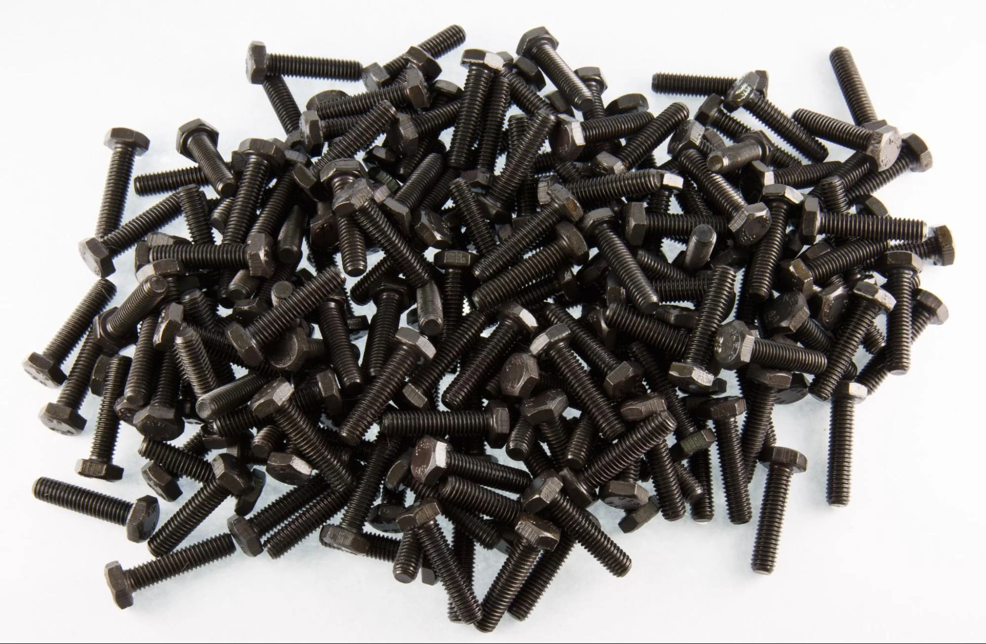

Industrial Applications
● Fasteners
● Low-friction bearings and wheel liners
● Cableway carriage sheaves
● Spacers
