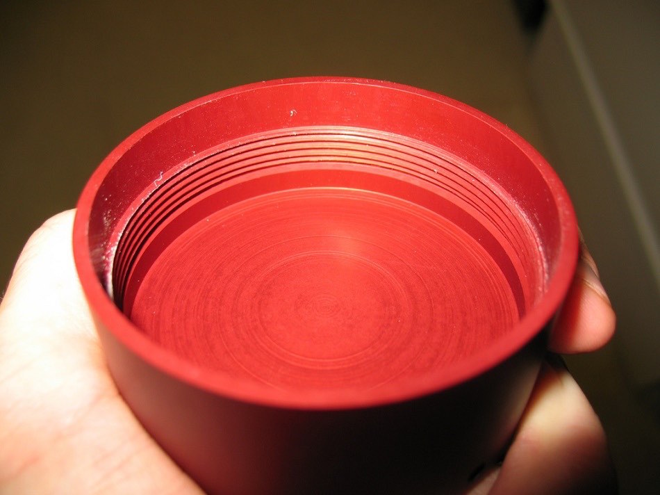

Anodizing
anodizing
Anodizing is a process used to increase the thickness of the natural oxide layer on the surface of metal parts, primarily those made of cnc aluminum. This process serves both functional and cosmetic purposes—anodizing a part will not only form a layer on the part’s surface to protect from scratching and corrosion, but parts are also left with a matte finish, and a variety of color dyes can be added during the process.
There are two main types of aluminum anodizing:
  • Type II adds corrosion protection, is only about 0.001” thick (meaning part dimensionality is virtually unchanged), and has a wide variety of color dye options.
  • Type III, also known as hard anodizing, provides a thicker (up to 0.006”) and more protective coating, but is more limited in color—often clear or black only.

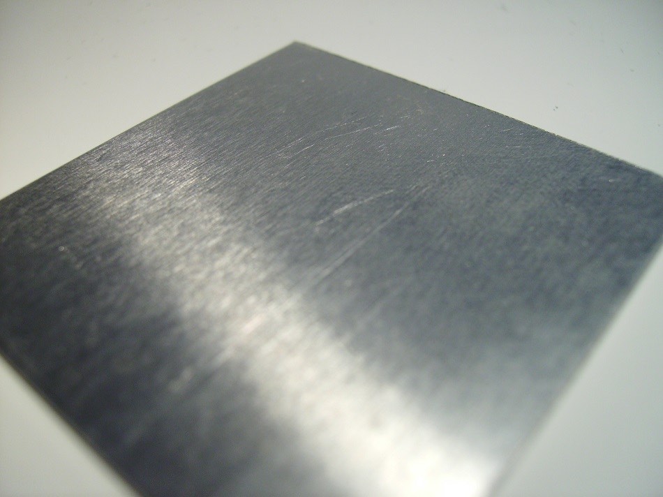

Brushing
brushed metal finish

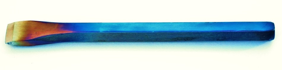

Heat Treating
heat treated metal
There are actually several types of heat treating, but all relate to the heating of metal in different ways and for different lengths of time to alter its properties.
The most common types of heat treatment done on finished parts (most often steel) result in an increased hardness of the part. This may be desired for a wide variety of functional reasons, such as long-term dimensional consistency or wear resistance.
A side effect of heat treatment is that it will leave the part surface with a dull gray surface finish.

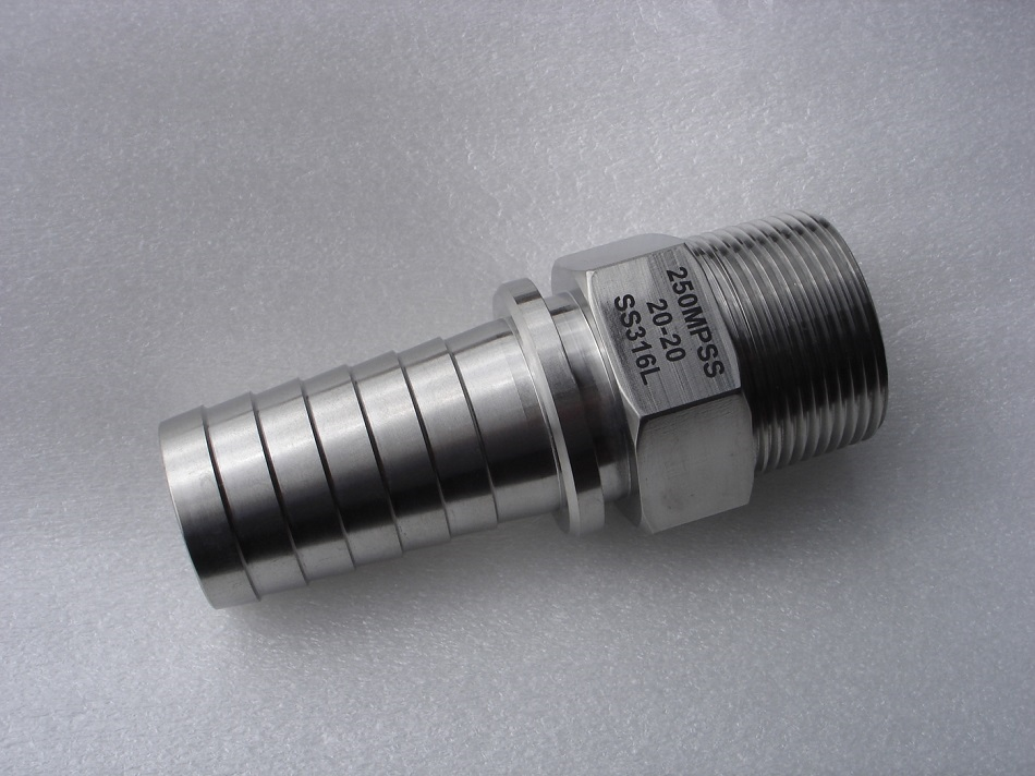

Laser Etching
laser etched metal
Laser etching or engraving works by utilizing—you guessed it—lasers, which operate at high frequencies to mark a part with text, symbols, a logo, or other patterns. Most metals, and many other materials, can be readily etching by tuning the laser appropriately.
A common use of this process is to label parts with serial numbers. Laser etching also works on anodized parts and will remove the anodized layer to expose the bare metal below, which is great for high contrast logos or patterns that pop.

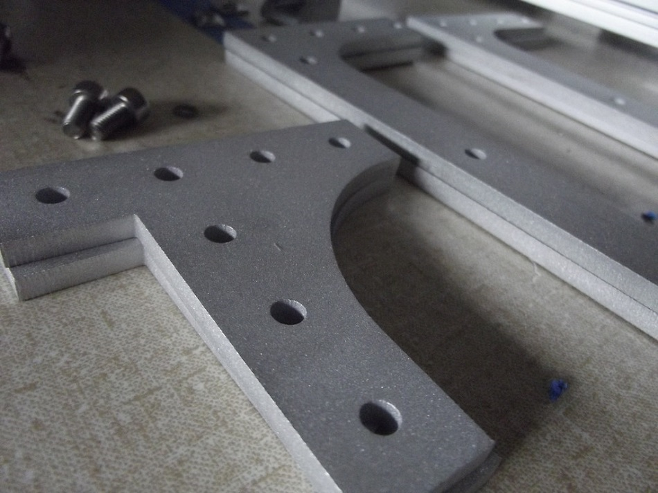

Media Blasting
media blasted metal
This is a cosmetic finishing technique that gives metal parts a matte appearance.
The “media” in media blasting can refer to several types of small granular materials, such as glass beads or aluminum oxide (sand). The material is fired at parts at a high velocity to apply a textured surface finish. In prototyping, this is done with a hand held spray nozzle, so the finish is not always as even as more automated blasting done during mass production runs.

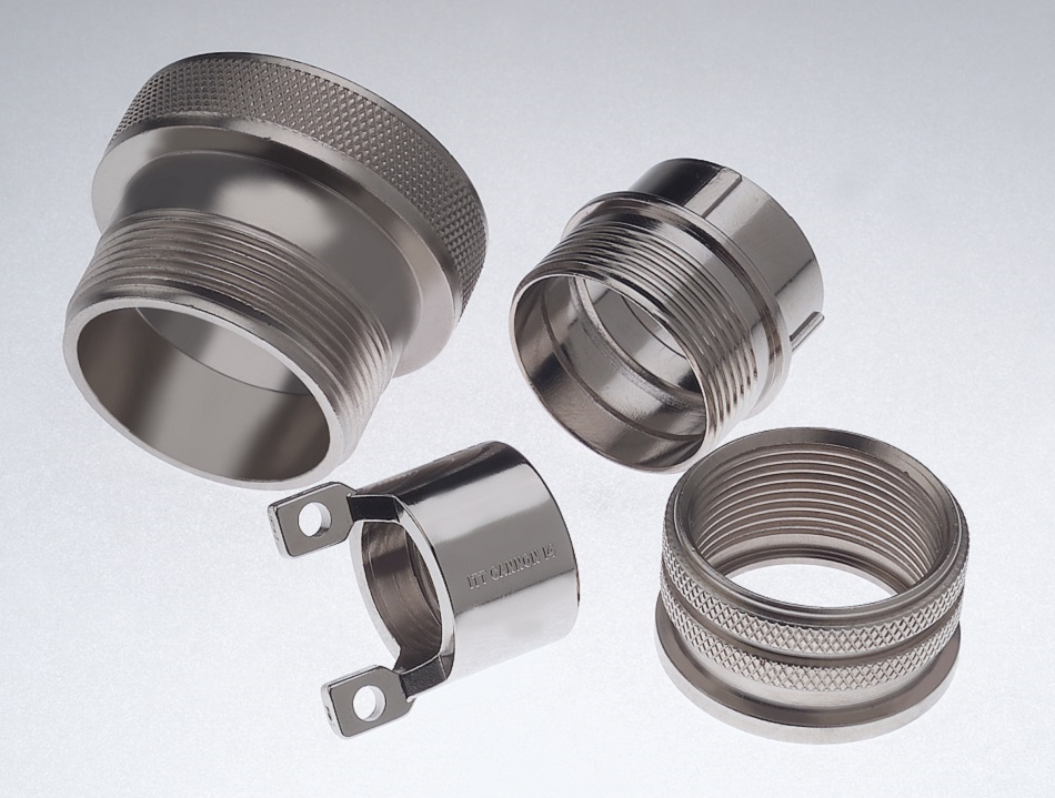

Plating
plated metal
Plating is a metal finish that involves coating a metal part with a very thin layer of another metal or metal alloy, in order to protect from corrosion and oxidation of the base part, or to change its cosmetic appearance. Tin, Nickel, Zinc (galvanizing), and Chrome are all common plating metals, while copper and carbon steel are two base metals that can benefit from plating.

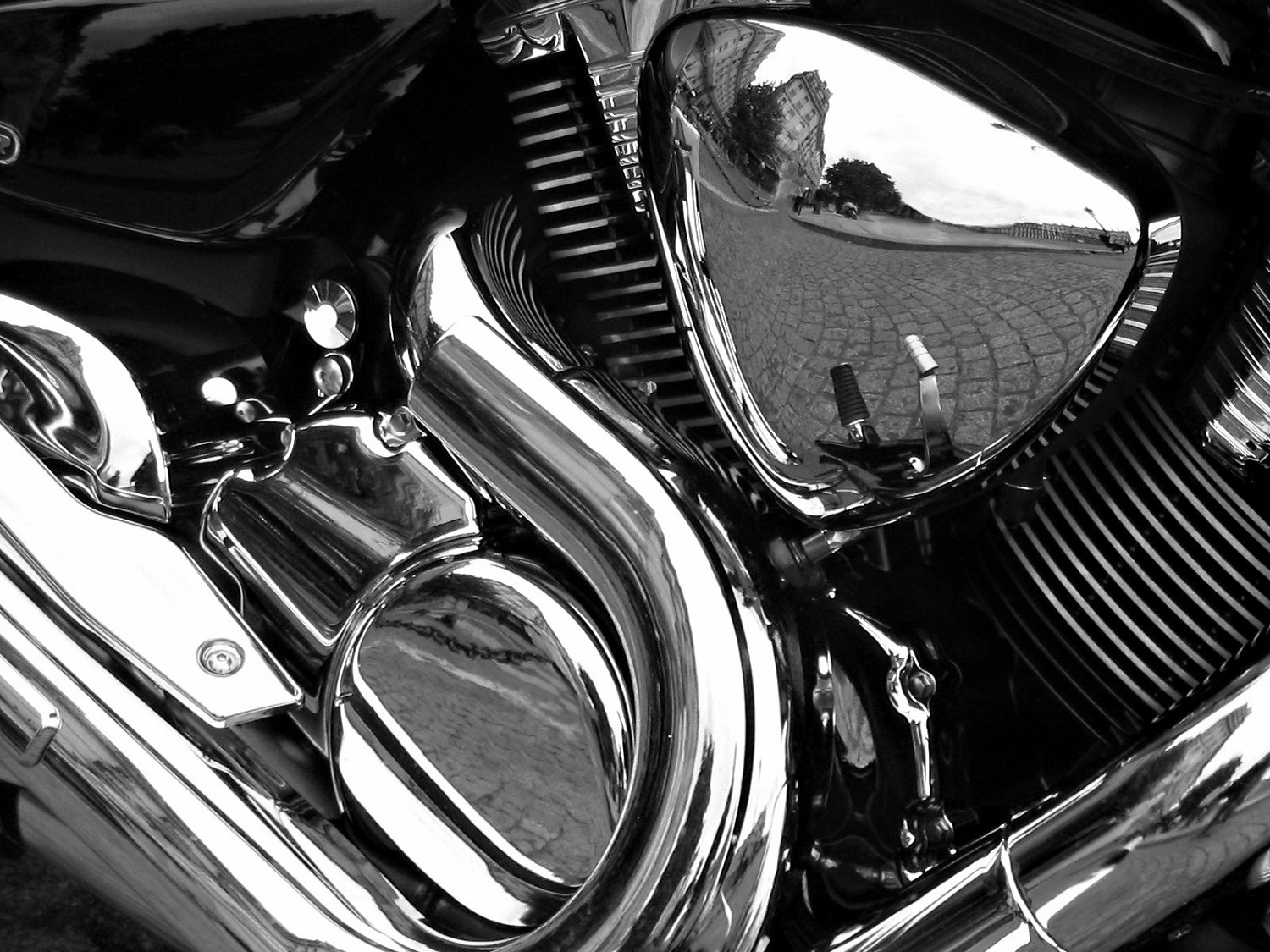

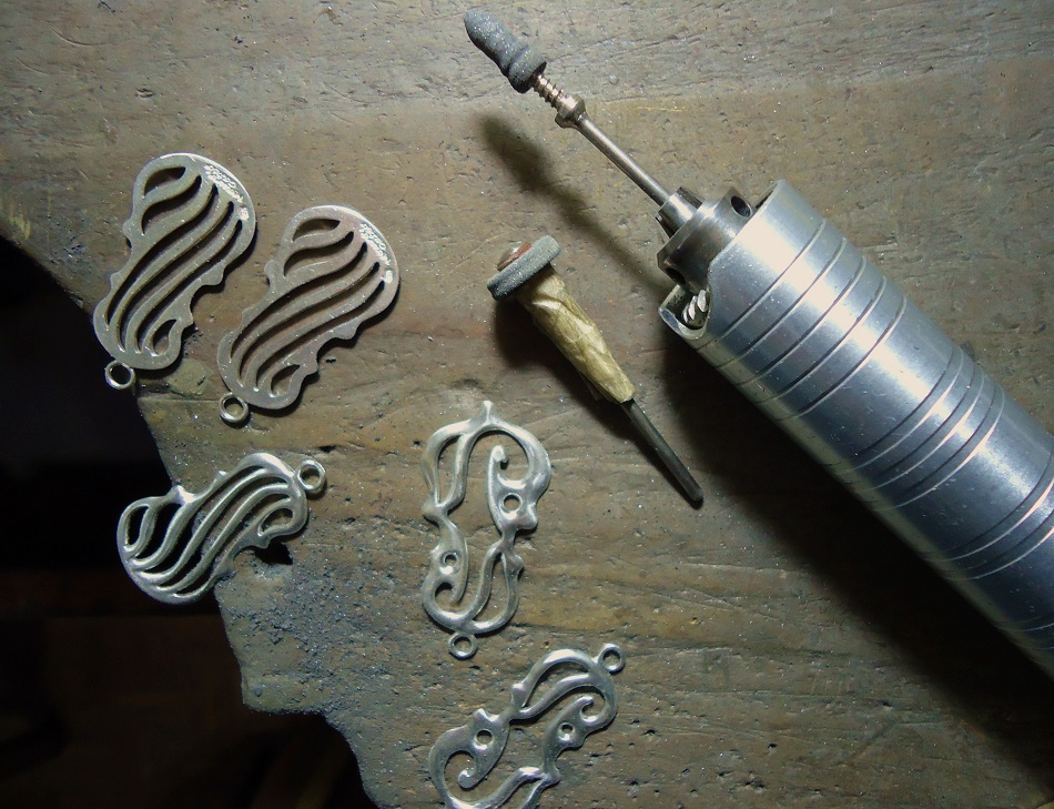

Polishing
polished metal
The next finishing step after sanding in terms of surface refinement. Polishing usually utilizes a buffing wheel or soft applicator and polish compound to bring a part’s surface a mirror-like or extra fine finish. Functional applications of this process include optical clarity or reflectivity of parts, and smoothing machined grooves or other features for sealing purposes.
Many metals can be polished, though with intricate geometries it can be tough to reach every surface, and harder metals such as 304 and 316 stainless steel can be time consuming and expensive to achieve a high-grade finish.
As an alternative to hand polishing and sanding, parts can be tumbled—where they are place in a large rotating drum, with or without an abrasive media. This drum rotates the parts for long periods of time to give them a refined surface finish. While selective finishing cannot be performed this way, and high levels of polish are not as readily achievable, it is usually more economical because parts can be tumbled in large batches and without operator oversight.

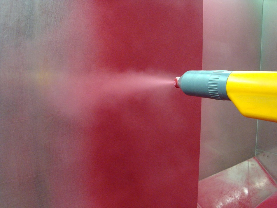

Powder Coating
powder coated metal
Powder coating of parts is done by applying a dry polymeric powder to a metal part using differences in electric potential.
Parts to be coated are electrically grounded; then, the powder is sprayed from an electrostatic gun or other source that induces it with a positive charge, causing it to stick to the part. Finally, the coated part is heat-cured, and voilá! A protective coating that comes in many colors.
One consideration: It will add thickness to your part, so dimensionality should be taken into consideration during part design, if possible.
