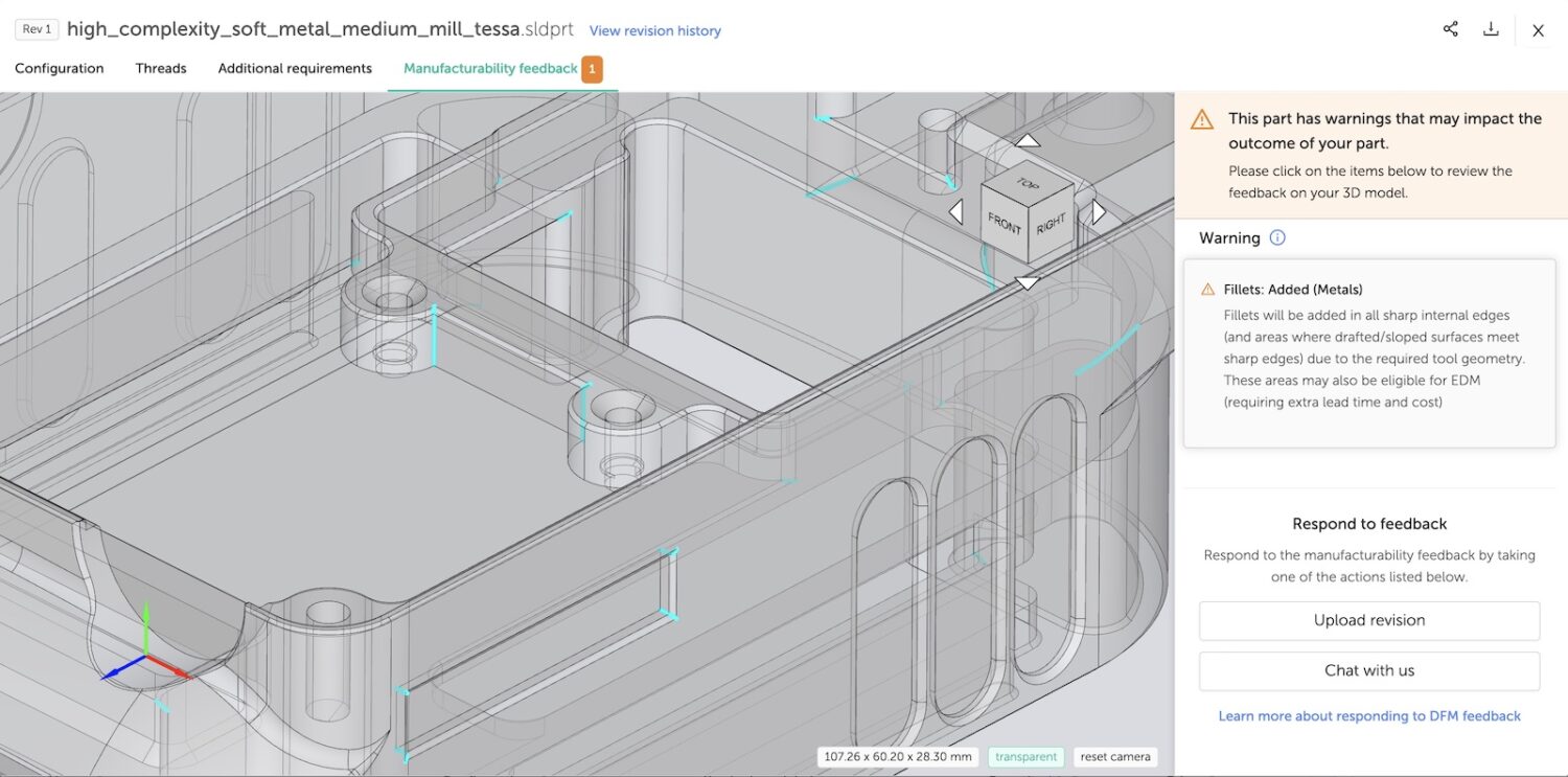

Internal Edges Between Planar Faces
To cut via high-speed rotation, all CNC tooling is round and axially symmetric, so cutting a square corner between two vertical walls is impossible. Any edge where two vertical walls meet at an angle less than 180° requires a fillet, and adding such fillets is the most common piece of DFM feedback we provide for CNC parts. Note: not all CNC mill tooling is axisymmetric (think fly cutters), and most CNC lathe tooling isn’t either.
Internal Edges Between Angled/Organic Surfaces
Edges between angled or organic surfaces with less than 180° between them also need fillets. If these edges aren’t perfectly vertical, they’ll be cut with a ball endmill, and the radius of that tool is the smallest fillet size that can be left between the surfaces.
Vertical Wall + Angled/Curved/Organic Surface
You also must include fillets when a vertical wall meets with an angled, curved, or organic surface below it. This example is tricky to comprehend, but if you picture a square or ball endmill cutting flush along a wall, you can visualize how there will always be material remaining between the wall and the surface below, unless that surface is perfectly flat and normal to the tool.

- Minimum Fillet Size
The smallest milling tool our vendors stock by default is a 1/32” endmill (square and ball). This is just under 0.8mm in diameter, meaning the smallest fillet it can create is 0.4mm.
- Fillet Size vs. Depth of Cut
Endmills come in lengths of standard multiples of their diameter, but there’s a limit to the obtainable length, due to tool vibration and chatter past a certain ratio. Material also plays a role here — it’s much easier to cut a deep pocket into a plastic or aluminum than into a harder material, such as steel. What this means is that fillets need to be a certain size, depending on how deep a cut is required to make the feature. Fictiv’s max depth of cut are as follows:- Steels: 5X tool diameter (10X fillet size)
- Plastics/aluminum: 10X tool diameter (20X fillet size)
Overall, we recommend sticking to 3-5X tool diameter max, to the avoid sticker shock caused by excessive machine time.
