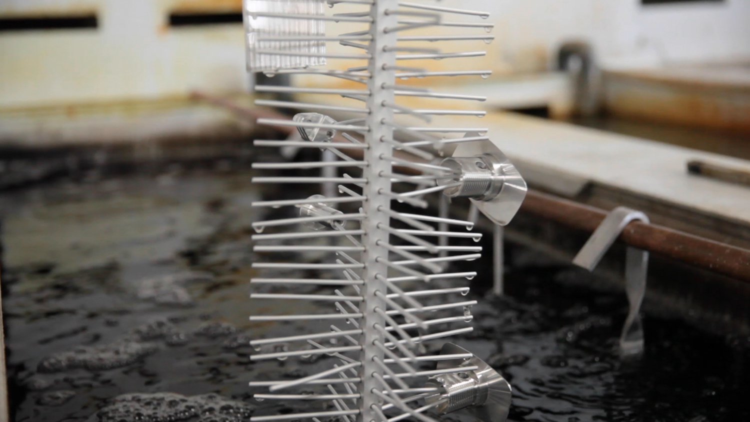

Next, electricity is used to drive the reaction and develop the coating. The name anodizing comes from the fact that the treated part forms an anode (positive electrode) in an electrical circuit. During this process, the part to be anodized is hung on a conductive rack, submerged in an electrolytic solution, and a direct current of electricity is introduced. While the acidity of the solution dissolves the oxide layer of the part, the electric current releases oxygen at its surface, which builds up a protective layer of aluminum oxide. By balancing dissolve rate with build-up rate, the oxide layer forms with nanopores, which allows continued growth of the coating beyond what is naturally possible.

The final step of the anodizing process involves sealing the nanopores, so they can’t become passageways for corrosion initiation. Just before sealing, the nanopores are often filled with other corrosion inhibitors (or colored dyes, as mentioned above). After the process is complete, the coating will be 0.0002-0.0012” in thickness, in accordance with the common engineering spec MIL-A-8625 Type II.
