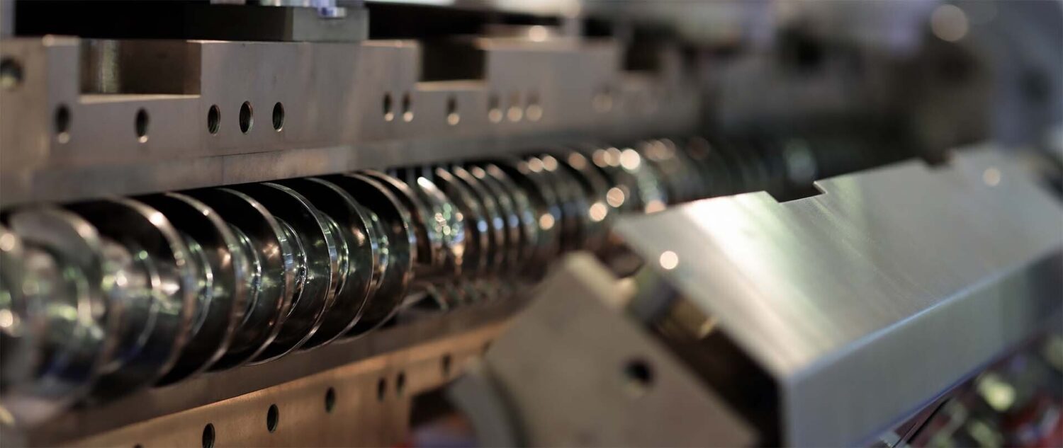

Extrusion is a proven process that molds continuous lengths of plastic and rubber so they have uniform cross-sectional shapes. These profiles can be as simple as a tube or cord but are sometimes more complex. For example, door and window seals can be extruded into shapes that resemble the letters D, E, J, P, or U. Typically, the extruded profile or extrudate is cut into lengths or individual parts.
Extruding machines can produce solid, semi-hollow, or hollow profiles with a smooth surface finish. First, plastic or rubber is fed into a hopper. Hot extrusion heats the polymer above its recrystallization temperature but cold extrusion is performed at room temperature instead. This material is then conveyed with a screw and forced through a machined metal die under high pressure to achieve the desired shape.

A well-designed die ensures the even flow of material across the entire profile. Feed rate control can also optimize flow consistency. Importantly, the screw needs to have the correct compression ratio and flight geometry based on the material’s properties. Adjusting the back pressure and the screw speed helps to control the melt pressure and ensures steady material output without degradation.
