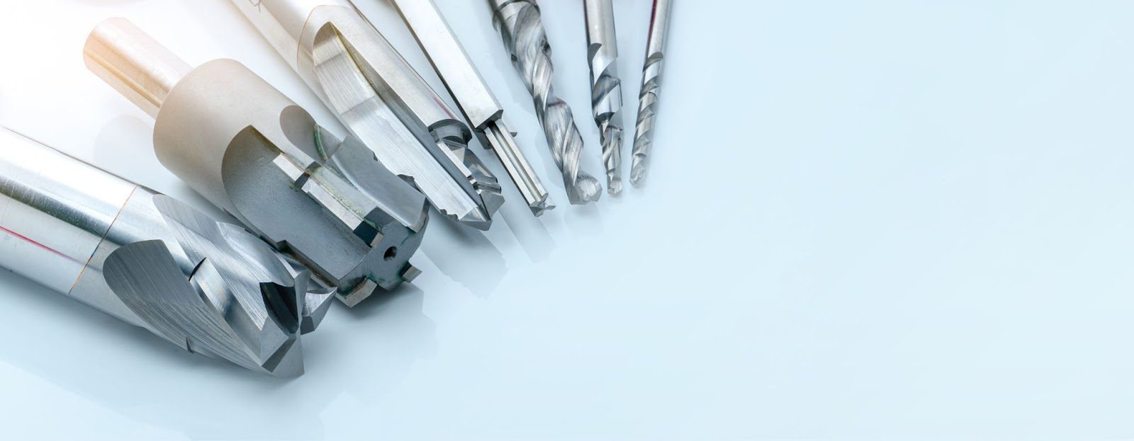

Materials with high Young’s Modulus are firm and resist distortion and require a higher load for a resulting strain to occur, making them reasonable for load-bearing applications. Here are some examples of materials with high modulus of elasticity¹:
  • Diamond has the highest elastic modulus of any known material due to its high valence electron density (1220 GPa)
  • Tungsten carbide for similar reasons as diamond (450-650 GPa)
¹At standard room temperatures, unless otherwise noted; values for educational purposes only. Always consult material data sheets for specific properties for your material
  • Sapphire (435 GPa)
  • Beryllium (287 GPa)
  • Chromium-Molbydenum Steels like 4140 (213 GPa)
  • 316 Stainless steel (195 GPa)
Low Young’s Modulus materials are adaptable and are utilized where deformity is beneficial — like gaskets and o-rings. An example of a material with a low modulus of elasticity is silly putty. Poisson’s Proportion influences the way the material behaves during pressure or extending. Materials with low Poisson’s Proportion contract less along the side, prompting clasping.
tungsten carbide CNC tools
