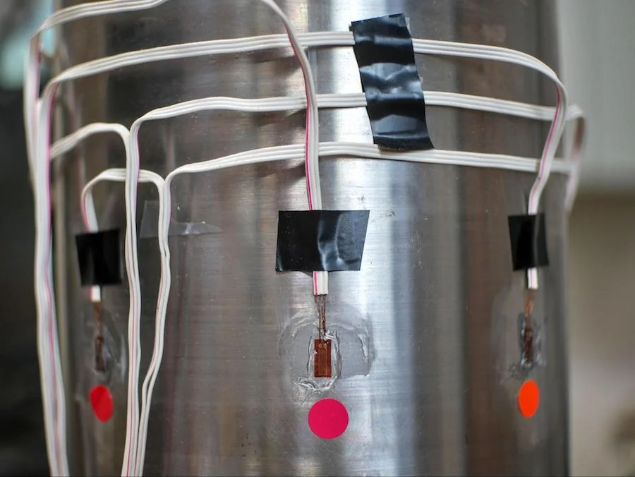

strain gauges on a test specimen

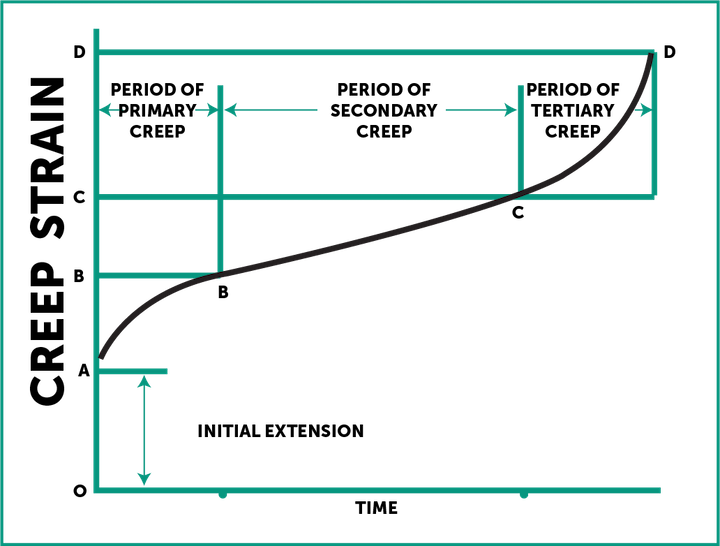

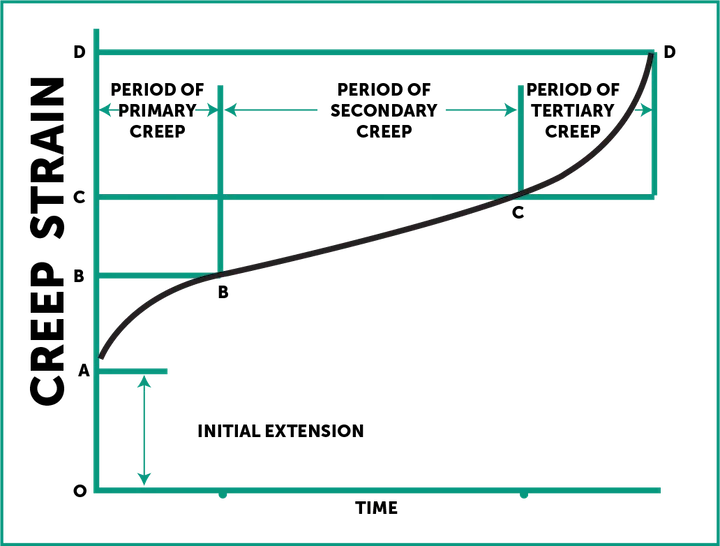

Phases of Mechanical Creep: Creep Graph
As there are stress vs strain graphs for materials in which we find the yield strength, ultimate tensile strength, and failure point, there are similar graphs for mechanical creep. These creep graphs show that mechanical creep happens in three stages: primary, secondary, and tertiary.
mechanical creep graph showing phases of mechanical creep deformation
Here’s an explanation of the graph and creep phases:
  1. In the initial extension, from point O to A on the y-axis, the applied stress isn’t significant enough to cause creep and there is no measurable deformation of the test piece.
  2. Primary creep, from point A to B on the y-axis, is a transition where the rate of creep and deformation of the material decreases over time (slope decreases as time goes on).
  3. A constant, linear creep rate characterizes secondary creep, from point B to C on the y-axis. This creep phase can last a while — sometimes 10+ years.
  4. Tertiary creep is the final phase, from point C to D on the y-axis, that involves a rapidly increasing creep rate until material failure. During this period, the effective stress on the material increases due to microstructure changes within the material, and results in permanent deformation.

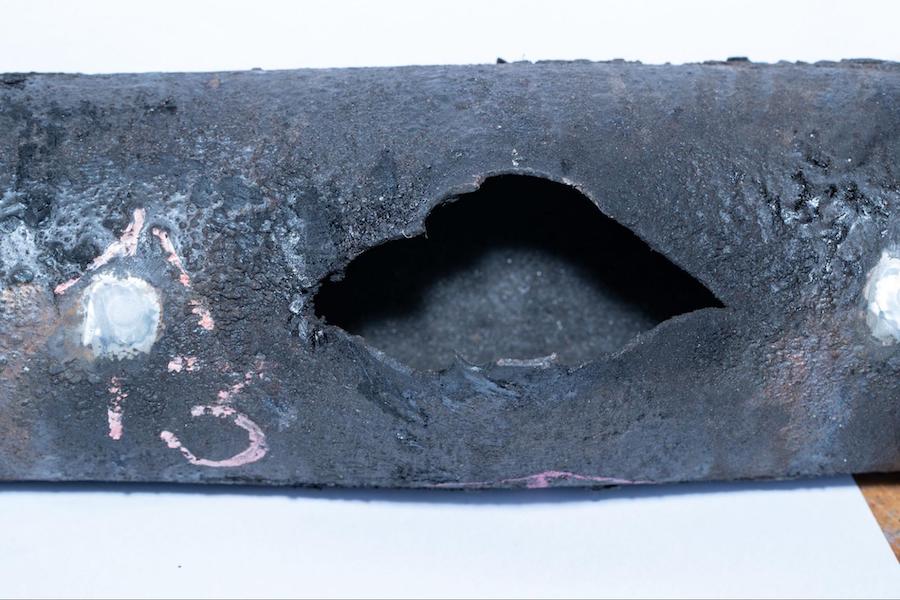

failed heater tube likely due to creep
