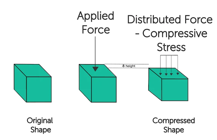

And as shown above, an applied force downward on the surface results in a distributed load, or compressive stress, that changes the height of the object (the dimension parallel to the force applied). This change in height is strain, so stress results in strain.

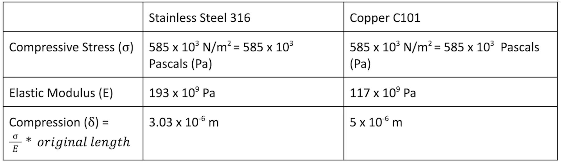

Compressive stress is dependent on the object’s geometry. The force applied to the object and the response to compressive stress is heavily dependent on Young’s Modulus or elastic modulus of a material (the ability of a material to resist deformation when subjected to stress). For example, consider what happens when a 292.50 KN (Kila-newton) weight is placed on the block illustrated below, which has a surface area of 0.5 m2. Now consider the difference between a block made of 316 stainless steel and one made of copper C101 shown in the table below
So, if geometry and loading conditions remain the same:
