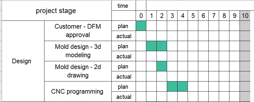

Gantt Chart for Injection Molding Design
Enclosure design requires the engineer to follow some best practices to ensure the success of the final product. When designing a custom electronic enclosure for injection molding, keep the following considerations in mind:

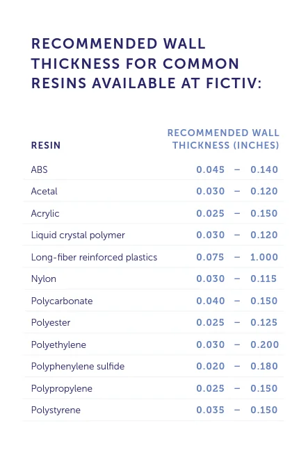

Resin type vs recommended thickness
Wall Thickness is Critical to Design for Injection Molded Parts

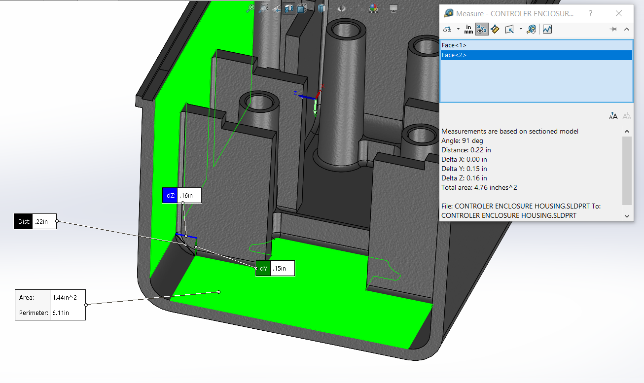

Wall thickness is critical to the success and functionality of your design for injection molding. Wall thickness can influence many important factors, including cosmetics, mechanical performance, and cost to manufacture. To avoid delays in production scheduling, engineers need to design the enclosure with the proper wall thickness and ensure the right fit when it comes time for prototyping and manufacturing.
Further, it’s important to remember that the nominal wall thickness will be determined by the functional performance requirements of the enclosure. Establishing a nominal wall thickness depends on the enclosure’s expected service life and the amount of stress it must withstand. Enclosure walls that are too thin risk creating unforeseen air traps or other manufacturing issues. Similarly, walls that are too thick will be higher in cost because of greater material usage and longer cycle-times.
To avoid increasing costs, it’s best to maintain a consistent wall thickness throughout the entire part. A consistent wall thickness also allows for the turbulence-free flow of plastic resin — bear in mind that as plastic resin enters the mold cavity, it tends to flow into the part’s thicker regions.
Additionally, wall uniformity helps to avoid warping, sinking, and voids whiled improving mold fill. Variations in wall thickness will also cause the part to cool at an inconsistent rate, which increases cycle times and increases the likelihood of issues. Because plastics are poor conductors of heat, uniform thickness across the enclosure design ensures that the molten material cools uniformly and shrinks evenly as it solidifies. If it’s not possible to keep a uniform thickness in your design, you have several options to get quality parts.

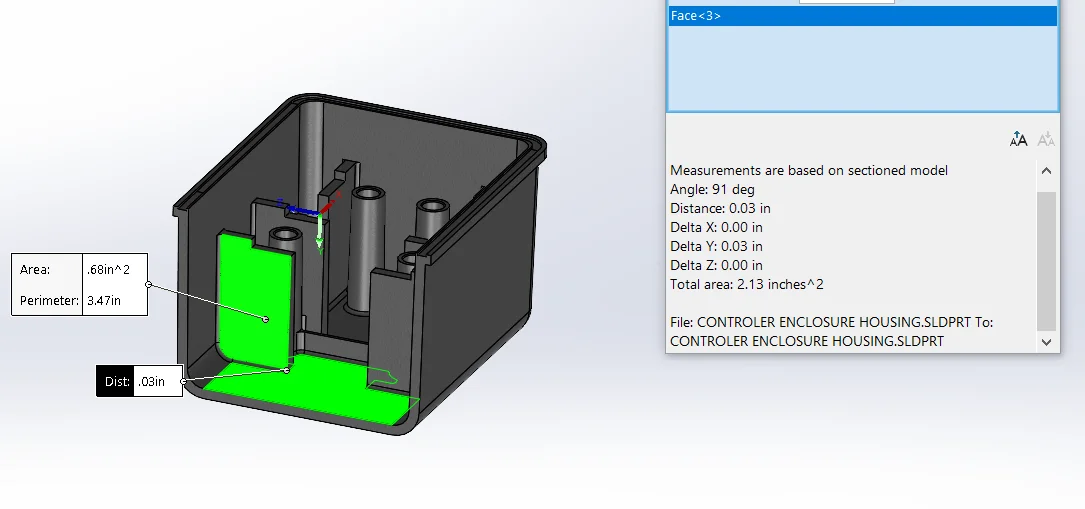

Because wall thickness is one of the most important factors in enclosure design for injection molded parts, the use of bosses and ribs to increase the structural integrity of thinner-walled areas is common. Designing to improve the stiffness of the enclosure can reduce the amount of material required to make the part. This also reduces the cycle time, resulting in a more cost-effective part.
Incorporating ribs is a critical feature that should be considered for nearly all enclosures. Incorporating inner ribs will reinforce the overall structure, especially where attachment points are located.
Typically, plastic injection molded parts are designed to have a uniform wall thickness, but this rule can be broken when ribs are added. For example, injection molded wall thickness is usually in the range of 50%-75% of the nominal wall thickness. The bottom of the rib must feature a fillet that is somewhere near 0.25T-0.5T, where T is the nominal wall thickness. This radius should not be smaller than 0.010 inches.
It’s also important to keep the ribs as short as possible and to apply a minimum of 1 degree draft angle. Ideally, the height of the rib should not exceed 2.5T. Commonly used draft angles are somewhere between 0.5 degrees to 1 degree per side.

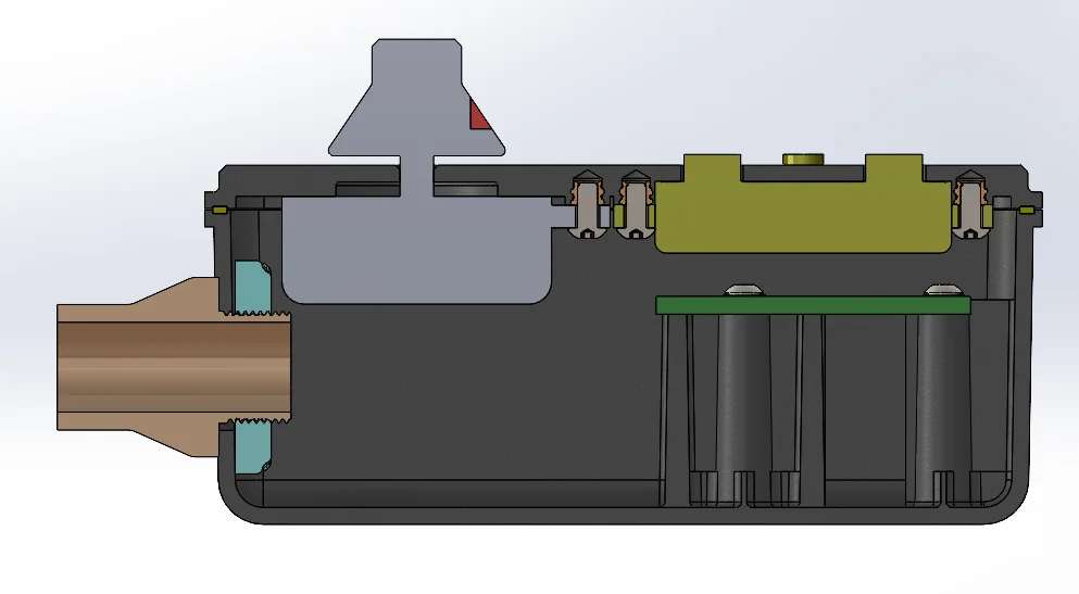

Our example plastic enclosure design pictured below incoporates ribs in the upper section where a printed circuit board (PCB)  will be attached. This is also the location of the directional controls that will take repeated compressive loads. FEA (finite element analysis) should be used to simulate when the loads will occur, the magnitude of these loads, and the wall thickness required for the ribs.
Reinforcement ribs are designed to strengthen attachment bosses and upper enclosure structure
