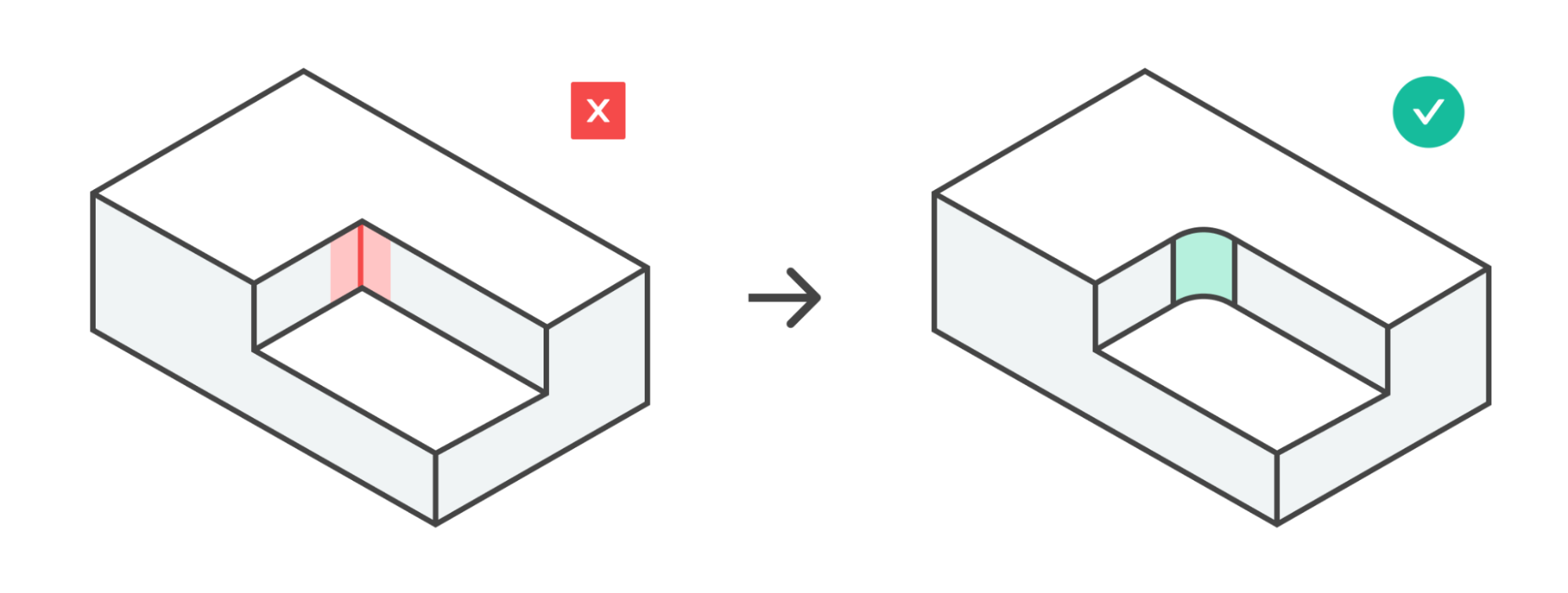

Fillets to be added
a graphic showing a fillet being added to a part
Explanation
Fillets will be added to sharp internal corners or areas where drafted or sloped edges meet sharp edges. Otherwise, these features are impossible to machine.
Action Step
If you want to specify radii on your fillets, you can add them to your design. Otherwise, the manufacturer will use their discretion to add fillets to these areas.

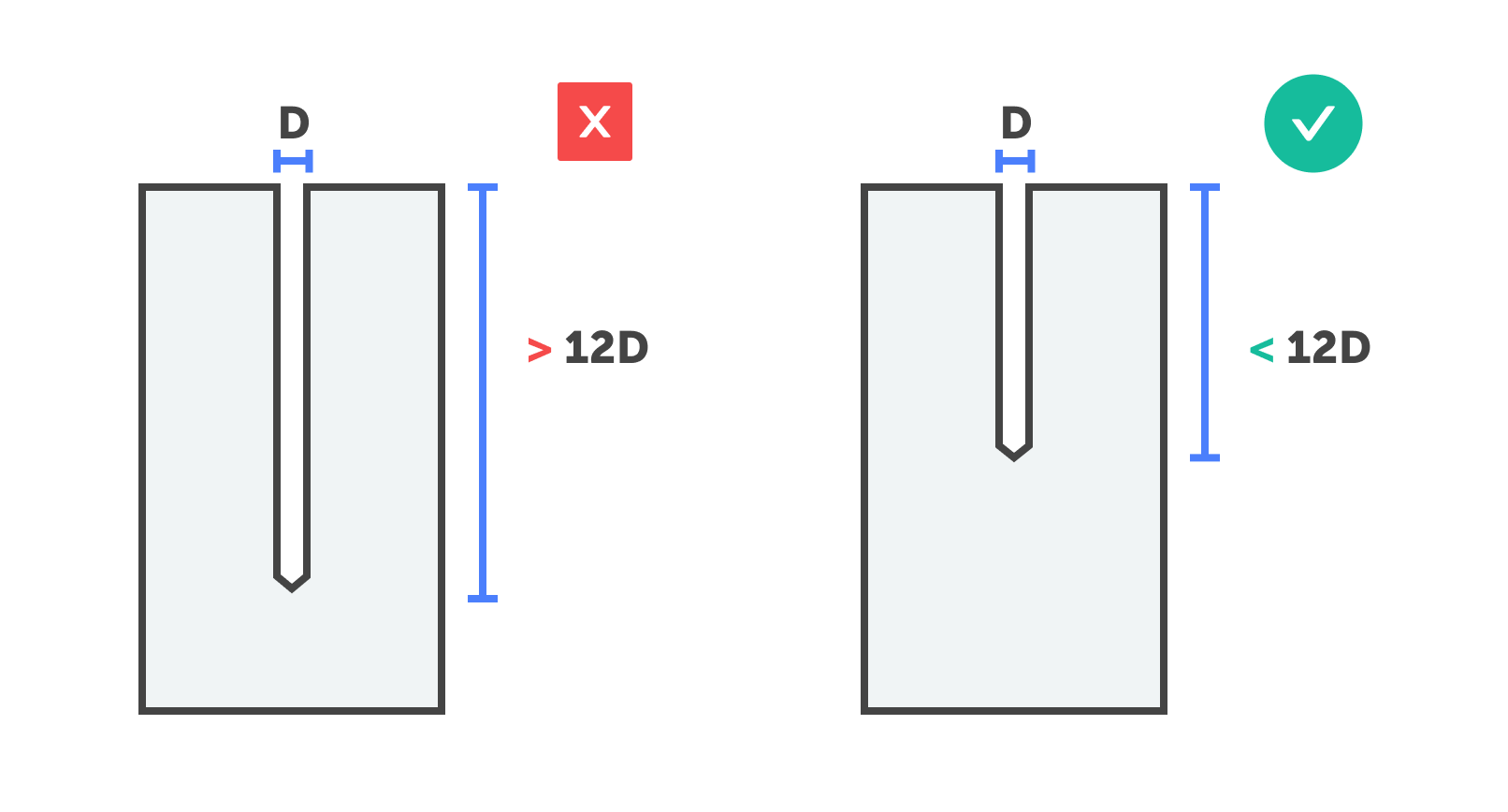

Depth of hole (drilling)
on the left, a part with a drilled hole that is greater than 12D and a red X, on the right a part with a hole that is less than 12D and a green check mark
Explanation
If the depth of a hole in your part is greater than 12x the nearest bit diameter, we will not be able to machine your part. Drills that are greater than 12 times the diameter of the bit are hard to source and may break during drilling. If you increase the diameter of the hole, a larger drill can be used, which would mitigate the issue.
Action Step
If the hole is a blind hole and is too deep to be drilled, you can try to decrease the depth of the hole or increase the diameter of the hole. The ratio of depth to diameter needs to be less than 12.

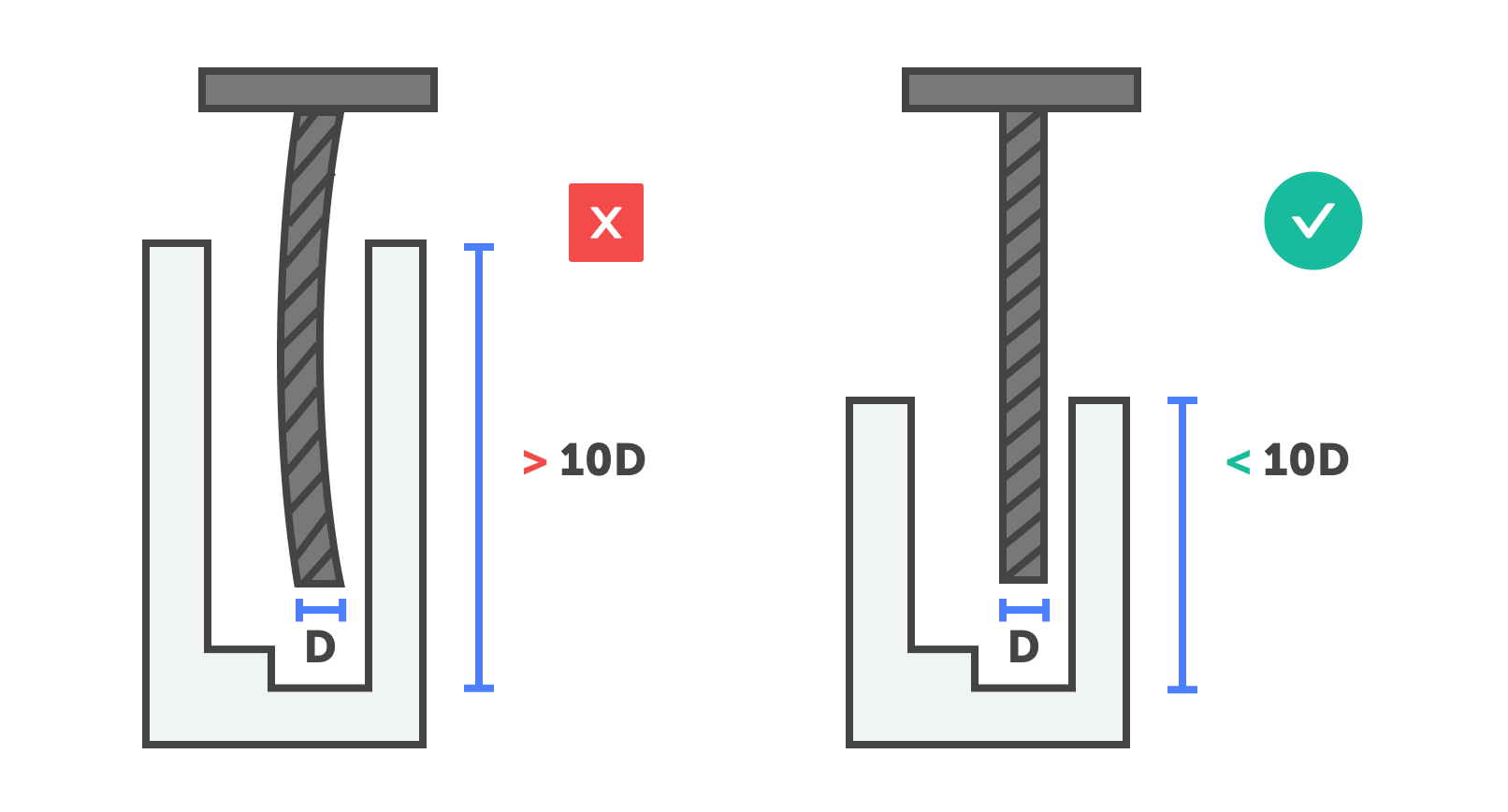

Depth of cut (milling)
on the left, a part with a deep pocket labeled as greater than 10D and the tool is bending. on the left a part with a pocket that is less than 10D and the tool is straight
Explanation
If the depth of a feature in your part is greater than 10x the diameter of the end mill used, we will not be able to machine your part. End mills that are greater than 10 times the diameter of the bit are hard to source and may break during use. This may occur if you have thin but deep features such as slots or grooves.
Action Step
If you can, decrease the depth of the feature. Otherwise, increase the feature diameter or the corner radius (fillet), which will allow a larger diameter tool to be used. This in turn allows a longer tool.

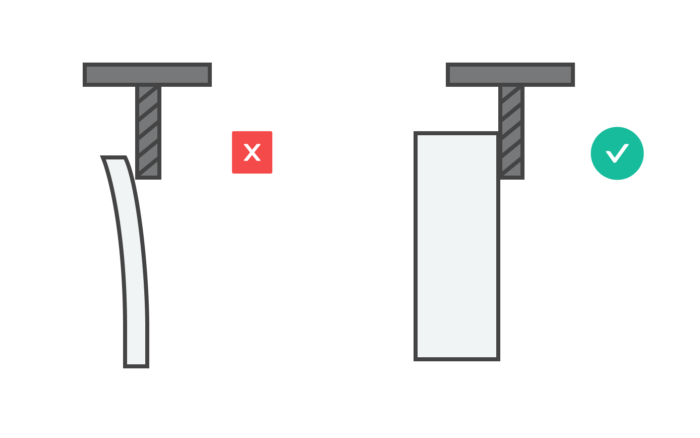

Thin walls may not hold up to machining
one part on the left is thin and bending in contact with a tool, on the right the part is thick and not bending in contact with the tool
Explanation
Our minimum required thickness is 0.25mm for metals and 0.50mm for plastics. If the wall is any thinner than this, they will not hold up to the manufacturing process. The material may warp, deform, or break altogether. To move ahead with manufacturing, you will have to update the wall thickness to be above the minimum.
Action Step
The minimum required thickness is 0.25mm for metals and 0.50mm for plastics. Update your design to be above the minimum thickness of your material.

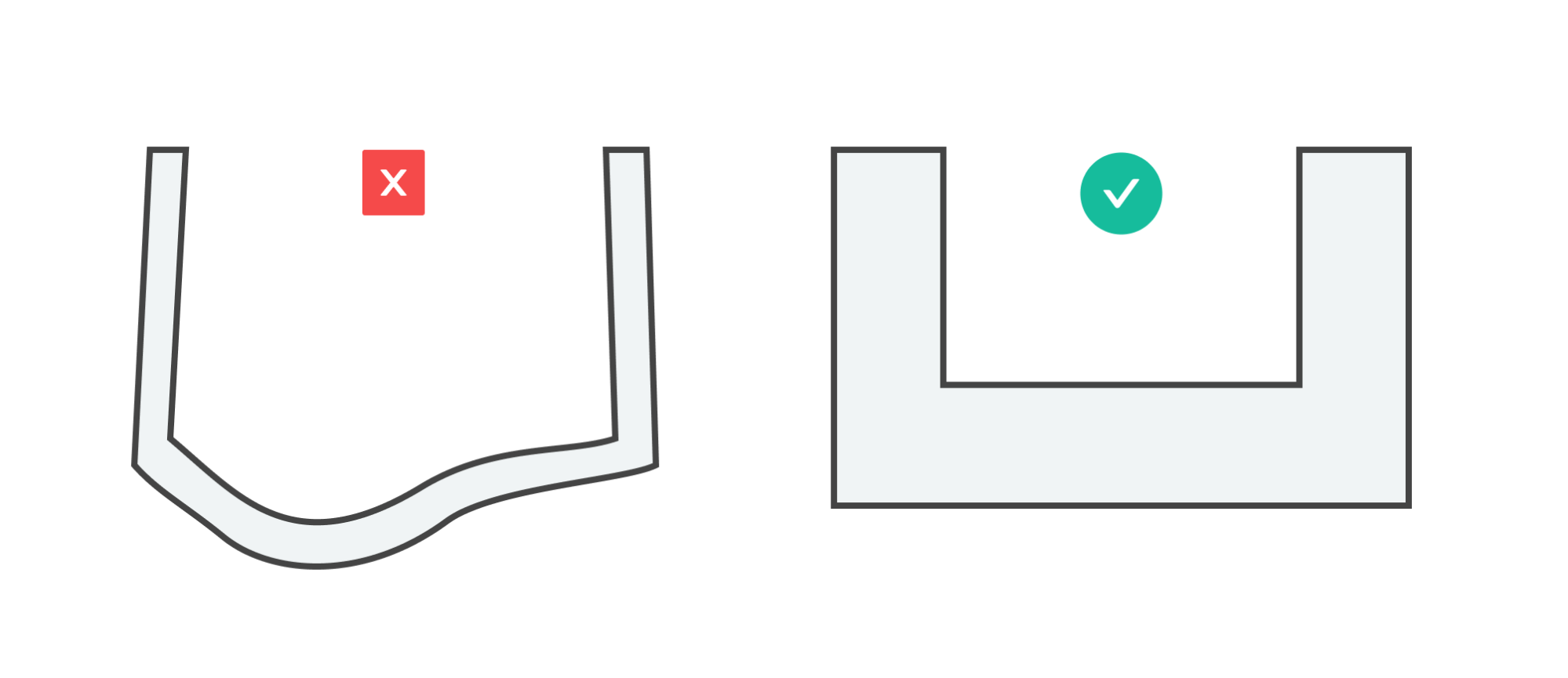

Warping may occur if too much material is removed
a graphic showing 2d parts, one with thin walls that is warped and the other with thick, straight walls
Explanation
Removing a large amount of material from a part puts a lot of stress on the workpiece, causing warping when the part is removed from the machine.
Action Step
Evaluate the design of your part (is it best suited to CNC machining?) and the geometry of the final part (thin walls). Add to the wall thickness or consider changing the manufacturing process.
