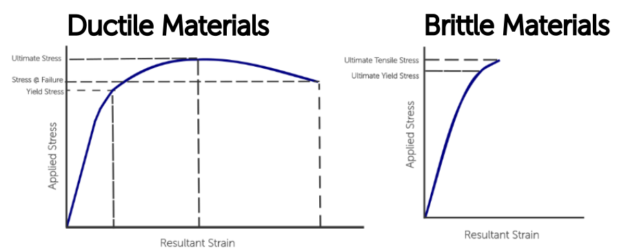

Because of this low strain value before failure, brittle materials do not exhibit plastic deformation before failure — they fail only after a small amount of elastic deformation as compared to ductile materials, which do exhibit plastic deformation before failure. You can see the stress vs strain curves of brittle and ductile materials below:
brittle vs ductile material stress vs strain curves
