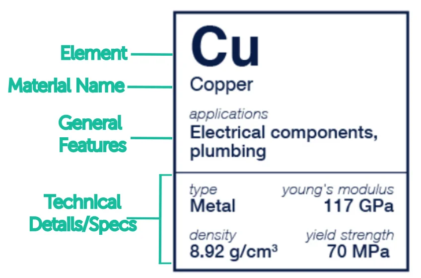

In chemistry, copper is known as Cu on the periodic table and has an atomic number of 29. It is a reddish, nonferrous metal that is one of the “transition metals” alongside silver and gold. Copper’s high electrical conductivity makes it a great option for use in electronics. Additionally, copper is ductile and malleable, making it a versatile material that can be shaped into wires, tubes, and other forms relatively easily while maintaining its mechanical strength.

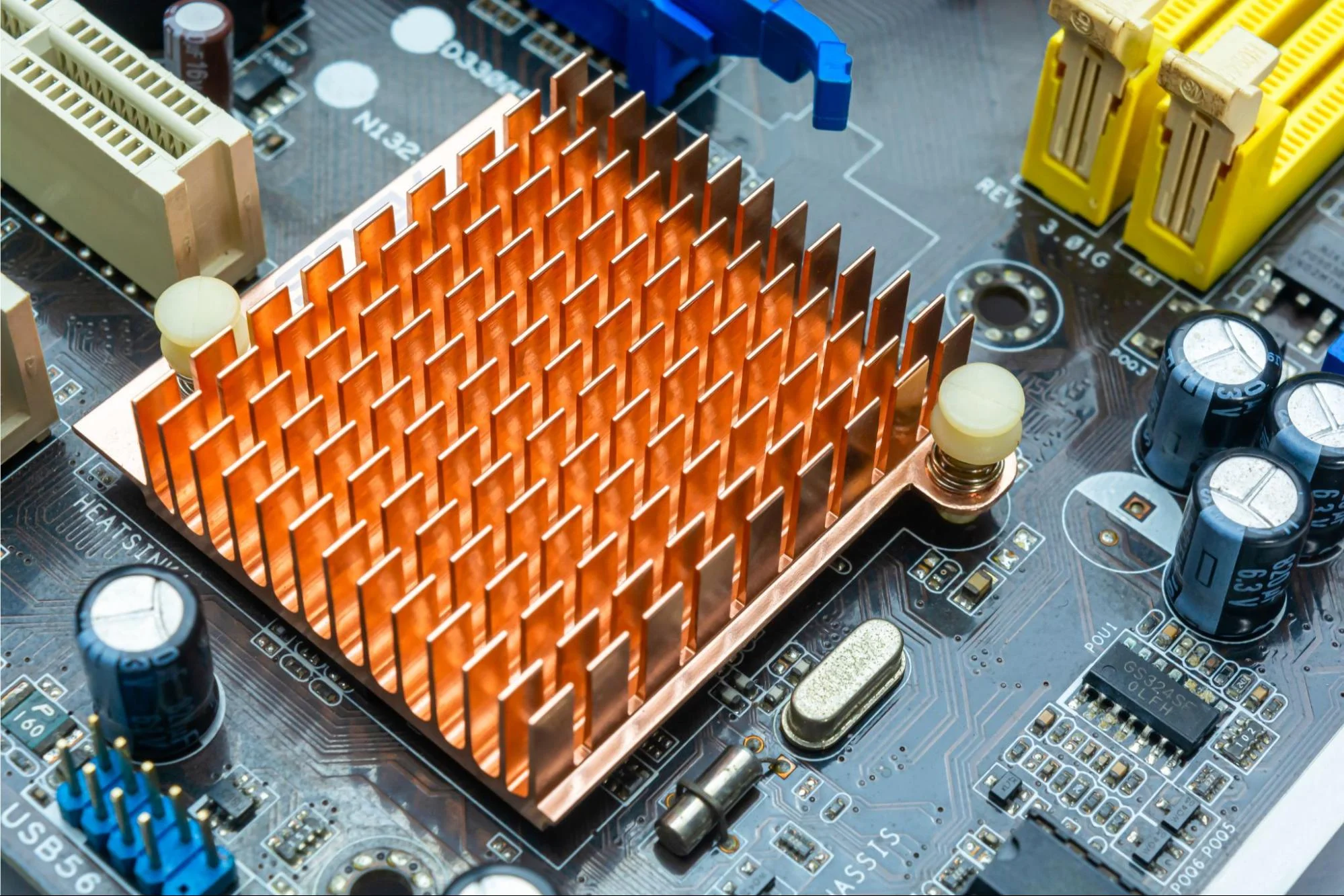

  • Thermal Conductivity: Copper’s use in mechanical parts and products is often attributed to its heat dissipation capability. Because copper’s thermal conductivity is higher than that of other metals with similar strength, it can be used in heat exchangers, such as radiators. This property improves efficiency in several mechanical systems and reduces overheating risks.

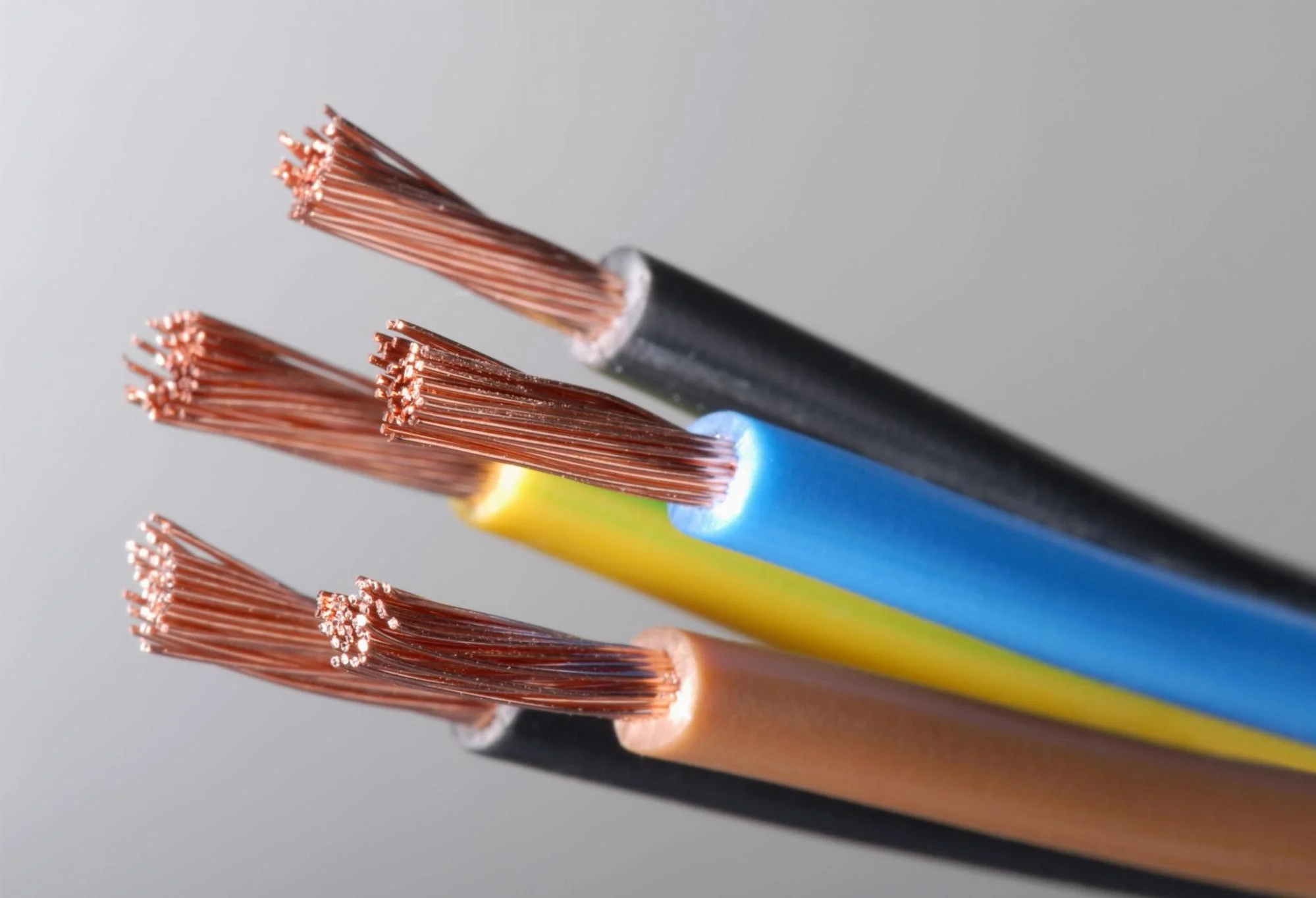

  • Electrical conductivity: Copper is known for its exceptional electrical conductivity, making it a preferred choice for electrical wiring and components. Its ability to efficiently conduct electric current is second only to silver, but due to its cost-effectiveness and availability, it is often used as the standard for electrical applications.

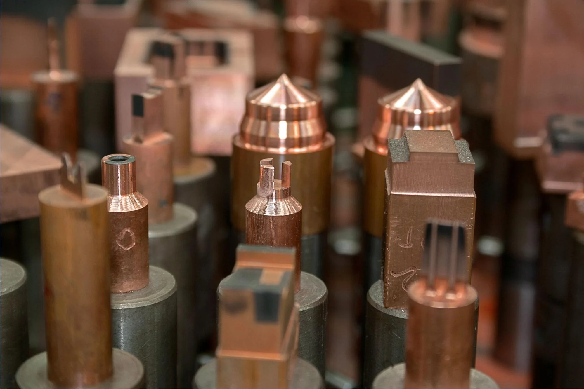

Copper is also used as an electrode in Electrical Discharge Machining (EDM), which allows for precise machining even in small areas. EDM is particularly useful in creating and modifying tools for injection molding.

 Copper is often used as an electrode in electrical discharge machining (EDM).

  • Electrical Wiring: The major application of copper in electrical wiring used in homes, buildings, and electrical grids gives it the widest application area. The high electrical conductivity of the material allows the transmission of electricity at very minimal energy losses.

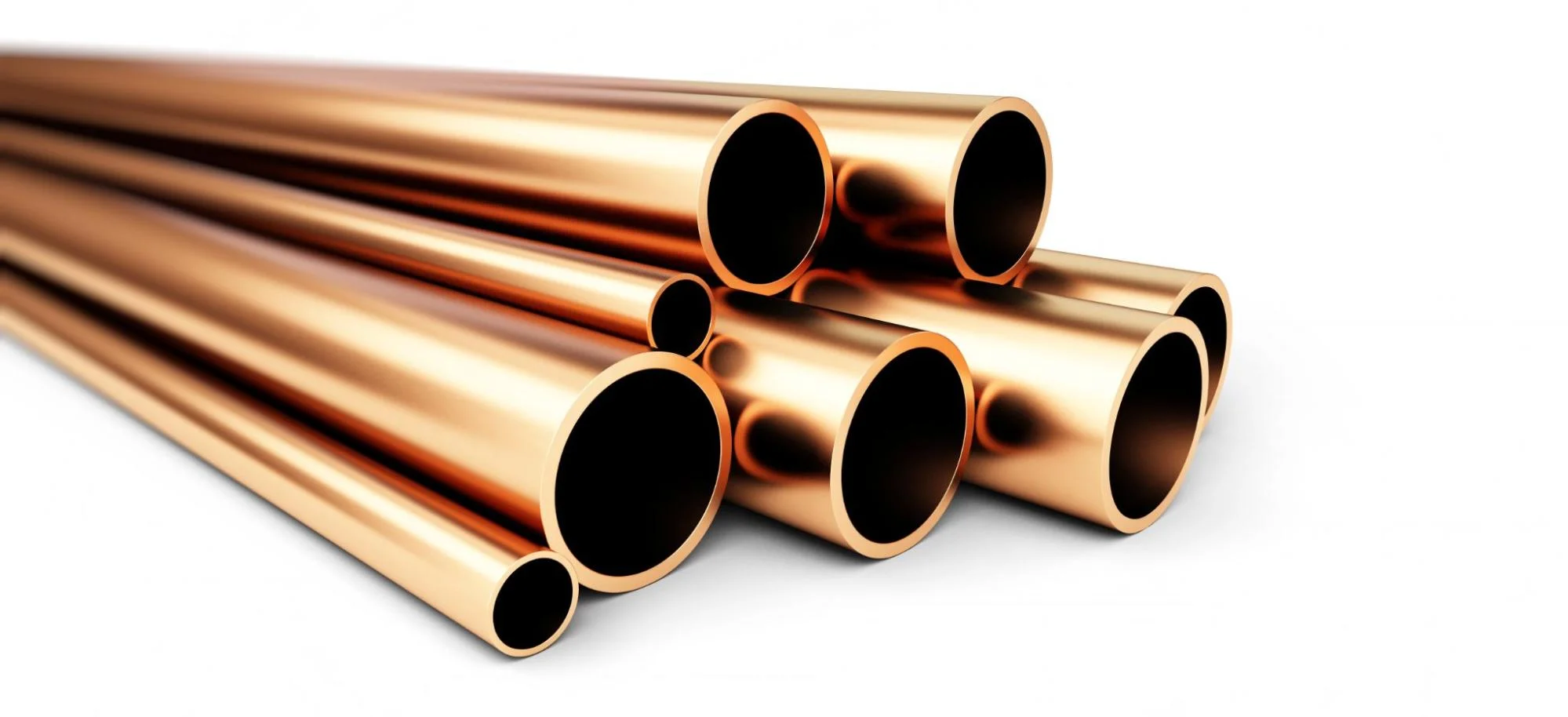

  • Pipes: Antimicrobial properties further copper’s suitability for use in water pipes, filtration systems, and zero-level contamination water transfer.

A copper heat sink on a computer motherboard

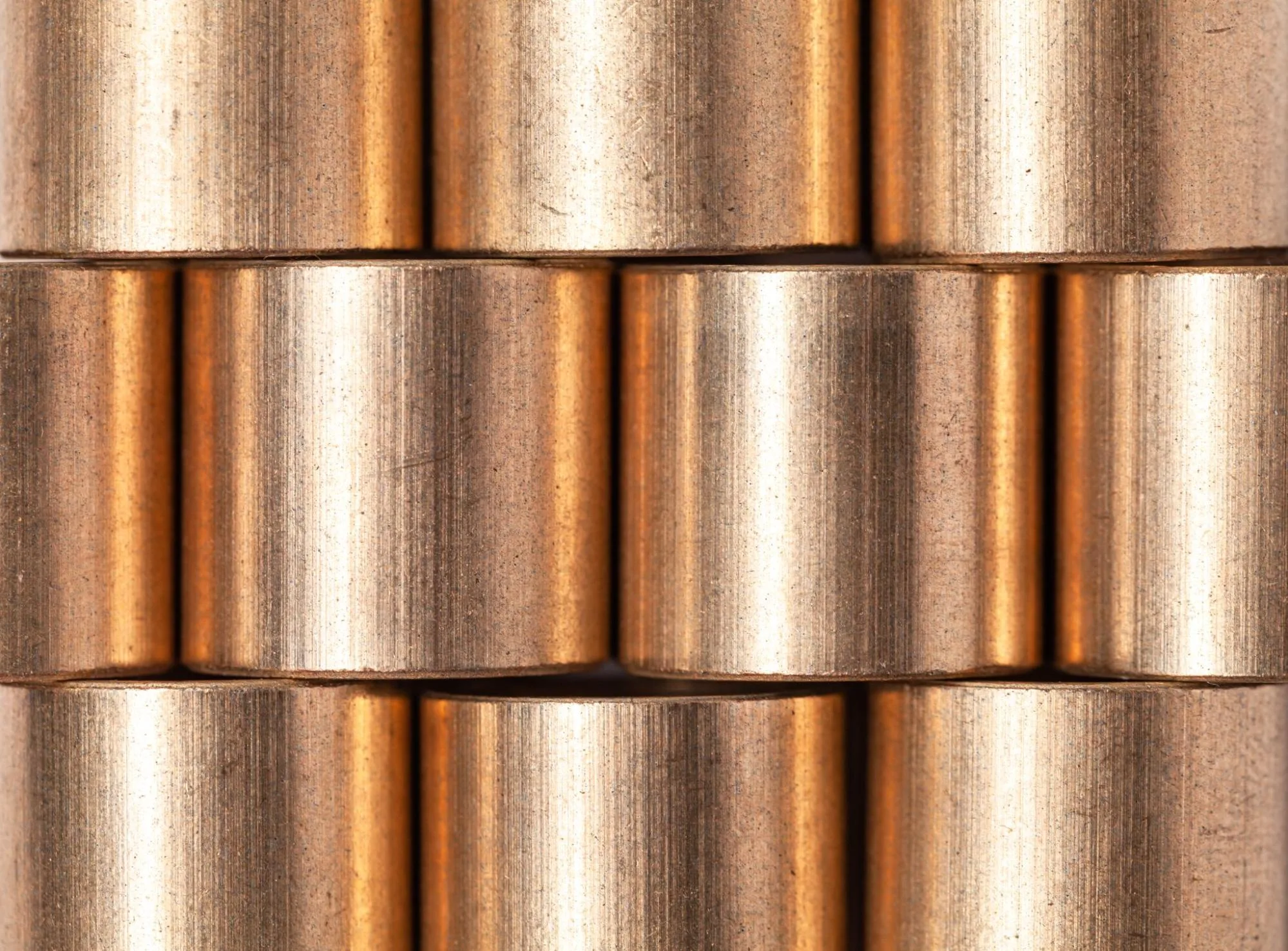

Bronze is a copper alloy commonly used to make bearings

  • Bronze: Includes phosphor bronze, leaded phosphor bronze, aluminum bronze, and silicon bronze
