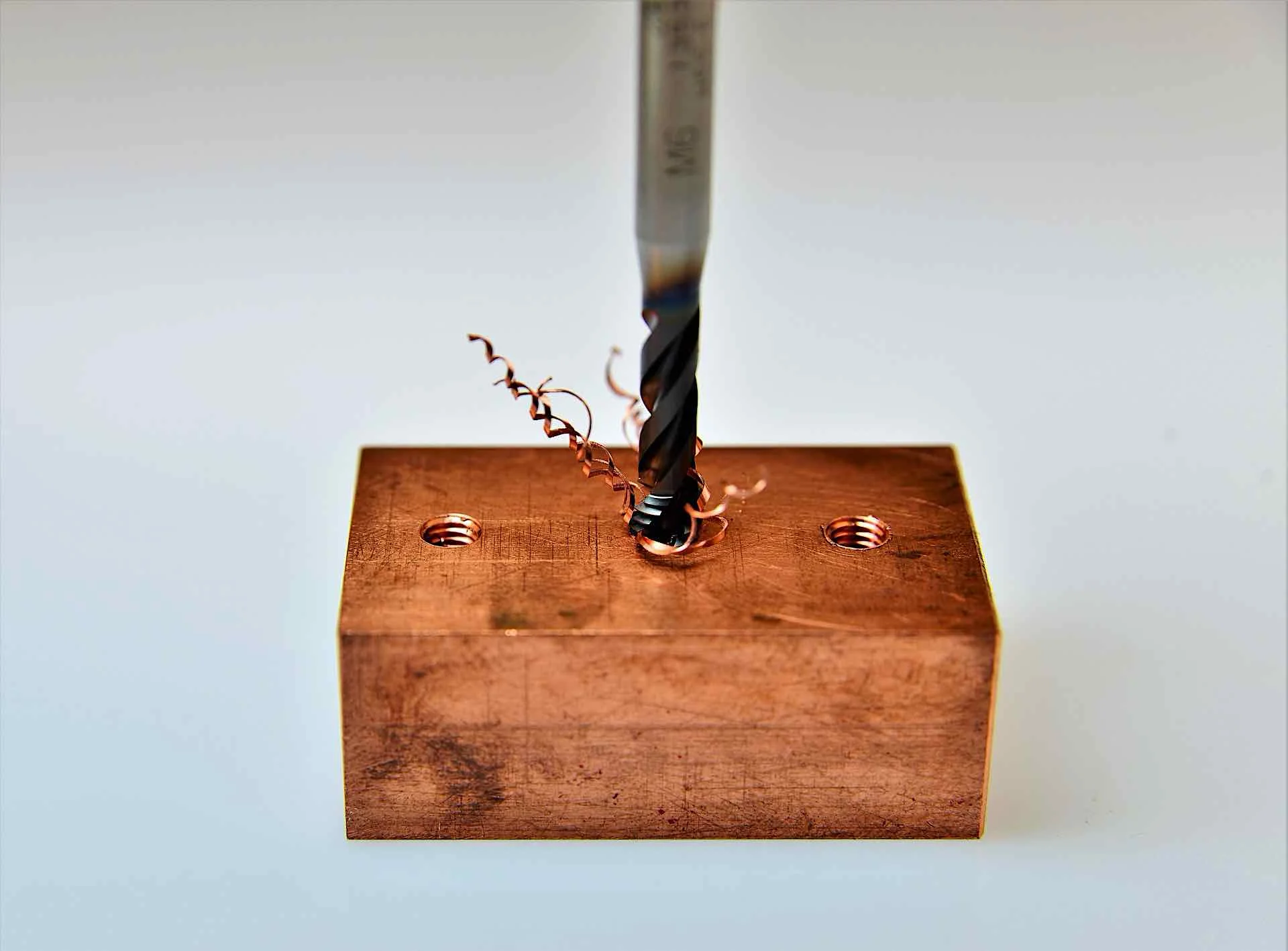

Copper alloys can be machined utilizing various techniques. CNC milling is an automated machining process that utilizes computerized controls to manage the movement and operation of multi-point rotary cutting tools. As the tools rotate and move across the surface of the workpiece, they slowly remove excess material to complete the desired shape and size. Milling can be used to create different design characteristics such as grooves, notches, pockets, holes, slots, contours, and flat surfaces.
Image of a block of copper being tapped with threaded holes
Image by Capri23auto from Pixabay
Here are some guidelines for CNC milling copper or copper alloys:
  • Common cutting materials are carbide application groups such as N10 and N20, and the HSS grades
  • You can double tool life by reducing the cutting speed by 10%
  • When milling a copper cast alloy with a cast skin, reduce the cutting speed by 15 percent for a carbide group tool or 20 percent for an HSS grade tool

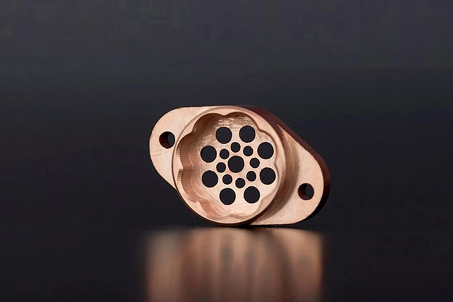

When creating designs with copper machined parts, there are multiple factors to consider. Generally, you should only use copper where necessary because copper is expensive and producing an entire part out of copper is often unnecessary. A good design can leverage a small portion of copper to maximize the benefit of its uncommon properties.
Image of a cnc milled copper part on a black background
Here are some common reasons to opt for copper or copper alloy parts:
  • High corrosion resistance
  • High electrical and thermal conductivity, and easily soldered
  • High ductility
  • Highly machinable as an alloy
