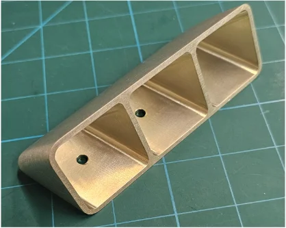

Chem Film or Alodine™
Chromate conversion coating, known as chem film, or chromating, is similar to anodizing because it produces a modified, corrosion-resistant oxide layer on metal parts, but does not use electricity to create its oxide layer. Alodine™ is the trademarked name for a chemical conversion coating produced by Henkel (other brand names include Iridite®, Bonderite®, and Chromicoat® ). I like to think of chromating as the electroless version of anodizing. Chem film or Alodine™ is a proper corrosion-resistant aluminum surface treatment for painting, powder coating, adhesive bonding, heat sinks, and automotive wheels.
Instead of an electrochemical reaction, chem film or Alodine™ is produced using a reactive chromium atom to drive a purely chemical reaction. To get a chem film or Alodine™ finish, parts are first cleaned, degreased, and rinsed. Then parts are placed in the chromium bath, removed, rinsed, and dried. Chem film or Alodine™ is often applied to screws, bolts, brackets, and other fasteners because it doesn’t produce a noticeable dimensional change. Chem film or Alodine™ is cheaper than anodizing, but more susceptible to wear and scratches.
These are the most common types of chromate conversion coating (chem film):
MIL-DTL-5541 Type 1 contains hexavalent chromium, or “hex-chrome”.
MIL-DTL-5541 Type 2 replaces hexavalent chromium with trivalent chromium, titanium or zirconium.
Historically, a hexavalent chromium compound served as the main catalyst in chem film or Alodine™ conversion coatings. However, given this atom’s carcinogenic nature, hexavalent chromium has become tightly regulated and now trivalent chromium, including type 2, can be used. This type of chromating, known as hex-free chromating, is typically accepted as the standard across many industries.

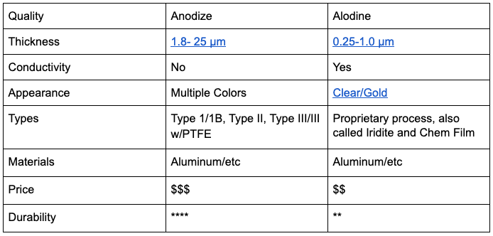

Compare the general qualities of chem film and anodization in the table below:
Anodization vs. Chem Film
Quality | Anodize | Chem Film |
Thickness | 1.8-25 μm | 0.25-1.0 μm |
Conductivity | No | Yes |
Appearance | Multiple Colors | Clear/Gold |
Types | Type 1/1B, 2, 3, 3 w/PTFE | Type 1, 2 Class 1A, 3 |
Materials | Aluminum and others | Aluminum and others |
Price | $$$ | $$ |
Durability | **** | ** |

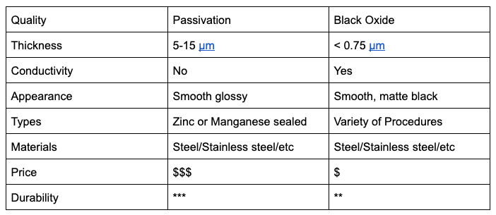

Black oxide and passivation are both processes utilized to enhance the corrosion resistance and aesthetics of stainless steel parts. While black oxide is a chemical conversion process, passivation is a chemical treatment process whereby free iron is removed from the surface of a stainless steel part, promoting the growth of a protective oxide layer. Stainless steel has a naturally occurring oxide layer, but free iron on the surface of a part reacts with oxygen in the air, forming rust (iron oxide). Passivation provides greater rust protection, while black oxide provides some rust protection with an enhanced surface appearance.
Passivation vs. Black Oxide
Quality | Passivation | Black Oxide |
Thickness | 5-15 μm | < 0.75 μm |
Appearance | Smooth, glossy | Smooth, matte black |
Types | Zinc or manganese sealed | Variety of procedures |
Materials | Steel, stainless steel, etc. | Steel, stainless steel, etc. |
Price | $$$ | $ |
Durability | *** | ** |
