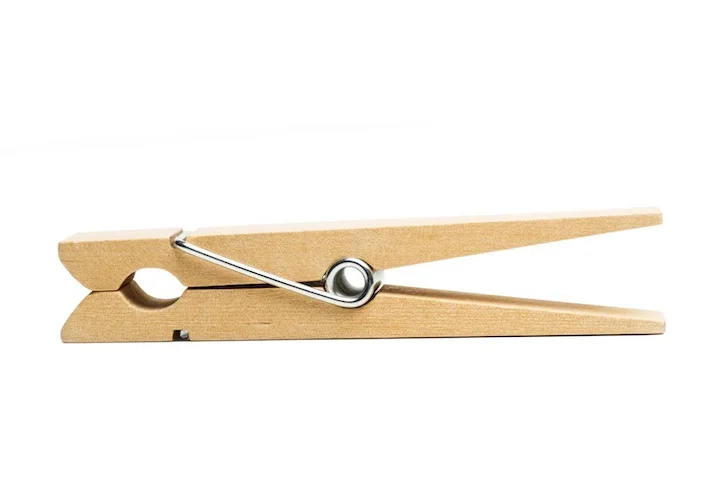

Compliant mechanisms are useful because they use flexible members to reduce the number of parts and manufacturing steps required to produce a functioning assembly or perform a specific function. Here’s an example of a compliant mechanism vs traditional design you’re likely familiar with: the clothespin. The image on the left shows the traditional mechanism clothespin, while the image on the right shows the compliant mechanism clothespin.
LEFT: 3 Part Traditional method clothespin RIGHT: Compliant Mechanism Clothespin (Dolly peg)
Let’s break down the traditional versus the compliant mechanism to see how beneficial designing a compliant mechanism actually is. Check out the table below for specifics, but the results speak for themselves — the compliant mechanism design is simpler and functions just as well.
Traditional Mechanism Clothespin vs Compliant Mechanism Clothespin
Traditional Mechanism Clothespin | Compliant Mechanism Clothespin | |
Motion Requirement | Limited range (Diameter of a clothesline + thickness of clothing) | Limited range (Diameter of a clothesline + thickness of clothing) |
Force Requirement and type | Keep clothes on the line, clamping | Keep clothes on the line, clamping |
Total Parts | 3 | 1 |
Number of Materials | 2 | 1 |
Number of Manufacturing Methods | 2 | 1 |
Number of Assembly Steps | 1 or 2 | 0 |
Looking at the table above, the cost and time benefits are clear. Fewer parts, fewer processes, fewer steps = reduction in COGS (Cost of Goods Sold). The compliant mechanism design wins in this battle!

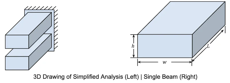

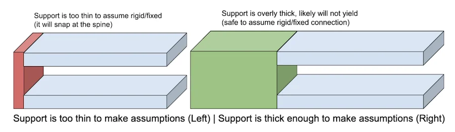

In our clothespin example, the most direct approach is to analyze the “Compliant Mechanism Clothespin” as two, linear-elastic, homogeneous, straight, rectangular, cantilever beams (fixed-free). This is only a correct assumption if the support is thick enough:
Let’s constrain the problem by saying we have a known displacement, x, and we don’t want our parts to break, so the stress must be below yield strength.
Using Hooke’s Law (F=kx) and Beam Theory, we need Young’s modulus for the material and the beam’s parameters. Armed with that information, we can input the Moment of Inertia and solve for displacement, or force at the end of one beam. For this example, x, is given and we are solving for F.
(Hooke’s Law)
(Beam Theory, effective spring constant of fixed-free cantilever beam)
(Moment of inertia)
(Combining, 1, 2, and 3)
F can be limited by “minimum holding force”, “maximum crushing force”, or more frequently “material failure”. For this example, we will limit ourselves to material failure. Another parameter that is not commonly given is “Flexural Strength” (stress at failure in bending), and this is where engineering judgment is required. We assume the flexural strength is equal to or slightly larger than the failure stress in tension, and it’s because of this assumption that we pad our results with a high factor of safety. Continuing to solve for geometries that are within the yield strength (𝝈yield) of the material, subject to the known displacement “x”.
(Yield Stress equation for a cantilever beam)
(Combining 4 and 5)
An effective design that will not fail can be achieved by tweaking h and L in equation (6). Adding in a factor of safety (recommended 5x-10x) will ensure a successful first print.
