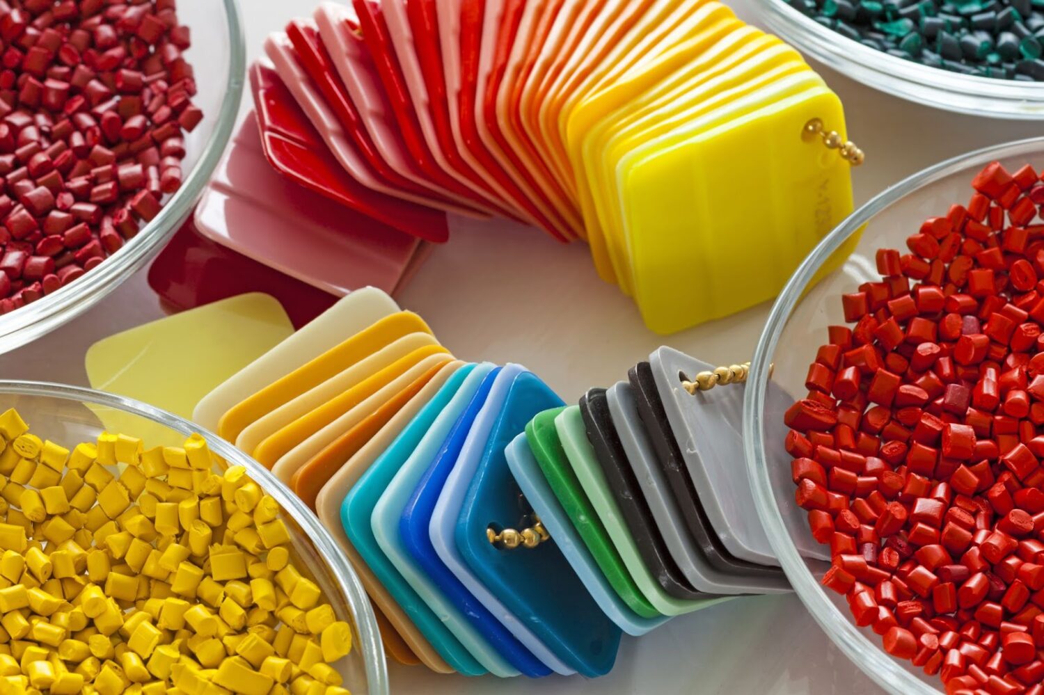

There are several ways to add color to injection molded plastic. Each has its advantages and disadvantages, and some are more cost-effective than others, depending on part volume. Injection molders can use pre-formulated resins, masterbatch colorants, or mix pigments and uncolored pellets together. They can also paint parts after injection molding. No matter the method, accurate color matching and color consistency are cosmetic goals for every project. For food or medical applications, you may also need to ensure that both the plastic and the colorant are FDA-compliant.
![Injection Molding Colors](https://www.fictiv.com/wp-content/uploads/2022/12/Plastic-part-finish-.jpeg)
Pre-Formulated Resins
Compounders sell injection molding materials where the granules fed into an injection molding machine already contain pigments. In other words, there’s no mixing required at the machine or before molding. Pre-compounded resins provide fairly consistent color between batches, but they’re only cost-effective for high-volume injection molding. That’s because pre-formulated resins typically come with the highest compounding costs per unit of measure, usually kilograms (kg).
Masterbatch Colorants
Masterbatch colorants can also be used to add color to plastic parts. These liquid colorants are highly concentrated, and the ratio of the uncolored pellets to the masterbatch colorant is 24:1. The advantages of using color concentrates for plastics are twofold. First, liquid color provides consistent results. Second, the compounding costs per kilogram are relatively low. Masterbatch colorants are only economical for very high volumes, however, and they often have a minimum order quantity (MOQ) of two metric tons.
Machine Hopper Mixing
Molders can also mix uncolored pellets with colored pigments in the injection molding machine’s hopper. This rotating drum is where materials are poured before injection molding begins. The advantages of machine hopper mixing are relatively low costs and support for low-volume injection molding. Potential disadvantages include: inconsistent mixing due to weak electrostatic attraction, pigment burning that produces black spots on parts, and humidity issues. By using a sealed system from the drier to the hopper to the machine barrel, however, it’s possible to keep moisture from entering the material.
