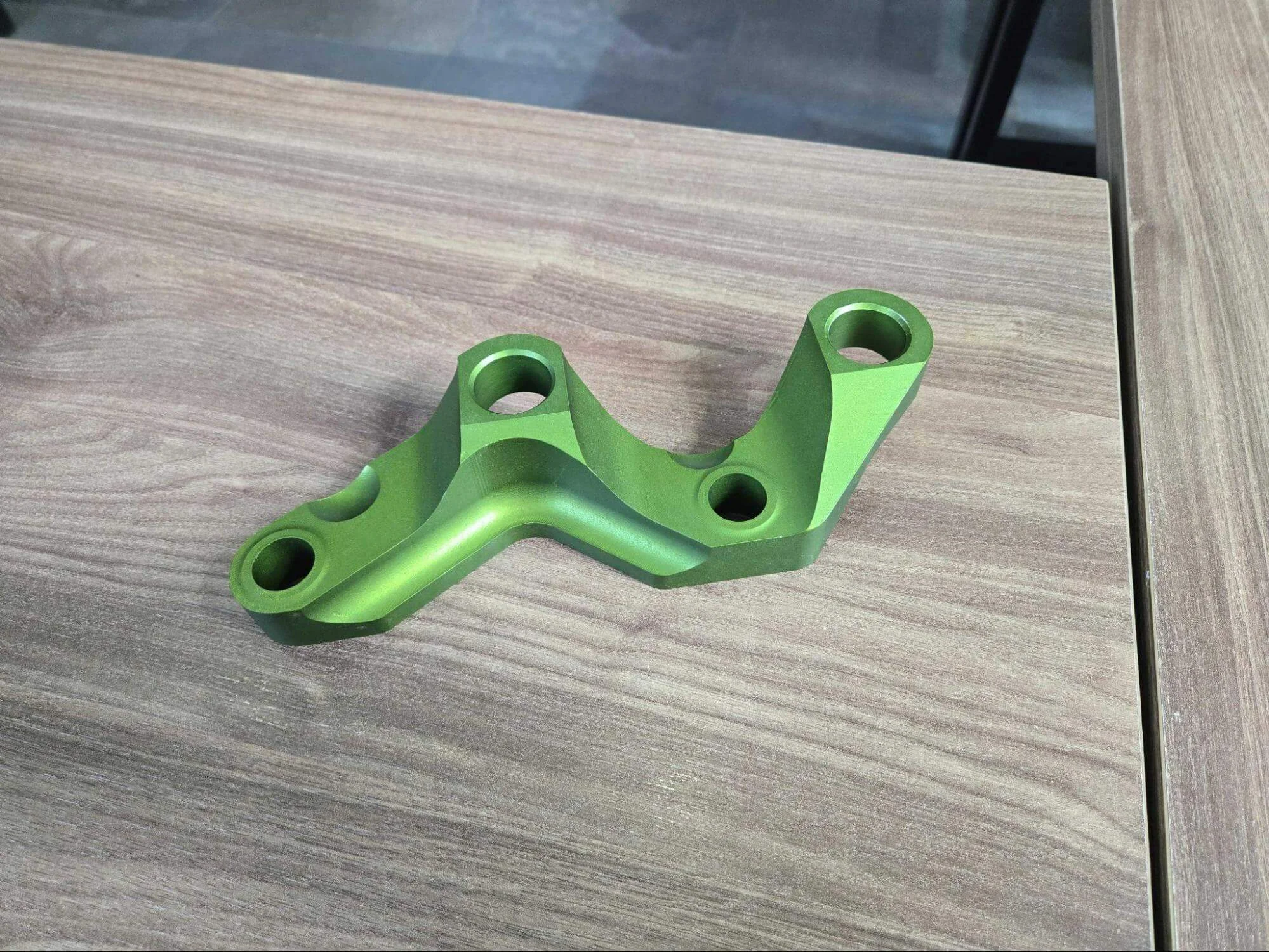

When to Use CNC Machining for Prototype Manufacturing
A CNC-machined prototype.
CNC machining is a very mature manufacturing method and is used in a wide range of industries. It offers excellent precision, part strength, and a smooth surface finish. You typically want to opt for CNC machining over 3D printing for the following:
  • High precision and tight tolerances (e.g., aerospace or automotive components)
  • Functional prototypes that must withstand stress or harsh environments
  • Metal parts that need to be strong and durable
  • Smooth surface finishes that require minimal post-processing
However, while CNC machining delivers unmatched quality, it can be more expensive and time-consuming than 3D printing, especially for single prototypes or small batches. The subtractive nature of the process can also lead to large amounts of material waste,  although it can often be recycled. However, for projects where precision, strength, and reliability are non-negotiable, CNC machining is often the best choice.

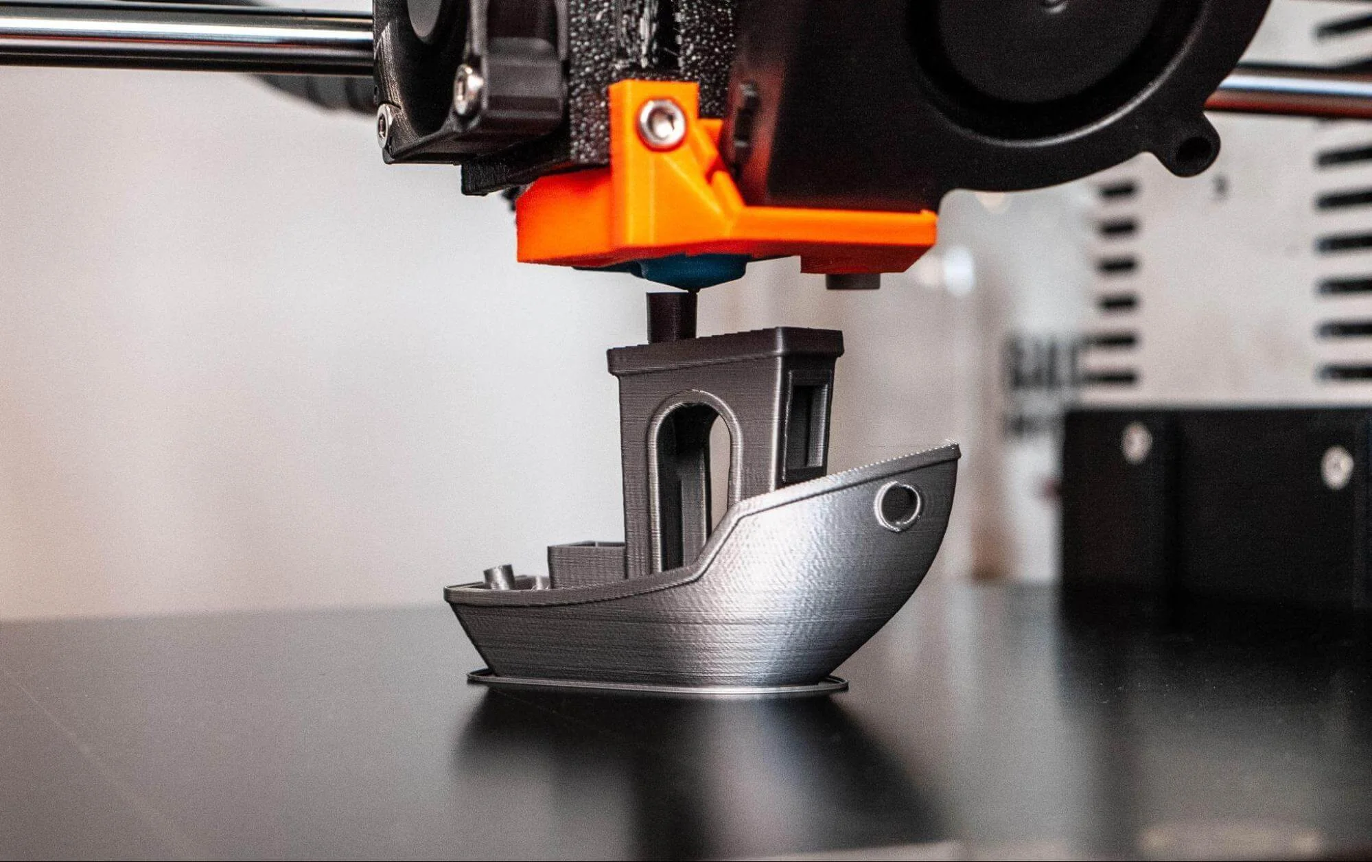

When to Use 3D Printing for Prototype Manufacturing
3D printing has recently cemented itself as one of the most popular rapid prototyping methods. It offers virtually unlimited design possibilities and rapid design iterations that are as simple as updating a CAD file and starting a print.
While CNC machining does offer better surface finishes and tighter tolerances, 3D printing outperforms CNC machining in the following scenarios:
  • Rapid prototyping and iterating through design cycles quickly and cost-effectively.
  • Complex geometries with intricate details, internal features, or organic shapes.
  • Lightweight structures or designs optimized for material efficiency.
  • Custom, one-off prototypes, or low-volume production where traditional manufacturing would be too costly.
  • Low-cost material testing before moving to the final production.
While 3D printing excels in speed and design freedom, it typically offers lower precision and strength compared to CNC machining, depending on the material and printing process used. Additionally, the layered surface finish may require post-processing to achieve a smoother appearance. Despite this, 3D printing has proven itself to be an invaluable tool for projects that require speed, affordability, and creative design.

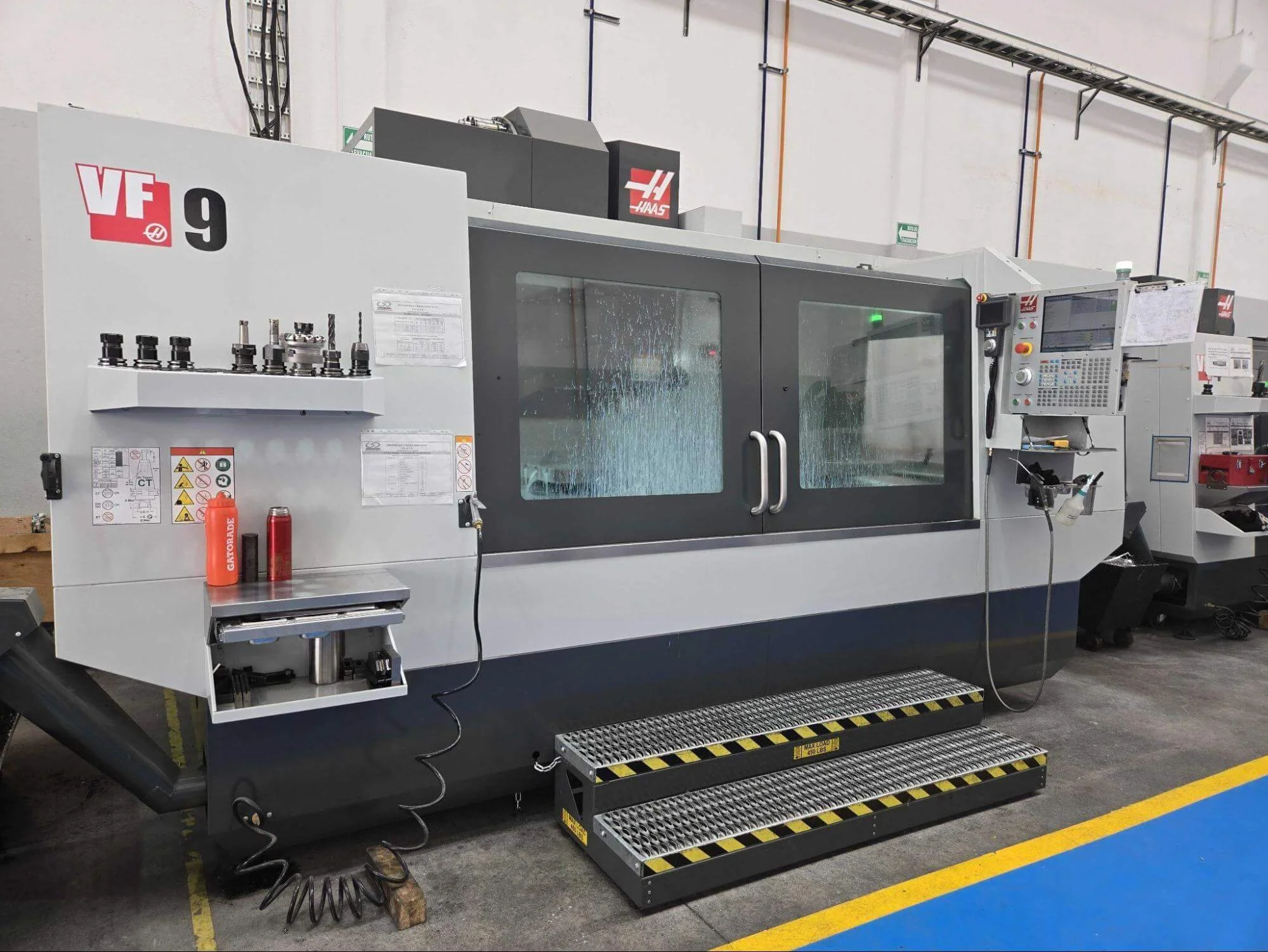

CNC machine
CNC Machining Constraints
While CNC machining is a mature technology, it does have its own set of limitations. Sharp internal corners can be challenging to achieve due to the physical constraints of cutting tools. Additionally, the process is limited to geometries that can be accessed by these tools, making intricate or highly complex designs challenging to produce. CNC machining is fastest for parts with solid, high-strength designs, while parts that have delicate features or organic shapes (freeform, irregular, or inspired by natural forms) can take more time to manufacture.
