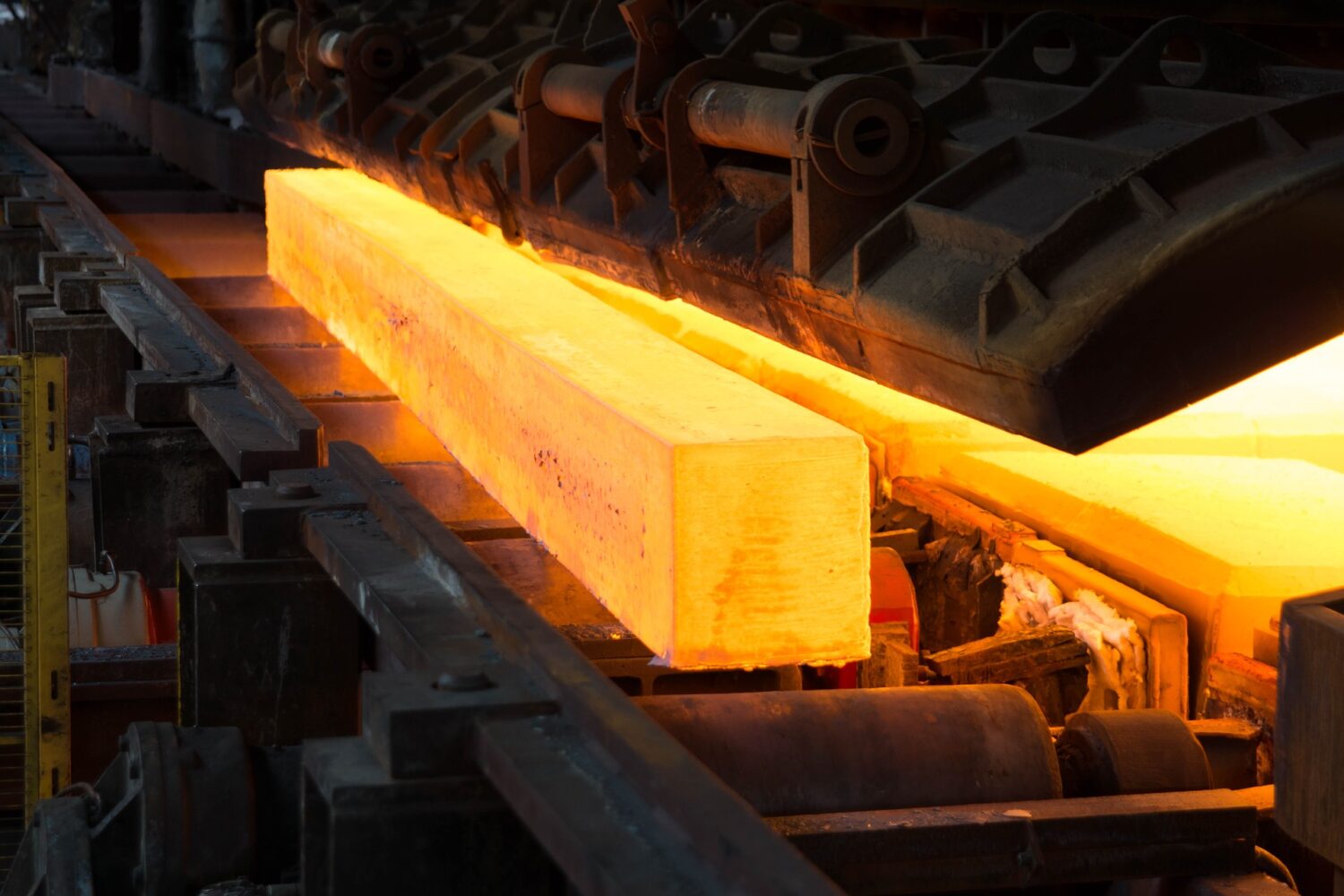

Heat-treated metal being placed in quenching liquid. Source: Bernard + Company

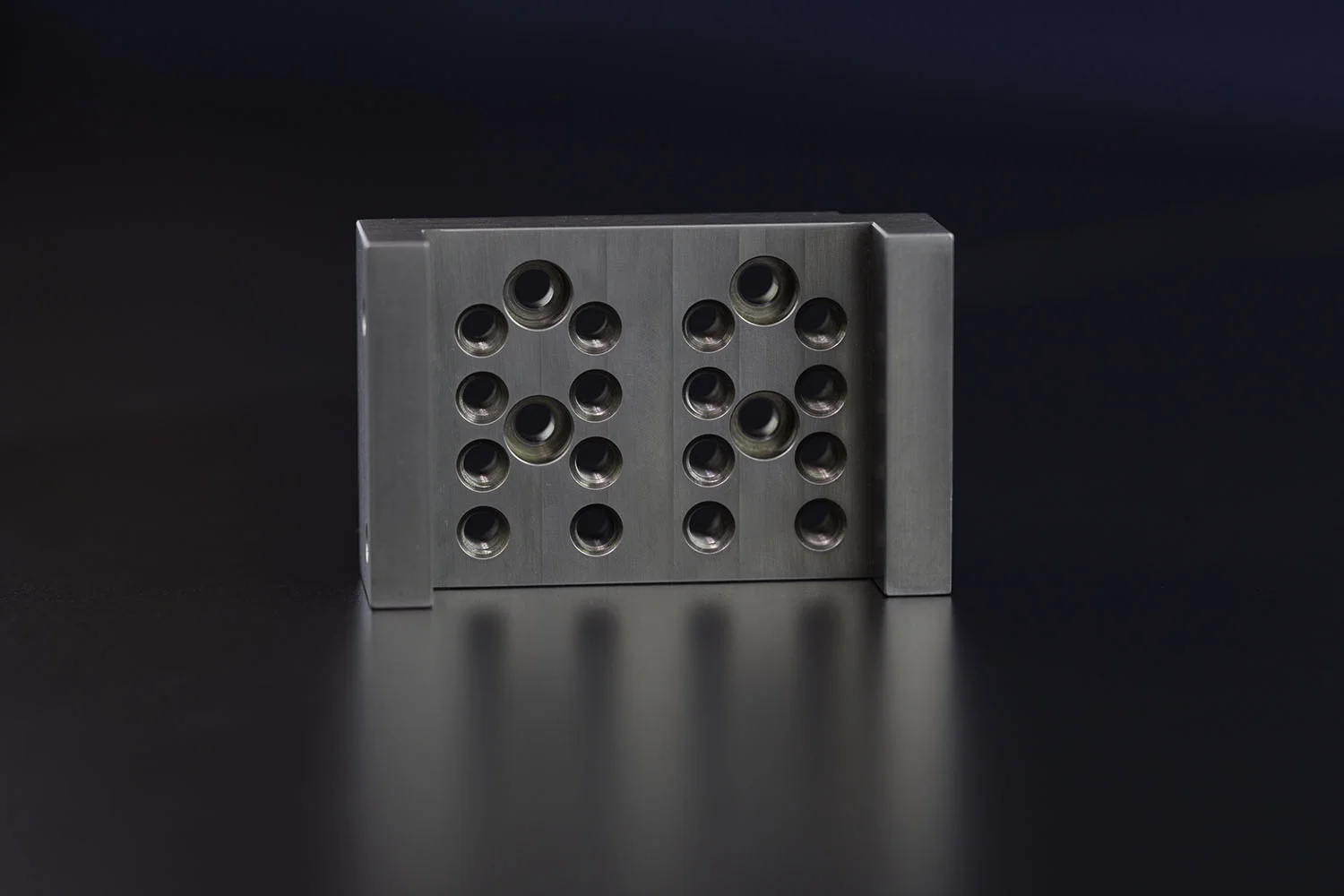

CNC machined 17-4 PH stainless steel part
Heat treatment is a processing operation option before or after machining. Why use one method over the other? Both pre-CNC-machining and post-CNC-machining heat treatment processes are common, and both offer specific benefits and considerations. The order in which you choose to heat treat and machine your metal can affect the material properties, the machining process, and the tolerances of your part.

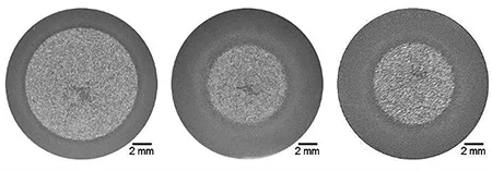

3 cross section images of steel rods with different levels of hardening
The depth of hardening can vary by changing process parameters
