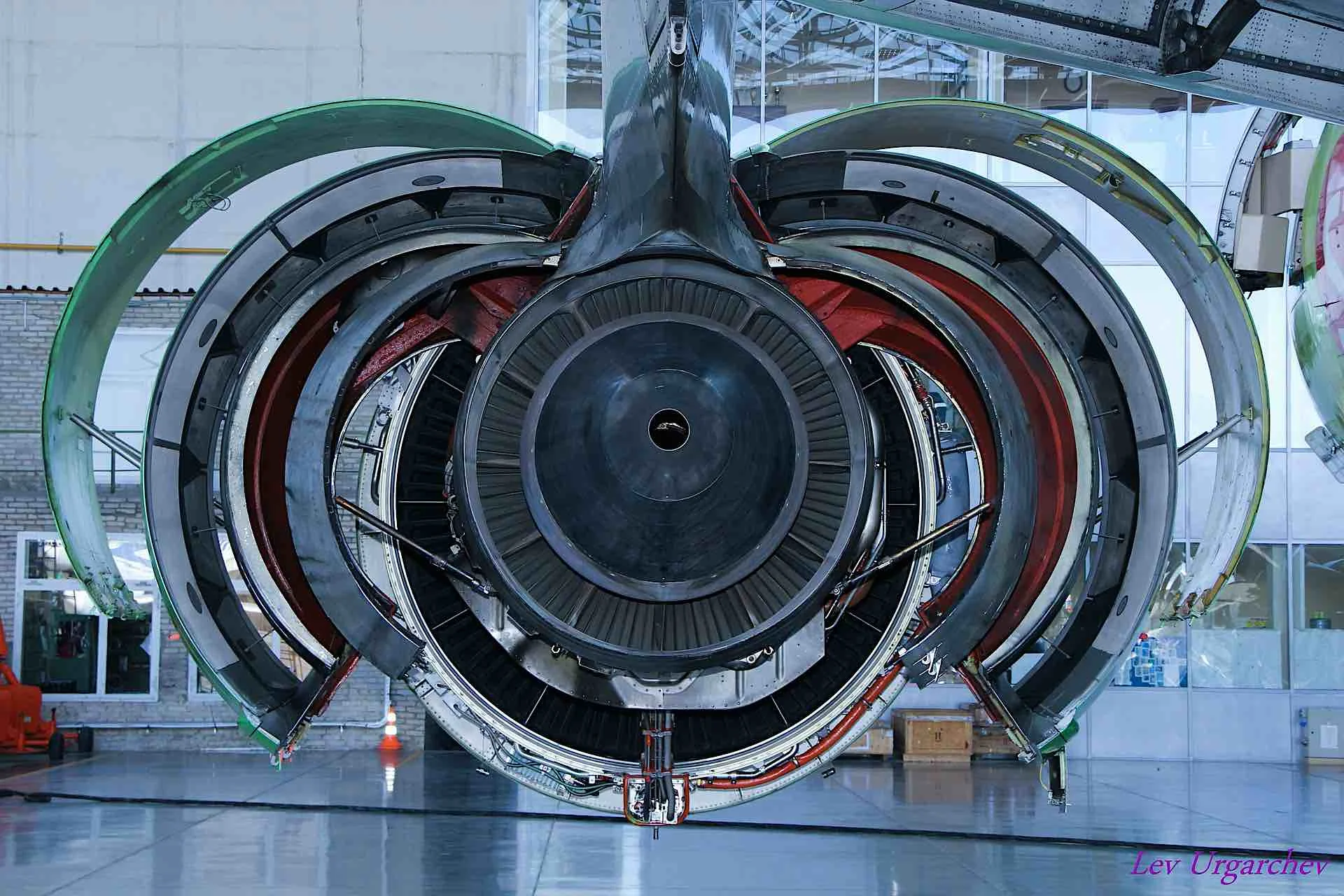

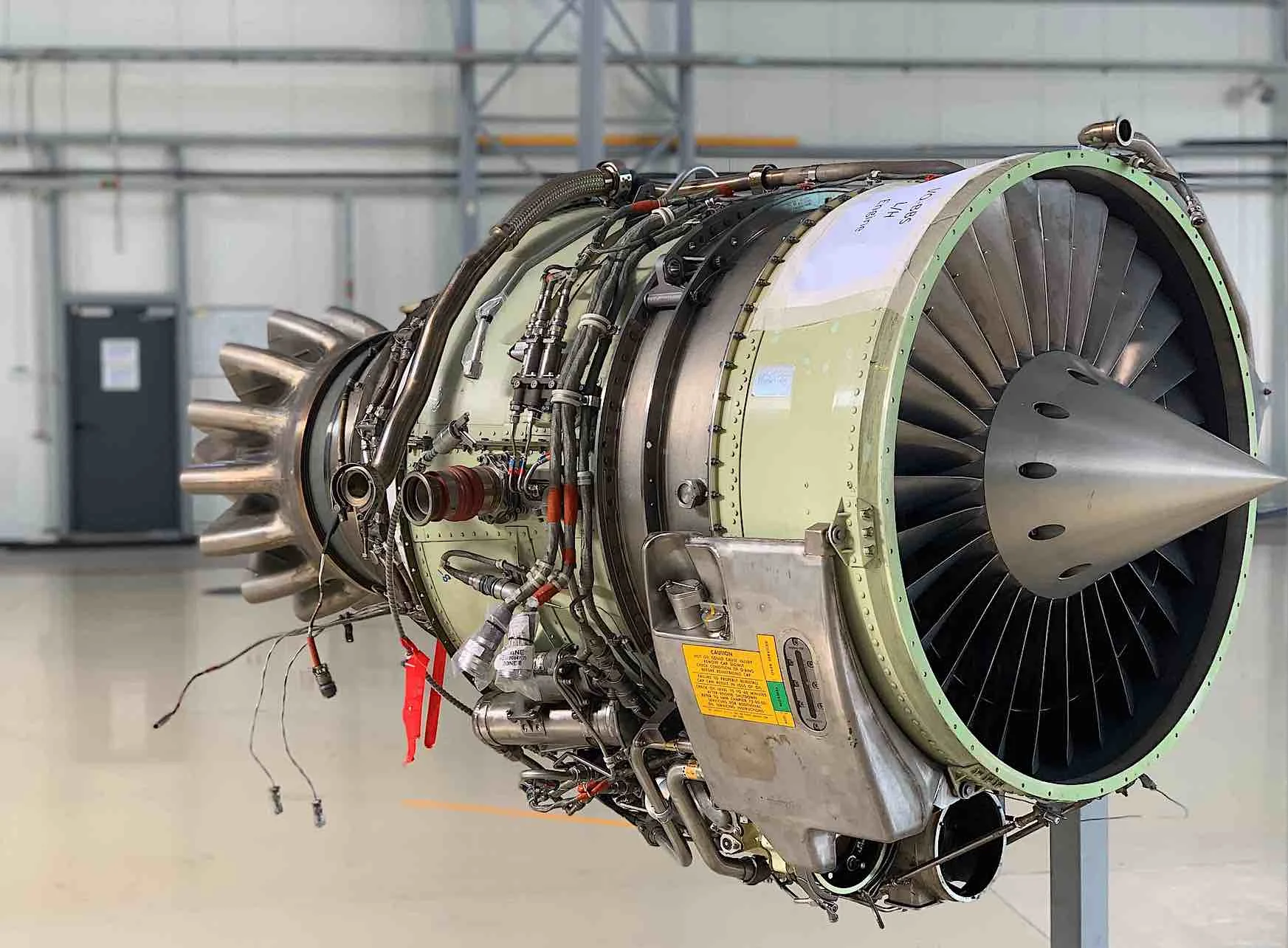

CNC machining is used to manufacture components throughout modern planes, from the landing gear (components such as braces and torque links) to the engine (compressors and turbines). Structural components can also be CNC machined, like parts of the fuselage, bulkhead, and airframe. Gears, shafts, and housings, which are important for moving components, are commonly CNC machined parts. Finally, in helicopters specifically, the piston engine housings are generally CNC machined.

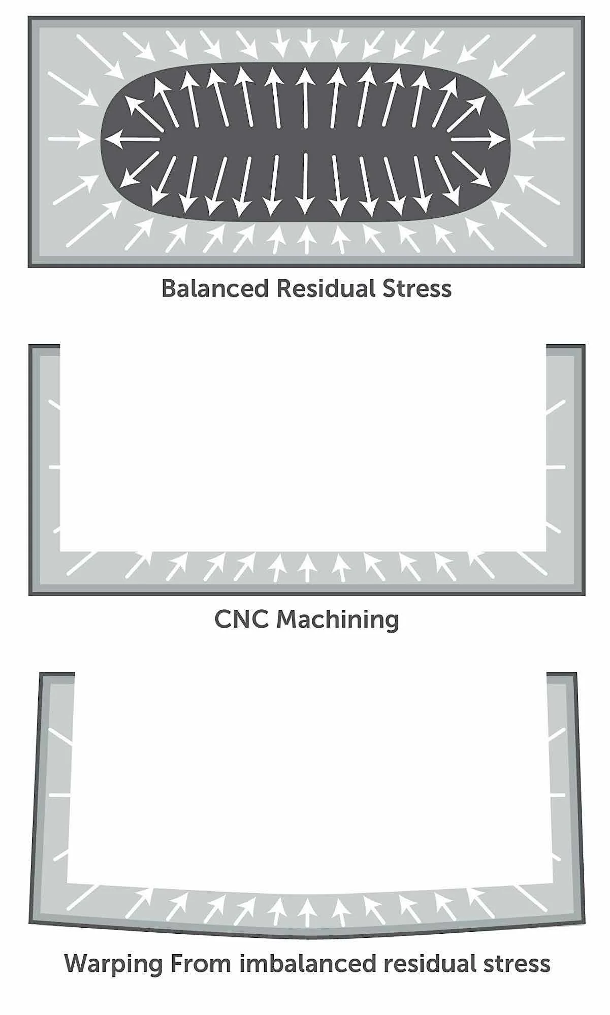

Some components, such as engine or compressor housings, have large internal cavities. For example, to manufacture the transmission housing for helicopter blades, a CNC machine must core out a large block of material. This takes a lot of time, creates a lot of scrap material, and also leads to residual stresses in the part. These residual stresses can lead to deformation or warping — which are problematic when you’re working with tight tolerances and high standards.
In order to determine beforehand if removing a lot of material will be a problem, there’s a pair of formulas you can use. You’ll need to check both the IRMR (Internal Removed Material Ratio) and the ERMR (External Removed Material Ratio). The formulas for both are shown below.
The IRMR should be greater than 85%, which indicates that you’ve removed less than 15% of the internal part volume. The ERMR, which compares the final part bounding box volume to the stock volume, should be greater than 30%. If both of these pass the test, you can move forward with prototyping and testing. However, if one or both of these values is beyond the acceptable limit, your part may be difficult to manufacture within tolerance or you may run into performance issues.
In those cases, you have a few options. If the quantity of parts needed is low, you can machine one and test it, then proceed (and continue testing each part) if the first part turns out to be in spec.
Sometimes parts like this can be cast, which is a process better suited to creating large components with thin walls. With casting, you’ll waste less material and experience less warping. CNC machining will probably still be necessary for finishing and meeting tolerances.
Finally, you can use a special high-performance 5-axis CNC machine, which has more ability to control the force, power, and speed. By using a lower force, power, and speed, you can machine a part with thin walls without exerting so much force that it will deform. Additionally, you can use an ADOC (axial depth of cut) or RDOC (radial depth of cut) to machine parts symmetrically in order to distribute the force, resulting in less residual stress.

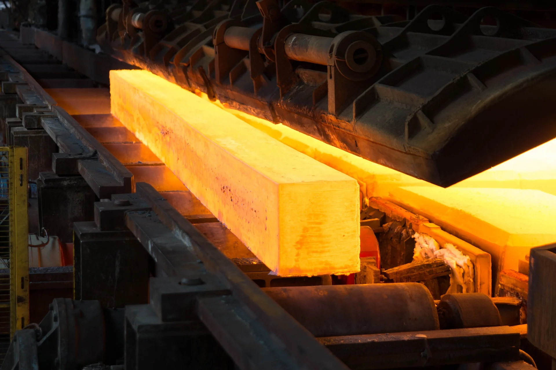

It can be difficult to achieve the highly specific material properties required for aerospace applications. The metals will often need to be heat-treated to reach the desired hardness and strength. Heat treating is a common process but presents its own challenges.
Heat treating before machining will make the material significantly harder and stronger, so it can hold tighter tolerances. But, machining hardened material is more time-consuming and wears down the cutting tools faster, so is more expensive to machine. If you must heat treat before machining, investing in tools made out of a harder material like titanium, rather than carbide or high-speed steel, can help ameliorate those issues.
Of course, heat-treating after machining has its own issues, since it may affect the dimensions of the part. This negates the precision of the CNC process, and can even push the part out of spec. You can mitigate this by choosing the most effective heat-treating process.
Tempering and aging involve heating the metal to a lower temperature than other processes, so the dimensions won’t change as much. Additionally, at the end of the heat-treating process, you can use press quenching rather than oil quenching. Oil quenching causes the material to shrink more quickly, which results in larger dimensional changes.
The simplest way to get the right properties is to accept the increased cost and lead time of heat treating before machining. Again, quality is key for CNC machining, and getting that quality entails sacrifices in speed and cost. Another option in some cases is to perform a small amount of final machining after the hardening process. This lets you do most of the machining on the pre-hardened material, and finish the hardened material to get within the tolerances needed for the final part.
