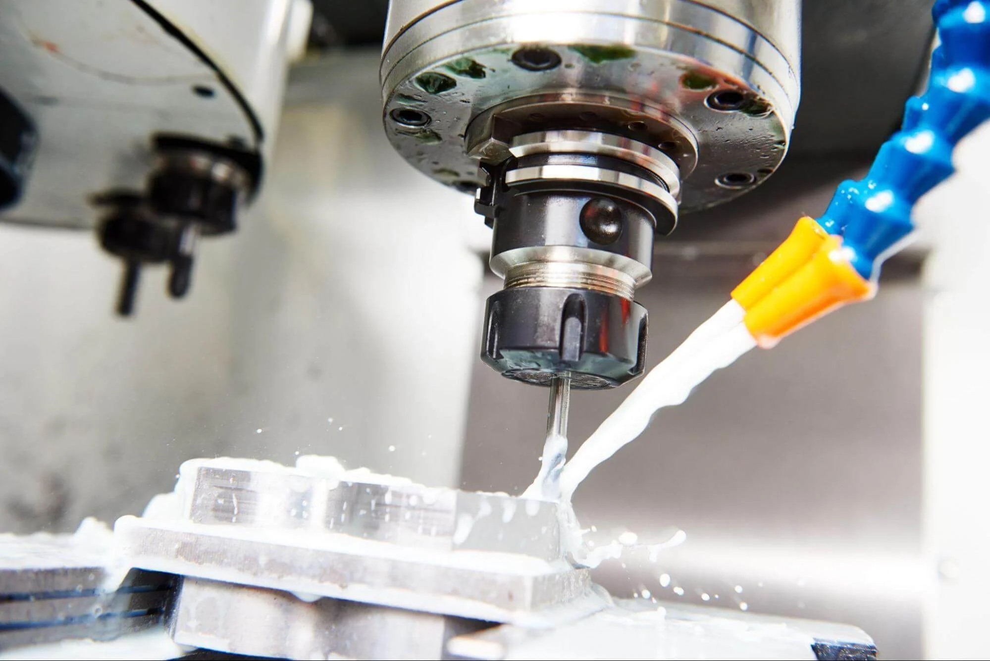

Coolant being sprayed on a part during CNC machining

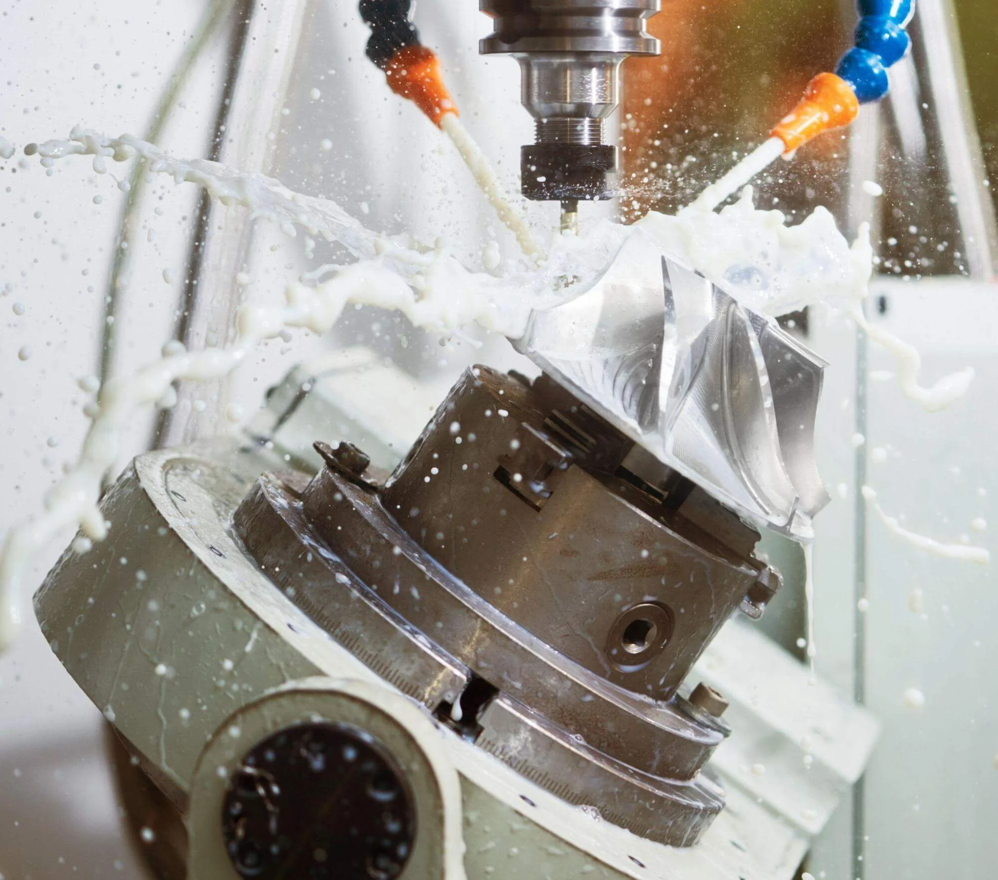

coolant sprayed on an impeller during precision CNC machining
