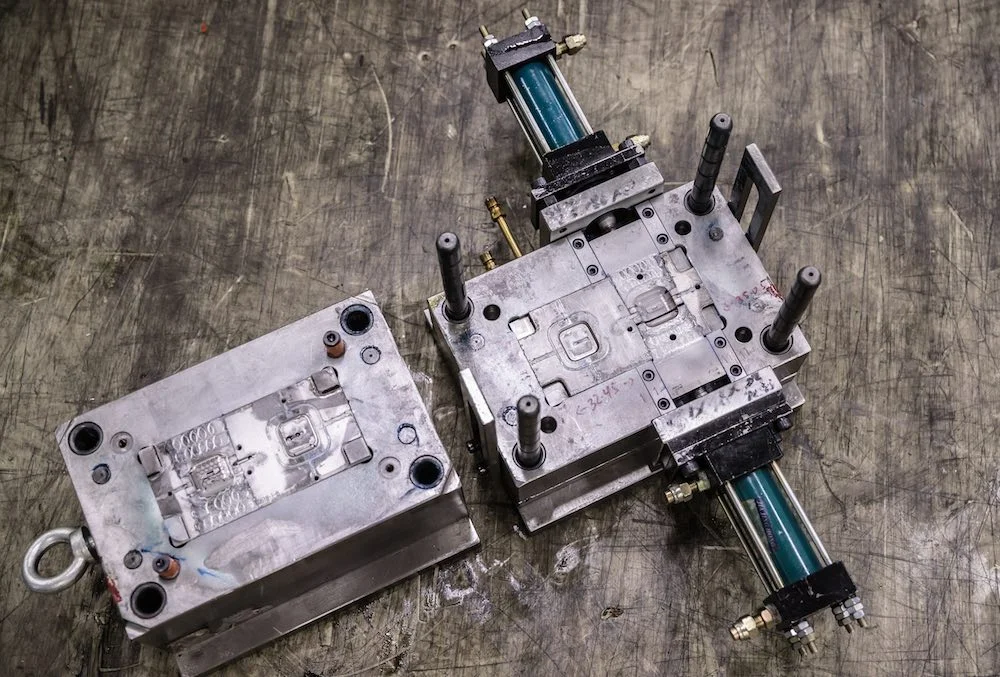

The three main categories of tooling materials are aluminum, soft and semi-hardened steel, and hardened steel.

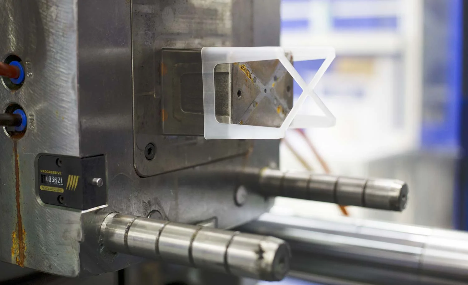

Usually, Fictiv customers start with single cavity, P20 or NAK80 steel tools for their engineering validation testing (EVT) and design validation testing (DVT). These tools are finished and produce the first samples (T1) in 10-25 days.
![a white plastic part being ejected from an injection mold](https://www.fictiv.com/wp-content/uploads/2020/09/US-injection-molding-09.jpg)
Such molds enable our customers to save on NRE costs at the beginning stages of a new product, and help bring an initial product to market faster. This can unlock investments and produce a bridge production quantity of parts to tide them over until production tooling comes online.
During these validation phases, more than one third of Fictiv customers’ tools require design changes through an ECO, which usually takes 3-5 days to modify the tooling. Single cavity, P20 or NAK80 tooling for ECO’s provides more freedom to make non steel-safe changes than aluminum at a lower cost than a hardened steel, multi-cavity production tool.
