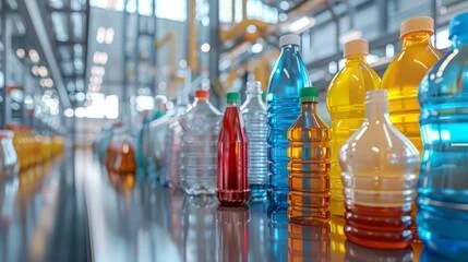

Injection molding and blow molding can both produce plastic parts. These two manufacturing processes have some important differences, however.
- Injection molding heats plastic, injects it into a highly pressurized mold, and produces solid plastic parts. Depending on their design, injection molded parts can have complex shapes and intricate details. Examples include medical and aerospace components.
- Blow molding uses pressurized air to inflate a tube of heated plastic inside of a mold. Blow molded parts are hollow and lightweight, and they feature relatively simple designs. Examples include water bottles and milk jugs.
![](https://www.fictiv.com/wp-content/uploads/2024/07/blow-molded-parts-like-these-have-thinner-walls-than-injection-molded-parts.jpg)
There are other differences between blow molding and injection molding, as the table below explains. Importantly, these differences cover everything from part design and material selection to tooling and production.
