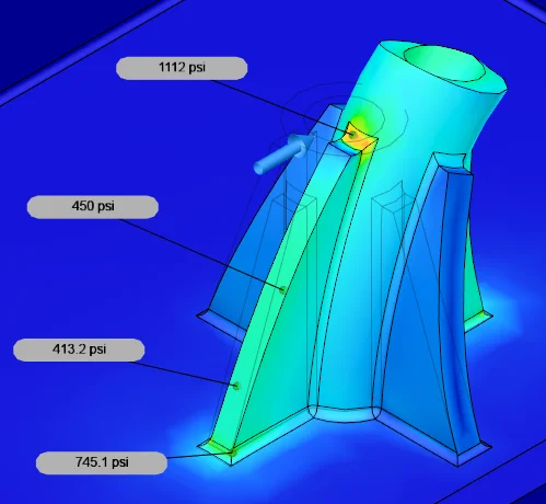

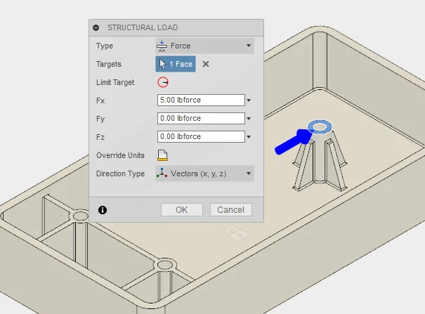

The image below depicts a five lbf (pound-force) load on the boss with gussets in order to demonstrate total stress and deflection in the current state. All of these simulations use the material properties of ABS, so they’re consistent with common 3D printing materials.
As you can see below, the majority of the part is stressed to the 400 psi range, with the maximum stress reaching just over 1,200 psi (not shown, as it is on the compressive side). The areas with higher stress concentration are all on the tension side, with the highest tensile stress around 1,100 psi.

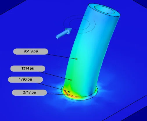

In the following images, we can see the same FEA study conducted without the presence of gussets, but with the same loading conditions and boss geometry. The stresses are now more than double what we saw in the prior study — indicating that without gussets, the boss is less than half as strong.
It’s immediately apparent that the feature is not as strong without the gussets. In fact, this feature is now experiencing stresses close to the yield strength of the ABS material we selected (yield strength=2,900 psi).
In addition to the increase in strength, the parts undergo much less deflection when we add gussets. And for applications that require positional alignment or rigidity, this is critical. The side-by-side images below show just how much more the un-gusseted boss deflects.
The boss deflects four times as much at the topmost point when it has no gussets, which is a major problem for both function and aesthetics. Gussets do not always have to be angled, however, as they can also be straight features:

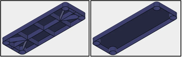

Our next example shows another way we can use structural ribs when not attached to a boss. Let’s start by looking at two different versions of the underside of a shelf:
The shelf on the left features added support ribs, while the shelf on the right has all of the ribs removed. After seeing the impact that gussets have on the strength of a boss, its easy to conclude that ribs in mechanical design will add strength and rigidity to the shelf — but can such thin features provide that much support?

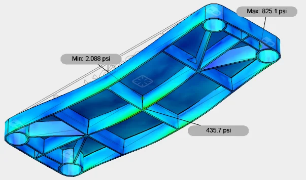

We’ll start out by solving the FEA with the ribs included to locate the high-stress regions. This information will be used to drive our safety factors, as well.
I want to target no less than a 3:1 safety factor for this design since it’s load bearing. The image below details the results of the study:
The maximum stress is 825.1 psi, located in the cylindrical slots for the shelf leg insertion during assembly. Given that we’re using ABS with a yield strength of 2,900 PSI, our safety factor is 3.5, which exceeds our requirements.

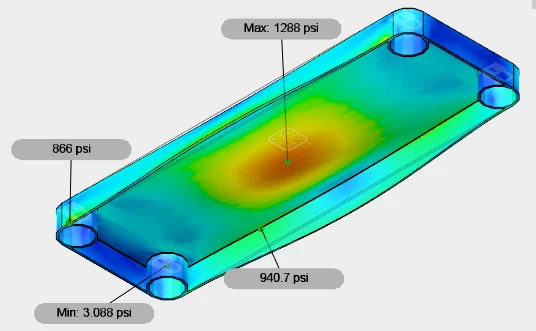

In the next image, we’ve run the same FEA study on the shelf without the additional support ribs.
Here, we see the stresses shoot up to a maximum 1,288 PSI, and many other locations within the shelf are stressed to a much higher level, as well. Our safety factor has also been reduced to 2.3, which is well below our requirement.

Here’s a quick comparison table to recap the results of ribs vs no ribs on the shelf:
Geometry | Max Stress (PSI) | Factor of Safety | Max Deflection (inch) |
Shelf with ribs | 825.1 | 3.5 | 0.03452 |
Shelf without ribs | 1,288 | 2.3 | 0.3564 |
All the results clearly show the added benefit that ribs have on the stresses experienced by the shelf, its maximum deflection, and Factory of Safety.

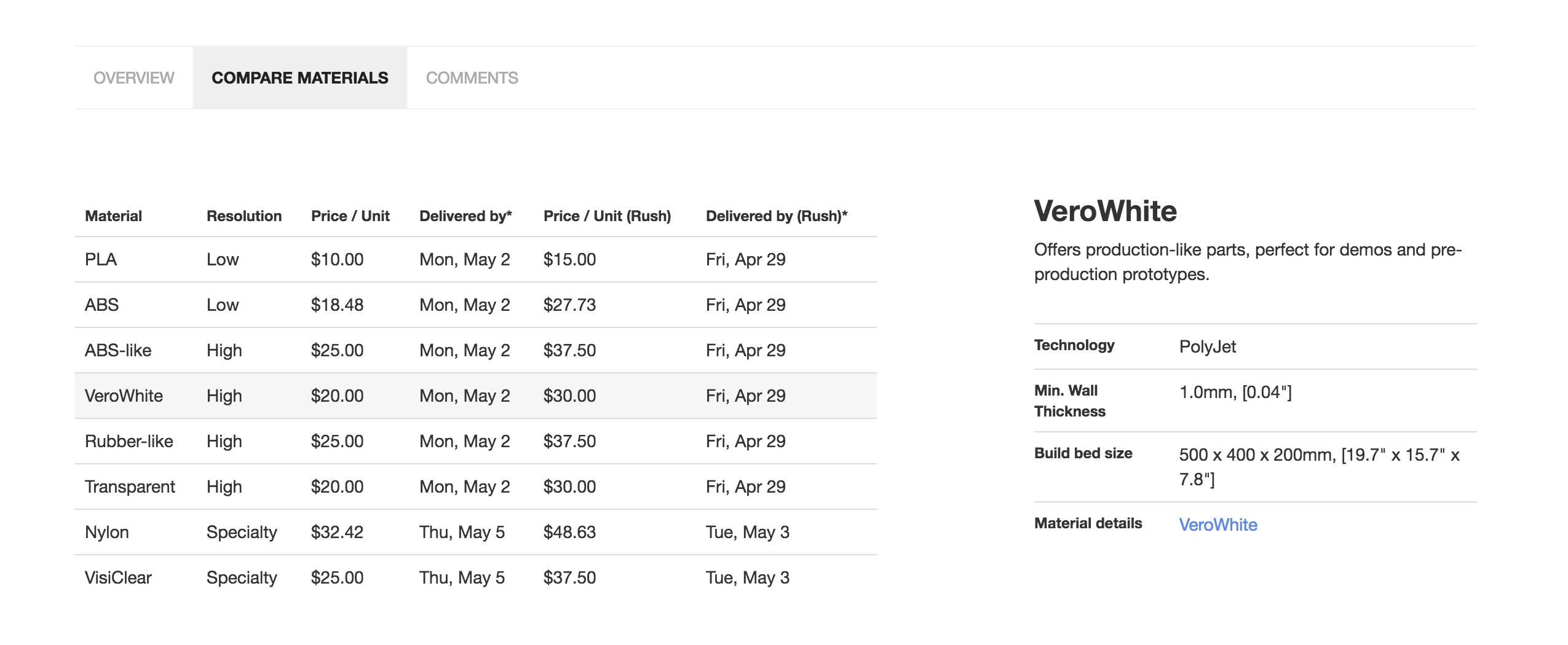

- For rib/gusset dimensioning, ensure that 3D-print wall thickness is within the recommended guidelines of the machine and/or process you will be using. If you’re using Fictiv’s platform, this information is under the compare materials tab in your part details page:
