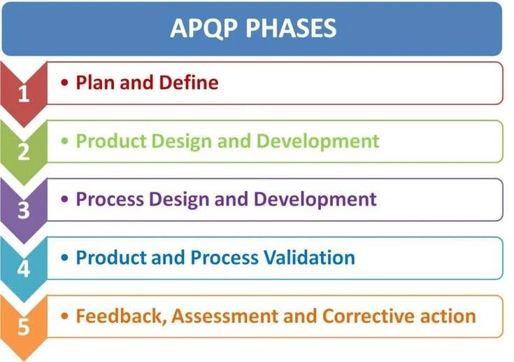

The five main phases of APQP
The 5 Phases of the APQP Process and How to Implement Them
The APQP process consists of one pre-planning phase and five concurrent phases, or stages.
Phase 0: Pre-Planning
APQP begins with gathering data, questioning assumptions, and applying lessons learned. The pre-planning stage involves collecting existing information, such as customer questionnaires, and identifying areas where significant changes may occur. This establishes the basis for a smooth transition to the planning phase.
Phase 1: Plan and Define
The goal is to ensure that a product will meet a customer’s standard for quality right from the start. Planning involves understanding the customer’s needs and translating them into product requirements. This stage covers product design, reliability objectives, quality targets, the bill of material (BOM), preliminary process flow, special attributes or features, product assurance planning, and securing management support.
Phase 2: Product Design and Development
During product design and development, engineers review geometry, features, and tolerances and create prototypes to test the design. Tools like Design Failure Mode and Effects Analysis (DFMEA) can help identify potential issues. The outputs include detailed engineering drawings, material specifications, and a prototype control plan.
Phase 3: Process Design and Development
This phase ensures the manufacturing process is well-defined, efficient, capable of meeting production demands, and manufacturable (i.e., DFM). Deliverables include Process Failure Mode and Effects Analysis (PFMEA), a risk management tool that helps organizations identify and evaluate potential failures in a process.
Phase 4: Product and Process Validation
Validating both the product and the process ensures that a manufacturer can meet all quality standards while handling the required production volume. MSA and SPC, two of the other five Core Tools, are used. PPAP is also completed during this stage.
Phase 5: Feedback and Corrective Action
The final phase, the full-scale production launch, focuses on evaluating and improving processes. The company collects feedback from manufacturing, assesses any issues, and implements corrective actions. The goal is to reduce variation and use lessons learned to ensure ongoing quality and customer satisfaction.
