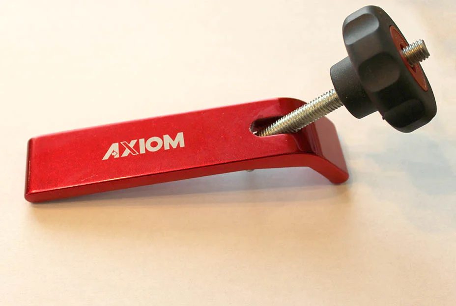

Typical Applications for Anodized Aluminum Parts
Anodic oxide coatings have a broad range of applications, but one of the most common is for aesthetics because it enables dyeing components in various colors.

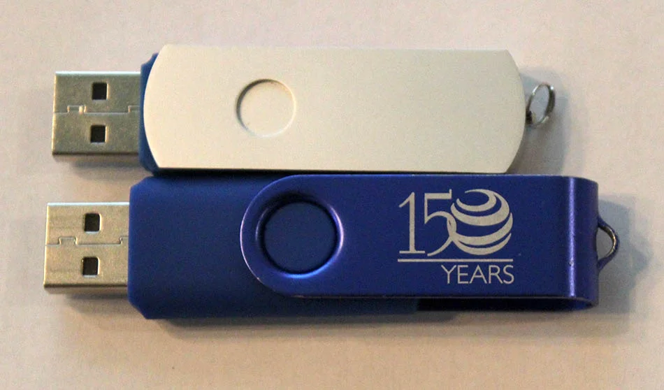

The top thumb drive is class 1 (undyed), so the anodic coating appears clean, and the color is almost that of the base alloy. The bottom thumb drive has been dyed a vibrant blue color. Another example is the thread adapter below that has been anodized and dyed black.

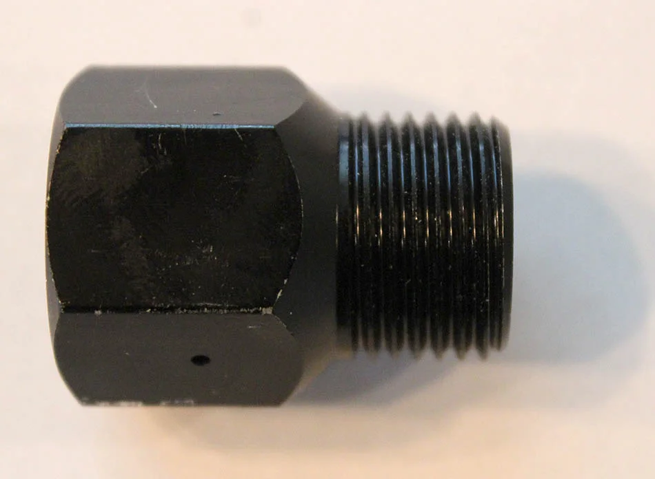

The thread adapter coating does not appear to be wear-resistant, indicating that it was coated with a thinner Type II anodize or was produced with poor process controls.

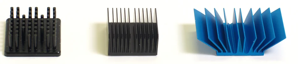

As a fourth example, we have some anodized heat sinks seen below.
Anodic coatings can improve the effectiveness of heat sinks by increasing the surface emissivity by an order of magnitude over bare aluminum, which improves the radiation heat transfer.

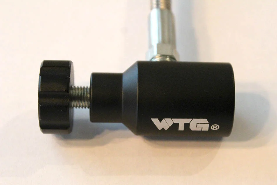

Below, we can see a matte black valve that has a relatively high-quality anodic layer. Also, note the attractive laser-etched logo that contrasts with the rest of the component. It’s common to etch through the anodic layer instead of printing on a part’s surface — both to increase the logo’s durability and to save cost and process steps.

We can see that the top thumb drive is class 1 (undyed), so the anodic coating appears clean, and the color is almost that of the base alloy, while the bottom has been dyed blue. In another example, we can see a thread adapter that has been anodized and dyed black.
