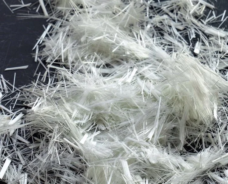

Glass Fiber
A common way to improve the mechanical properties of a plastic material is to add glass fibers. These fibers improve structural properties like strength and stiffness and reduce shrinkage of the part. Glass-filled resins are relatively inexpensive and can be added to most plastics, such as nylon.
In terms of drawbacks, glass fibers can make the part brittle and reduce impact strength. They also decrease the life of the mold and wear on the barrel and nozzle of the molding machine. Glass-filled resins will also raise the material’s viscosity, making the mold harder to fill. Glass fibers can be added to various colored resins, but they will affect the appearance.

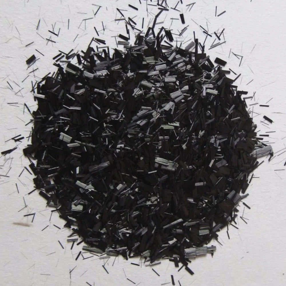

Carbon Fiber
Carbon fiber fillers can improve the mechanical properties of a plastic material. Carbon-filled plastic parts have similar mechanical properties as glass-filled plastic, but result in stronger and lighter parts. Carbon fibers are conductive, so carbon-filled parts have better electromagnetic shielding properties. Even more than glass fibers, carbon fibers improve structural properties, like strength and stiffness, and reduce the shrinkage of the part.
The main drawback of carbon-filled parts is that they are expensive, and like glass fibers, carbon fibers will make the part brittle and reduce impact strength; decrease the life of the mold and cause wear on the barrel and nozzle of the molding machine. Carbon fibers will also raise the viscosity of the material, making the mold harder to fill. Keep in mind that for carbon-filled materials, the part color will be limited to black only. Some resins also need to have the mold temperature run very high, which could require expensive auxiliary equipment.

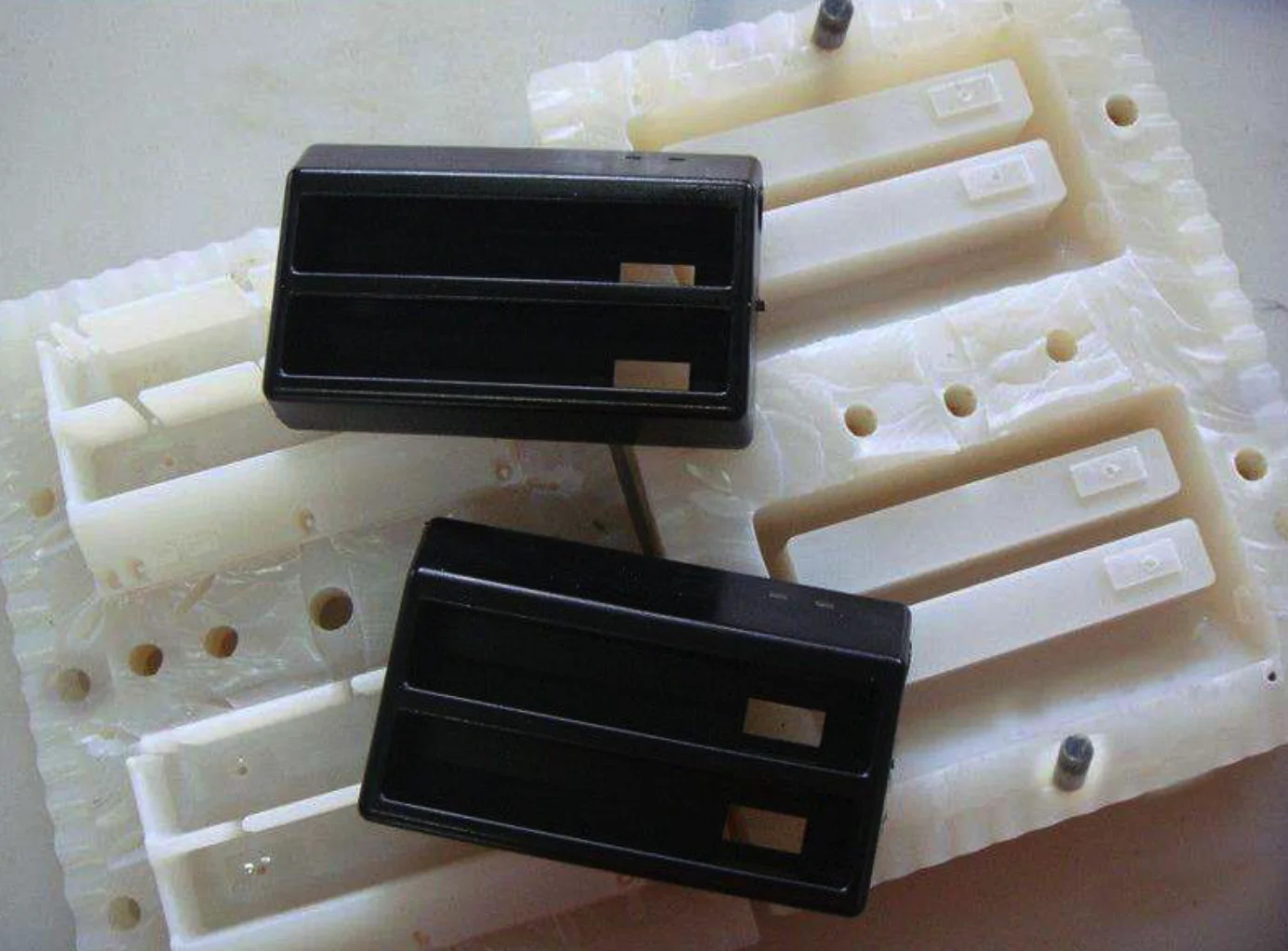

Thermoset PU is mainly used to make prototypes, via a process called urethane casting or room temperature vulcanization (RTV). Urethane casting uses a master part that is covered by a liquid silicon elastomeric material that will harden at room temperature. Once the silicon has hardened, the master is removed, and the result is a soft, flexible mold that can produce copies of the master.
Parts made from this process can range between 30A-85D. With the urethane casting process, flash is unavoidable. Normally, if the part is a hard plastic, the flash can be be trimmed manually, and the scar can be sanded, so it is less apparent. But when the part is as soft as PU, the flash can’t be removed as easily. PU has better abrasive resistance than thermoplastic elastomer (TPE) and polyvinyl chloride (PVC), so it can be used to make casters and shoe soles.
