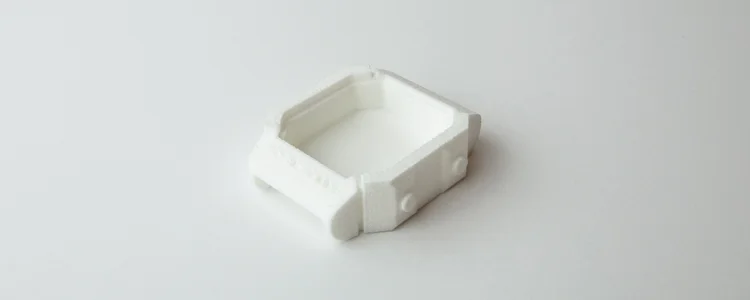

PLA
Technology: FDM
Cost: $
Pros: Cheap, rigid, and non-toxic
Cons: Low resolution
Great for: Testing initial form

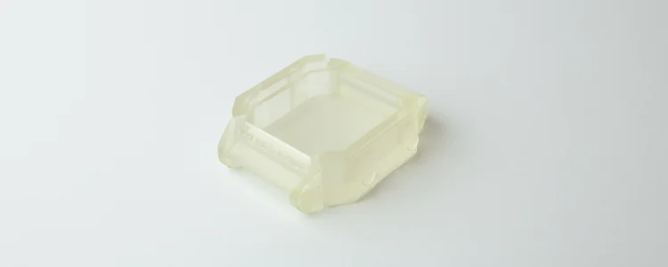

VisiClear
Technology: SLA
Cost: $$$
Pros: Uses a wax support system, so really easy to melt away support material for accurate geometries
Cons: Counter to its name, it’s not actually very clear / transparent
Great for: Strong and accurate parts; Parts that have complex internal geometries

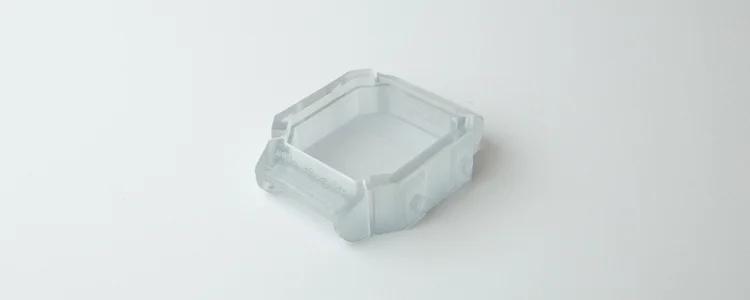

VeroClear
Technology: Polyjet
Cost: $$
Pros: Relatively clear and not too expensive
Cons: Still not 100% transparent (somewhat foggy); If you need a completely transparent material, contact us at info@fictiv.com.
Great for: Most enclosures and light pipes (check out this post to see how VeroClear works for light pipes)

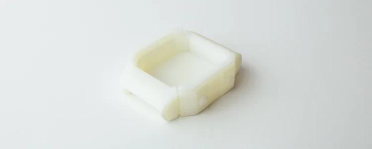

Rubber-Like
Technology: Polyjet
Cost: $$$
Pros: Flexible
Cons: Not stretchy
Great for: Functional prototypes that need a rubbery material in the overmold

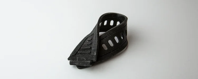

Nylon
Technology: SLS
Cost: $$
Pros: Strong and durable
Cons: Not a smooth finish; Has more of a fine-grit sandpaper feel
Great for: Functional parts, fixtures, and high strength-to-weight parts.

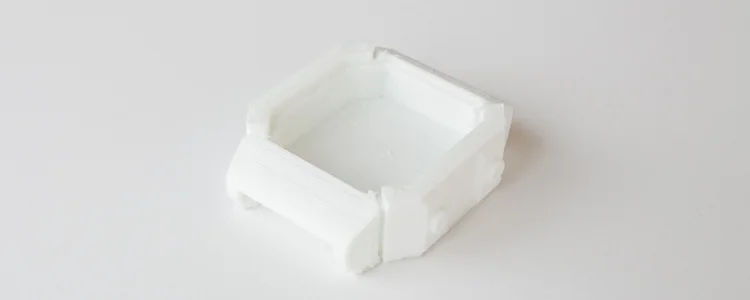

ABS
Technology: FDM
Cost: $
Pros: Low cost like PLA but with a slightly higher resolution
Cons: Still prints with a fairly low-resolution finsh, so not great for visual models
Great for: More complex early-stage prototypes that need to be low in cost
