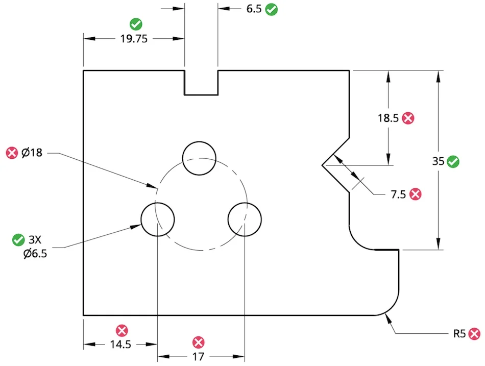

Tip #1: Dimension Only Critical and Measurable Features
In CNC machining, all dimensions can be derived from the 3D model. Therefore, you need only specify where threads are needed and dimensions for critical inspection on a 2D drawing. If you only have threaded holes to call out, you can skip the drawing and use Fictiv’s Auto Thread Detection tool.

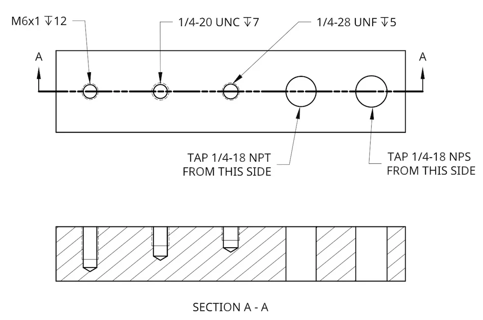

Tip #2: Communicate Hole Tapping Needs for Threaded Fasteners
Surprisingly, tapped hole specifications for future threaded fastener installation can be complex. So, make sure you’re utilizing the correct thread size and shape callout per the type of thread pattern you desire (i.e., ACME, UNC, UNF, or MJ). It’s also advisable to utilize a known thread specification for best results.
Pro-Tip: For more information on how to specify threaded holes on an engineering drawing, check out: Methods for Manufacturing and Calling Out Threaded Holes.
Tip #3: Consolidate Call-Outs When Multiples of the Same Feature Exist in a View
For features that repeat throughout your part, dimension only one instance of the feature and label the dimension as “#X DIM”, meaning that the feature exists in that view X number of times. For example, “4X 10-32 TAP” implies that in the view, there are four 10-32 threaded holes.
This is a widely utilized callout, so manufacturers will recognize it quickly. Just be careful when utilizing the same method for similarly sized features like radii or holes, as one could become easily confused with another. So, say you have 8 holes visible in one drawing view and 4 of them are 0.50” in diameter, while the other 4 are 0.55” in diameter. It may be difficult for the manufacturer to discern this difference between the two sizes.

Tip #7: Don’t Over-Dimension or Over-Tolerance Your Designs
Typically, only a few features on a part are critical to its function, so you want the machinist to pay extra attention to these features. When you over-dimension, the critical requirements are lost in the noise, so assign only tolerances to mission-critical features. Also, over-dimensioning will drive up the cost of the prototype.
