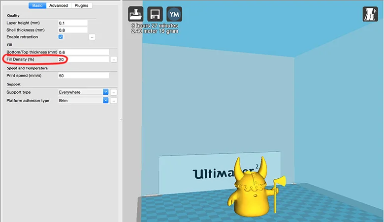

Another element that will guarantee better structural integrity is your 3D printing material density. In the software of every FDM printer, there is usually a Fill Density option; the software for these printers automatically knows to print a pattern of filament inside your model.

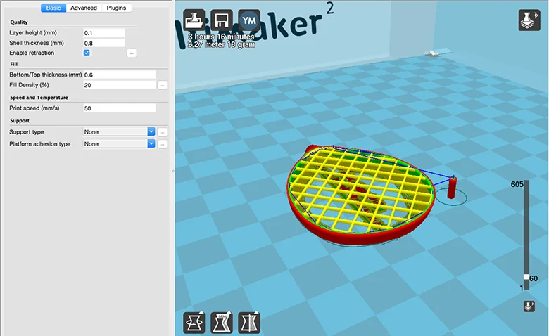

At the default setting of 20%, your Fill Density will fill up your model with a nice light amount of filament. This is designed to provide stability while also reducing printing time and material costs. However, if structural integrity is a critical feature of your project, the Fill Density percentage can be increased.

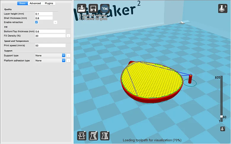

By simply increasing the Fill Density by an extra 10%, you can see the Viking Wacom Penholder will be printed as a much more solid and slightly heavier object:

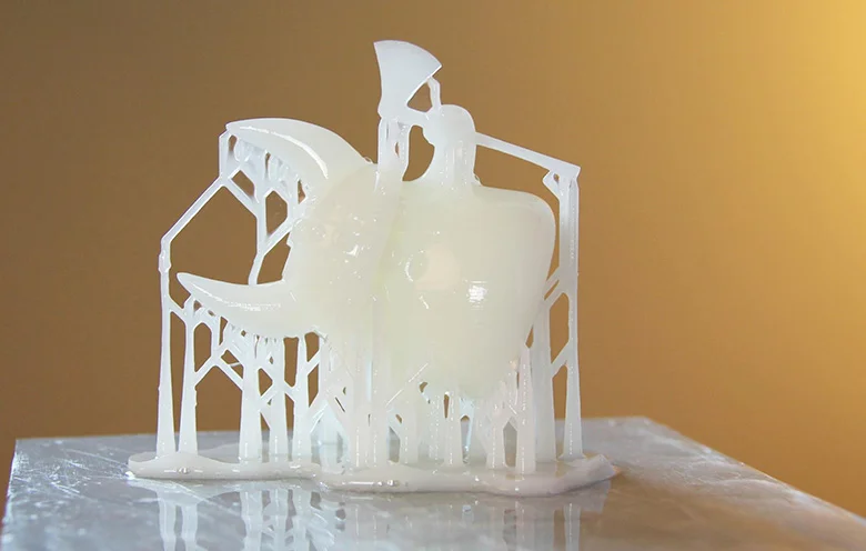

If we jump over to an SLA printer such as the Form 1 +, these printers automatically fill all geometry with resin. Many people “hollow out” their models before printing to save time and material cost, but since we’re looking to increase structural integrity, filling the entire geometry with resin is a great option.
If you do decide to hollow out your model, 3mm minimum wall thickness in VeroWhite is a good place to start. Go from there to determine the best 3D-printing wall thickness for your application.

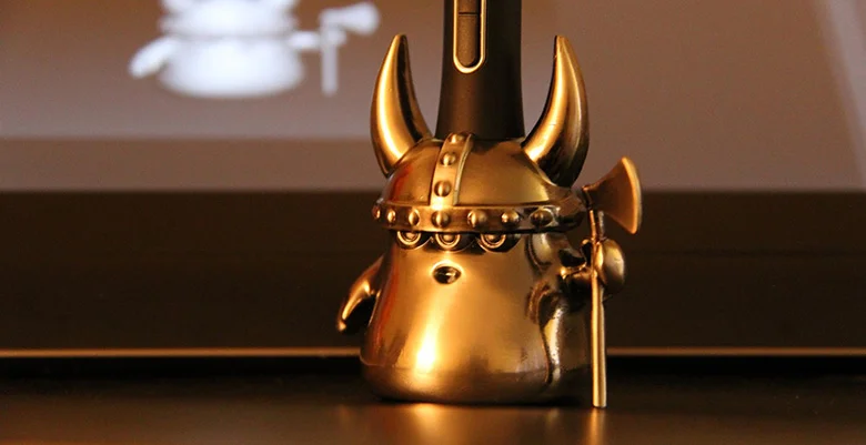

Here’s what the final pen holder design looks like molded and cast out of metal:
