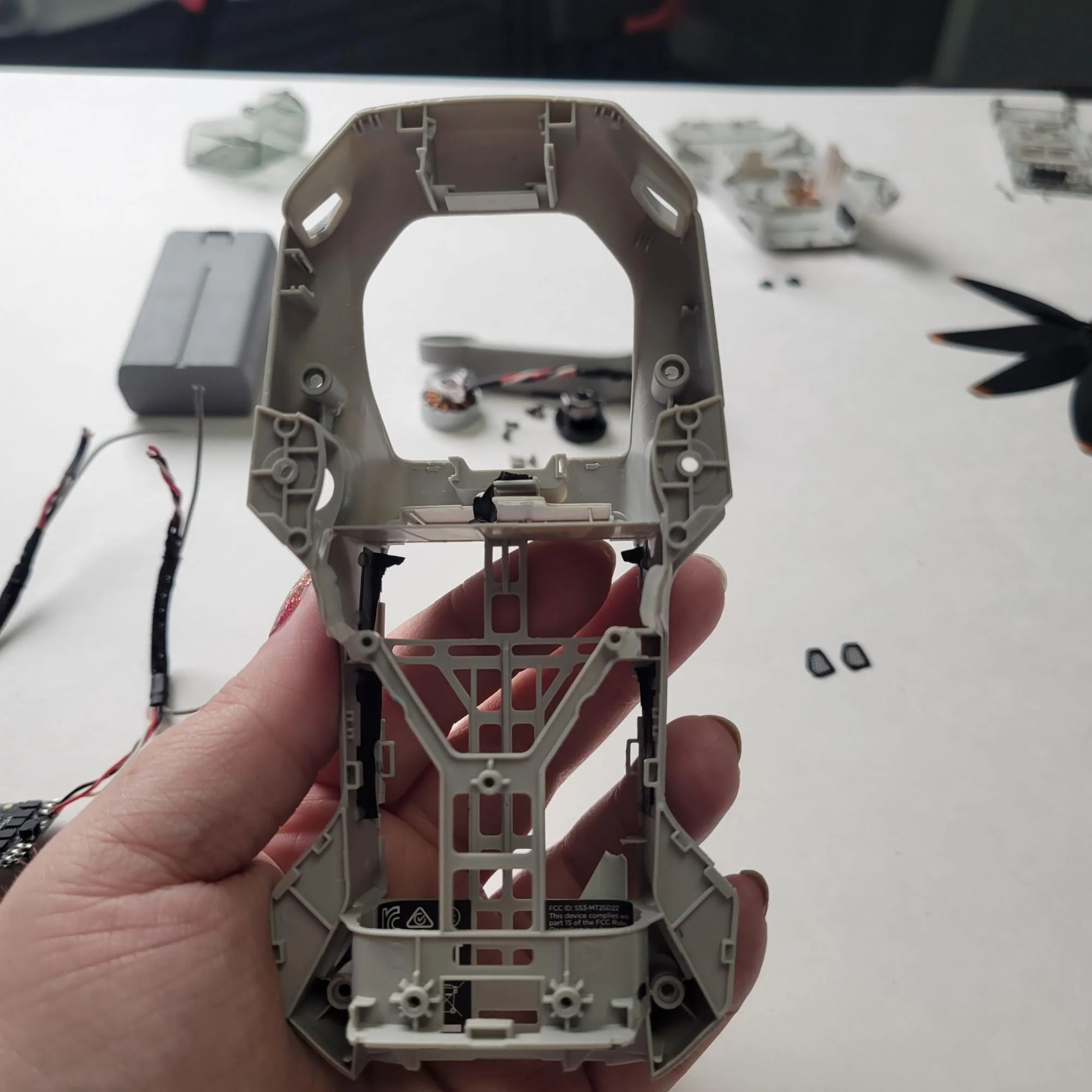

Removal of Top Enclosure
The top enclosure removal is what I did next. It required tons of patience because of all the snap fits within it that I couldn’t see. For the next teardown, I am asking for a CT scan of the assembly first (Am I right?). The top enclosure was attached with several snap-fit locations and screws alongside hinge insert holes for the camera door. It’s a pretty complex and sturdy injection molded part. Here is the top enclosure, which is a single injection molded part.
I also recognized the copper conductive tape near the midsection of the enclosure because it reminded me of my days using copper conductive tape to calibrate a scanning electron microscope. A good blast from the past!
I also want to point out that here is where I started noticing some intuitive and intelligent vibration dampeners throughout the drone assembly, some of which I haven’t seen before. I’m not exactly sure what the materials are, but some had pretty intricate designs that I could tell were specific to this application. Another brownie point for the engineers at DJI.
